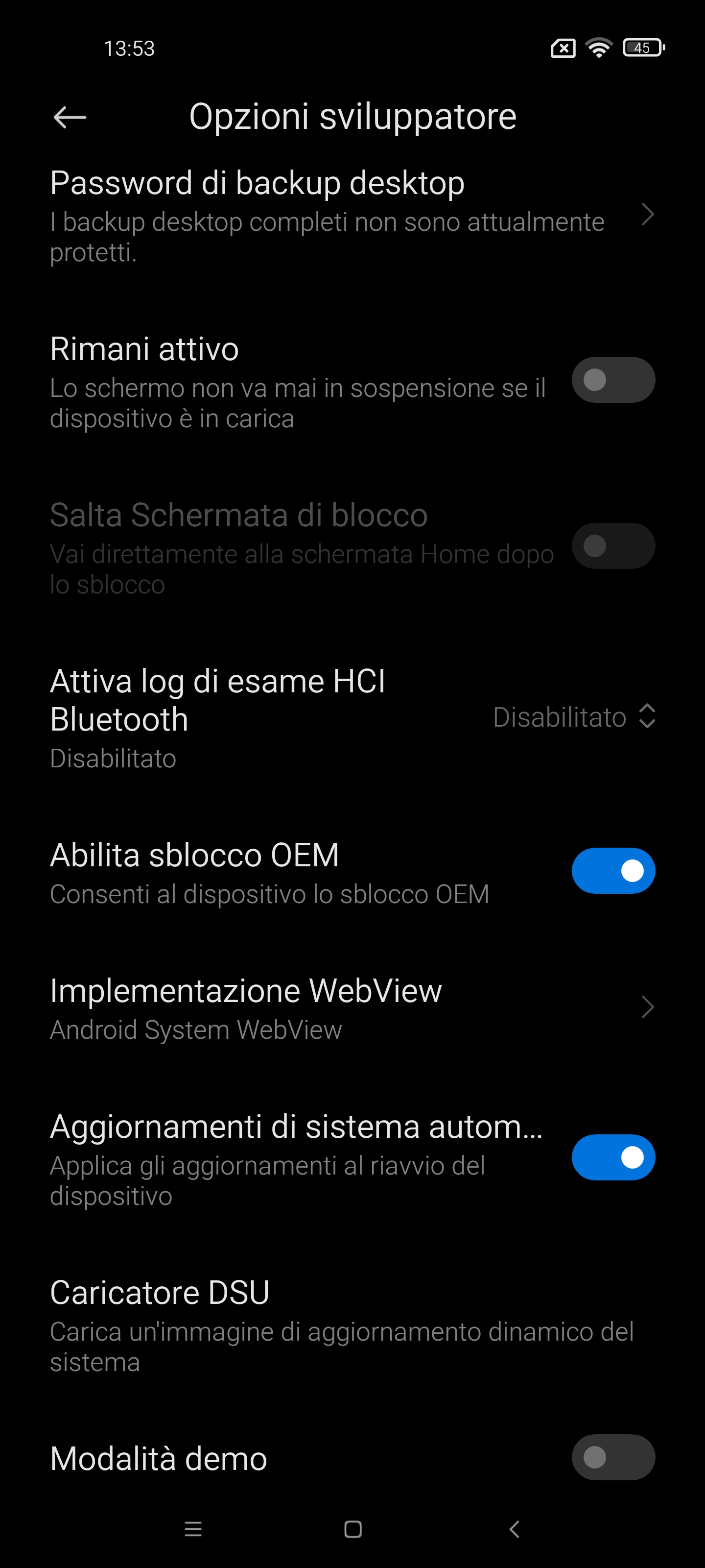

Here's what I mean it looks like the bootloader is locked

Nobody can tell me if the developer options are correct with MIUI 12.5, thanks. Previously, OEM unlock was not selectable, i.e. fixed unlocked

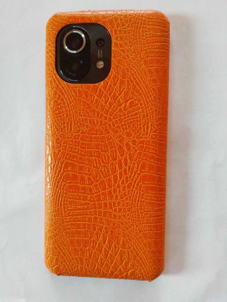

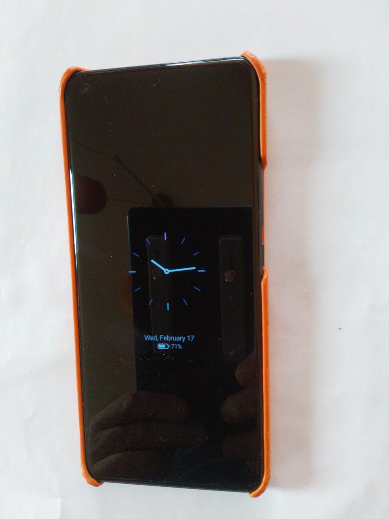

By the way: my new hard faux leather case - looks better than I expected...

On developer options I had the opportunity to see the bootloader status and fixed OEM unlock button, now I don't have the ability to see if the device is unlocked and I can select OEM unlock. Why?
Reactions: 1647838042
