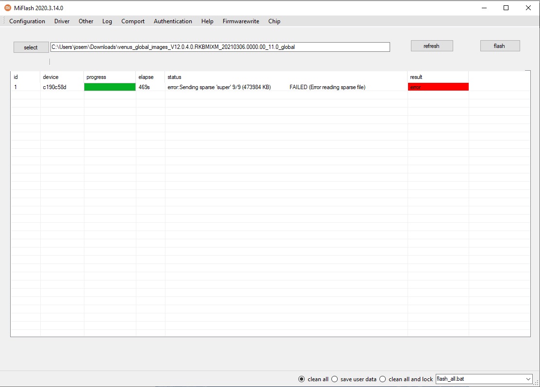

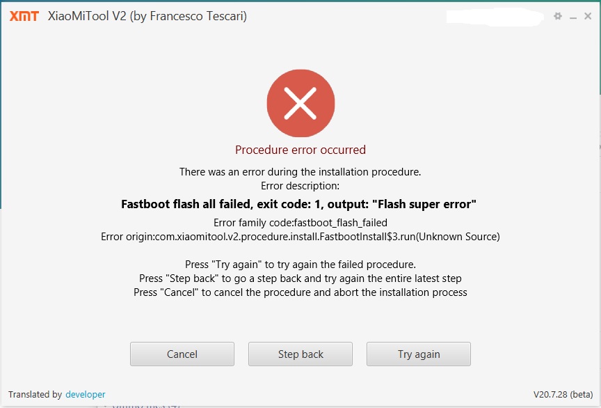

My smartphone is global and was purchased at the Portuguese MISTORE, it already came with the global rom.
I tried everything they say here, but nothing worked and I always go back to fastboot. The error that always gives me is in the "super" flash, as you can see in the attached images. Is it due to having unlocked bootloader and not restarting the password when unlocking?
I'm thinking of sending here to Mistore, will they refuse due to the unlock bootloader? Thank you for any contribution you can make to me.

Good night again.
That could be related to a bad download (did you verify crc?) or bad usb / cable, how often did you try?
Sent from my Mi11

How do I do that?
I stayed here on fastboot after flashing xiaomi.eu_multi_MI11_21.3.11_v12-11-fastboot, because I was in the global. I've been here since MI5, ..., MI9, MI10 and always with miaomi.eu, now on MI 11, with no twrp, I tried this fastboot but never left. I don't know what went wrong and I got the tel. in bootloop on fastboot.
How do I do that?
Creating Userdata seems to be buggy with Windows, I would try to concentrate on that since the flash process itself was working...
Note, “make_f2fs failed: 3221225477
fastboot: error: Cannot generate image for userdata“
This error usually means your Android sdk is not meant for the version you're about to install (to old) so ensure the binary which you are using is the one delivered with the rom.zip.
Also, some people advice to keep the folder name as short as possible.
Fastboot is capable of formatting / erasing particular partitions, so formatting userdata can be done by yourself, just decompile the script and see if you can do the make2fs part manually, this should render the phone working again, flash eu rom once more, maybe on native Linux?
Regards.

I tried it, but mine is still on fastboot.
Still giving the same error: C: \ xiaomi.eu \ platform-tools-windows / make_f2fs failed: 3221225477 fastboot: error: Cannot generate image for userdata.
I don't know what else to do, I'm about to give up.
Someone can explain this to me:
C:\Xiaomi\XiaomiTool2\res\tools>fastboot flash userdata userdata.img
Sending sparse 'userdata' 1/2 (738856 KB) OKAY [ 21.141s]
Writing 'userdata' OKAY [ 0.016s]
Sending sparse 'userdata' 2/2 (181376 KB) OKAY [ 10.280s]
Writing 'userdata' OKAY [ 0.678s]
Finished. Total time: 32.136s
C:\Xiaomi\XiaomiTool2\res\tools>fastboot format userdata
CreateProcess failed: O sistema não conseguiu localizar o ficheiro especificado. (2)
