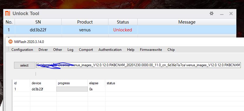

Hello guys, I¨m getting crazy with my MI11 CN version. After i successfully unlocked the bootloader, i procedeed with xiaomi.eu installation. But it remains on Fastboot. I tried XiaomiTool V2, MiFlashPro to put back the chinese version, but without success. After a lot of tries, i got the flash done with success, but the phone it¨s still stuck in fastboot mode. I also read half of this topic and tried all the solutions but without chance. Power and VolUP doesn¨t make anything also.
Can anyone help me with this issue? The phone it¨s still visible on pc in fastboot mode.
LE: I tried for last time, and I forgot to check CleanAll and i locked the phone. /Erase is not allowed in Lock State/
LE2: I was unable to unlock the bootloader, so the hone is unlocked. But stuck in Fastboot Mode. Any ideas? Thanks in advance!

I think the best solution is to flash via EDL Mode because lots of users here with the same problem tried every method and not succeed. IMO, flash via EDL Mode is the last option that you can do.

Yes. My phone same issue. FLASH via EDL works. And now run the latest Miui 12.5

Hi Marcosuper7, i didn-t solve it. I¨m with the phone stuck in fastboot and recocnized by mi flash in fastboot. ... Do you have any ideea about what should i do? Or how can i resolve with edl mode?
First thing: When you are going to perform the procedure through MI Flash, you must first place the file of the version you are going to install in the C folder of the computer Second thing: always select clear all, never the others that can damage your device or even block. Third thing: Perform the refresh by showing your cell phone and click on flash.

put the file inside the C folder, it’s not very good to put it on the desktop
