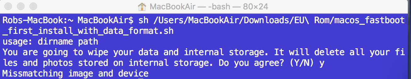

There is an issue with the install script (.sh file) of Xiaomi.eu when the path - where the script is located - includes one (or multiple) space(s).typed sh space and dragged file in, but it says mismatched file and device. View attachment 36281
cd /path/where/script/is
then ./install_script_name.sh
to run the script!cd `dirname $0`
to cd "`dirname -- "$0"`"
Thanks for helping meThere is an issue with the install script (.sh file) of Xiaomi.eu when the path where the script is located includes one (or multiple) space(s).
So you can:
Rename the "EU Rom" folder to "EU_Rom" then try again
-OR-
Edit the first line of the install script (.sh file):
ReplacetoCode:cd `dirname $0`
Code:cd `dirname -- "$0"`
