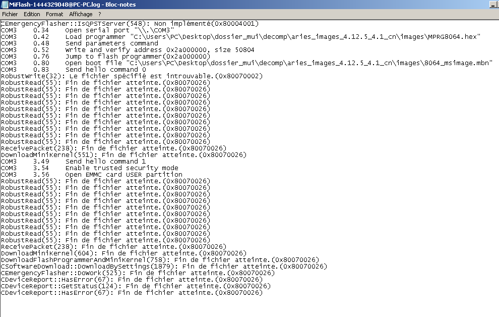

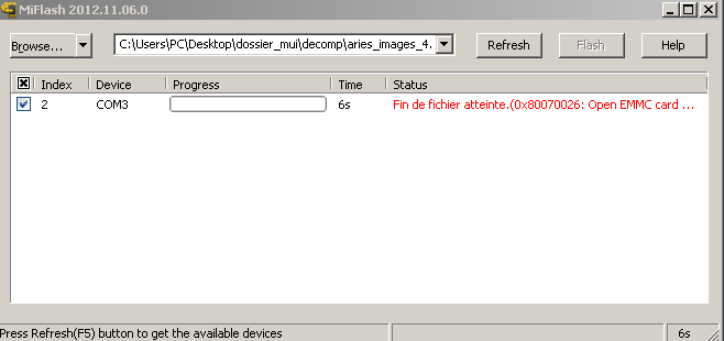

With MiFlash "End of file reached (0X80070026) Open EMMC card user partition"
The report MiFlash
