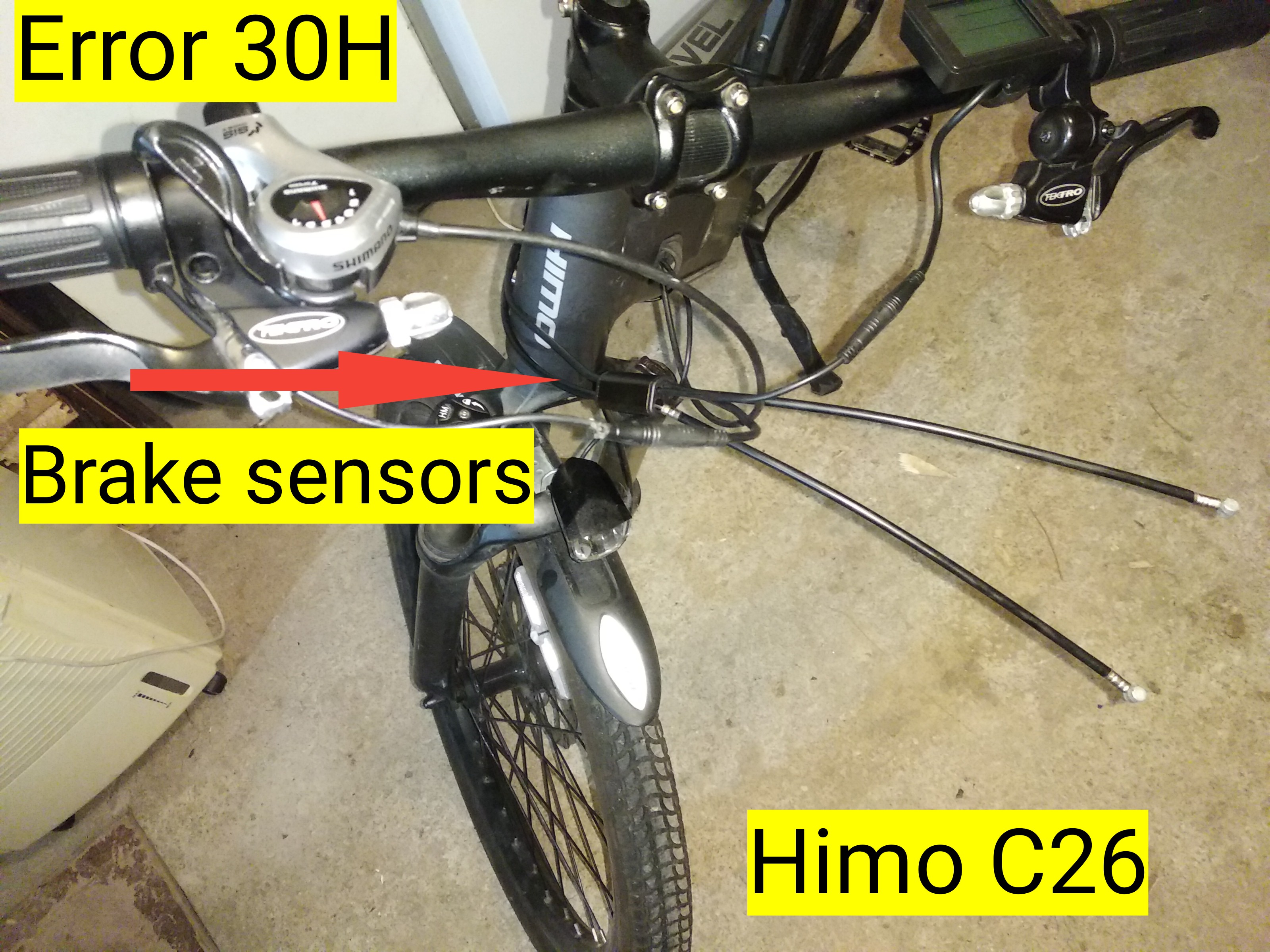

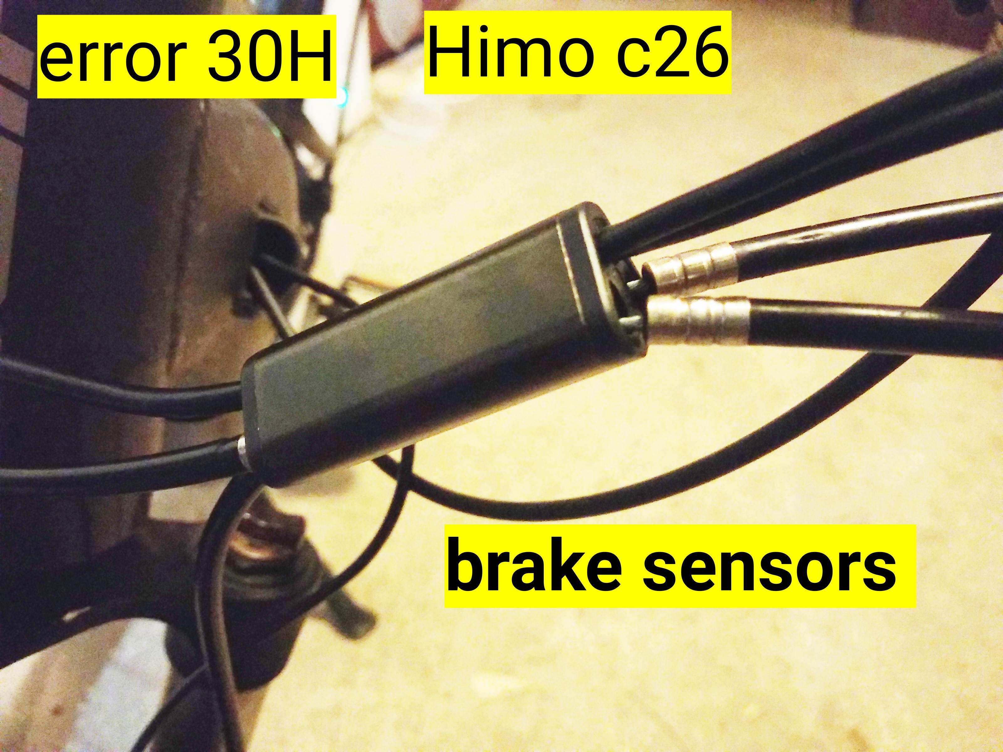

Hi all,
I had a 30H error on my e-bike (Himo c26). The display showed a 30H error, I could not turn on the light, although the display showed that it was on. Also, the electric motor did not work. The battery was 100% full. I disconnected all the cables except for the display and the battery. It was still showing error 30H. I tested with components from another same Himo c26 bike and came to the conclusion that the cable / electronics for brake detection is faulty. The display and speed lever as well as the front and rear brake cables are connected to this cable. Only when I released both brake levers (they were not attached to the brake levers) did the 30H error disappear and the light started working normally.
The electric motor is working. When testing, the 30H error no longer appeared. I did additional testing, turned off the display, braked with the brakes and turned on the display at the same time. It showed me error 25H. When I released the brakes, the error disappeared. Error 25H is therefore caused by the brakes. Error 30H in various simulations no longer appeared. What I also noticed was that the brakes were not working well, otherwise it was very difficult for the brake line to go back, and I lubricated it, now that's fine. Maybe it was a problem with the brake cable that it was showing 30H.
I am adding more pictures.

Hi there,
Thanks for your posts. I've tried disconnecting and cleaning the brakes/cables as you've described, but still showing 30H.

Hello, try blowing or spraying with wd40 or something similar based on oil or petroleum into the holes where the brake wires go through. Water/rain must have gotten into your brake electronics. All the best.
Reactions: mgb77
Ya know what? That's EXACTLY what I did yesterday. After a bit of sand-paper to remove a little rust from the cables, I first applied some oil and then a whack-load of WD40 into those holes. Didn't work initially, but after letting is sit overnight, it seems to have fixed the problem! No more 30H error! Cheers!
Reactions: fumbo

I have two Himo c26 bikes and they are two years old. Both bikes have traveled about 10,000 km in total. At most, we had a problem with the rain a few times, and water went into the brake controller. So far we have solved it with WD40 that we injected into the brake electronics.
We are lucky to have exactly the same bikes so I can test for faults. Because I can exchange devices and electronics with each other.
