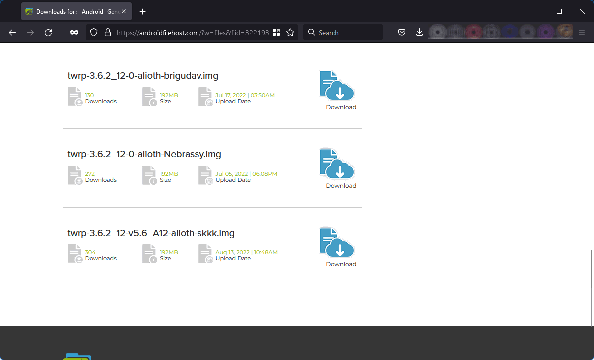

Have anyone tried it? Which twrp have you installed?
