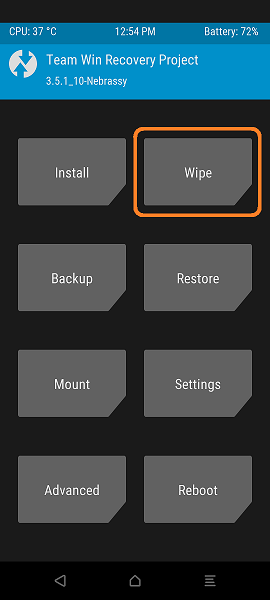

I downloaded the zipped rom into the phone's storage in order to install the stable rom. I saved it in the root in the internal storage. When I start the TWRP tool however, it says my internal storage is 0 and it doesn't seem to detect the data on my phone. What am I doing wrong? The TWRP version I installed (from the given link) appears to be of a higher version than the one in the screenshot. But otherwise, everything seems similar. FYI, I have the weekly installed and want to install the stable one.
Thanks. Unfortunately can't open the image file you linked to in windows, says is corrupted or is not valid. I even downloaded a third-party app (winzip) just in case the native windows app had issues with the image but it didn't help.
Reactions: Poney70 and Enigmow

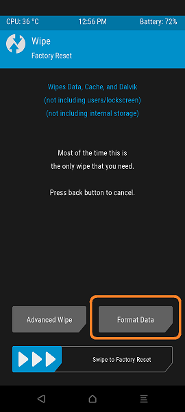

@Enigmow & @Pedrompf1990
OK. Transition from A12 to A11.
Use this TWRP toolkit. https://mega.nz/file/PQgTyQLR#pWN_XKltrsPh7rH_Rh79bR5b941NbzuPYwKV34YJ8Yo
Follow these steps:
- run TWRP
- Format Data
- reboot system
- reboot fastboot
- run TWRP
- insert the ROM into the phone
- install ROM
- Format Data
- reboot system
- Done

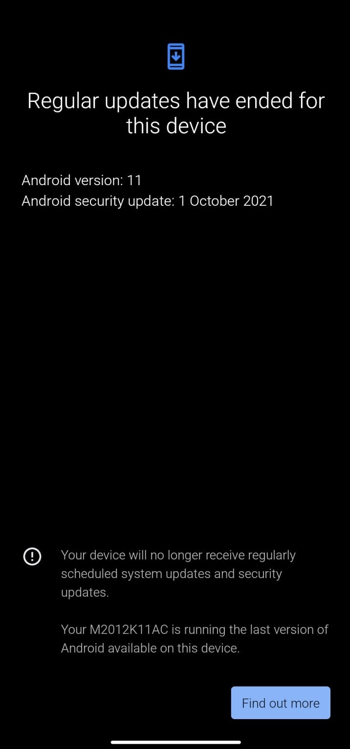

Now that the installation of the xiaomi.eu.rom has been successful on my Poco F3, I was just playing around with the device got what seems to me to be a worrying message and tells me that regular updates have ended for this device.
The other thing is that device identification seems to be wild. Google seems to identify it as Google Pixel 2, Xioami itself identifies as Redmi K40 although it is a Poco F3.

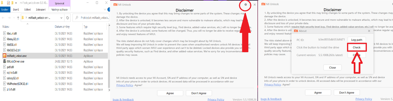

I have a new computer. I installed ADB 15.6 on the PC. I want to update my POCO F3 to 22.1.6 but my computer no longer recognizes the phone. I've tried searching but can't see what I'm doing wrong.
Install drivers:
1) Unzip the downloaded zip file to your PC desktop
2) Put the phone in Fastboot mode (hold down "Volume Down" + "Power" at the same time until you see the "FASTBOOT" screen
3) Run miflash_unlock.exe on your computer (in the 'miflash' folder)
> Go to the "Settings" menu (gear icon)
> Click on Check
> Allow this tool to run as an administrator (if asked ~ may ask twice)
> Now connect (or disconnect / reconnect) the USB cable from the phone to the computer
> Done! You can now run fastboot commands
restart PC + restart phone
