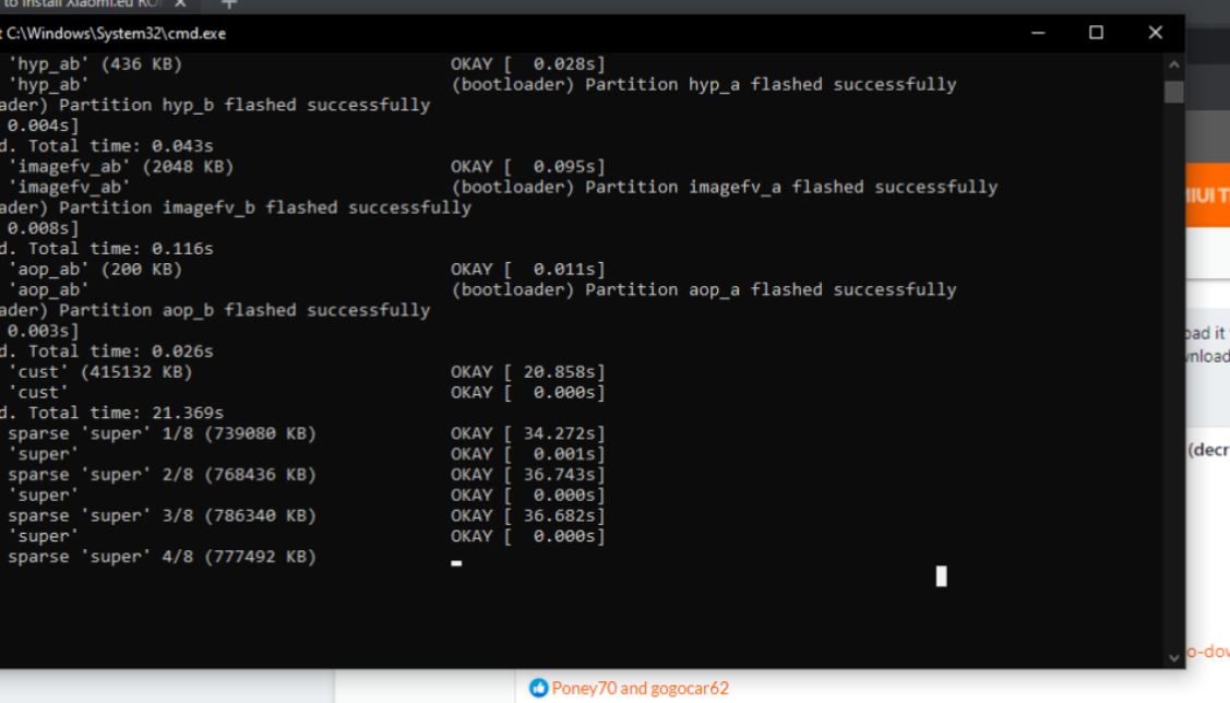

I started to update the rom but fastboot stopped. Already 20min like that

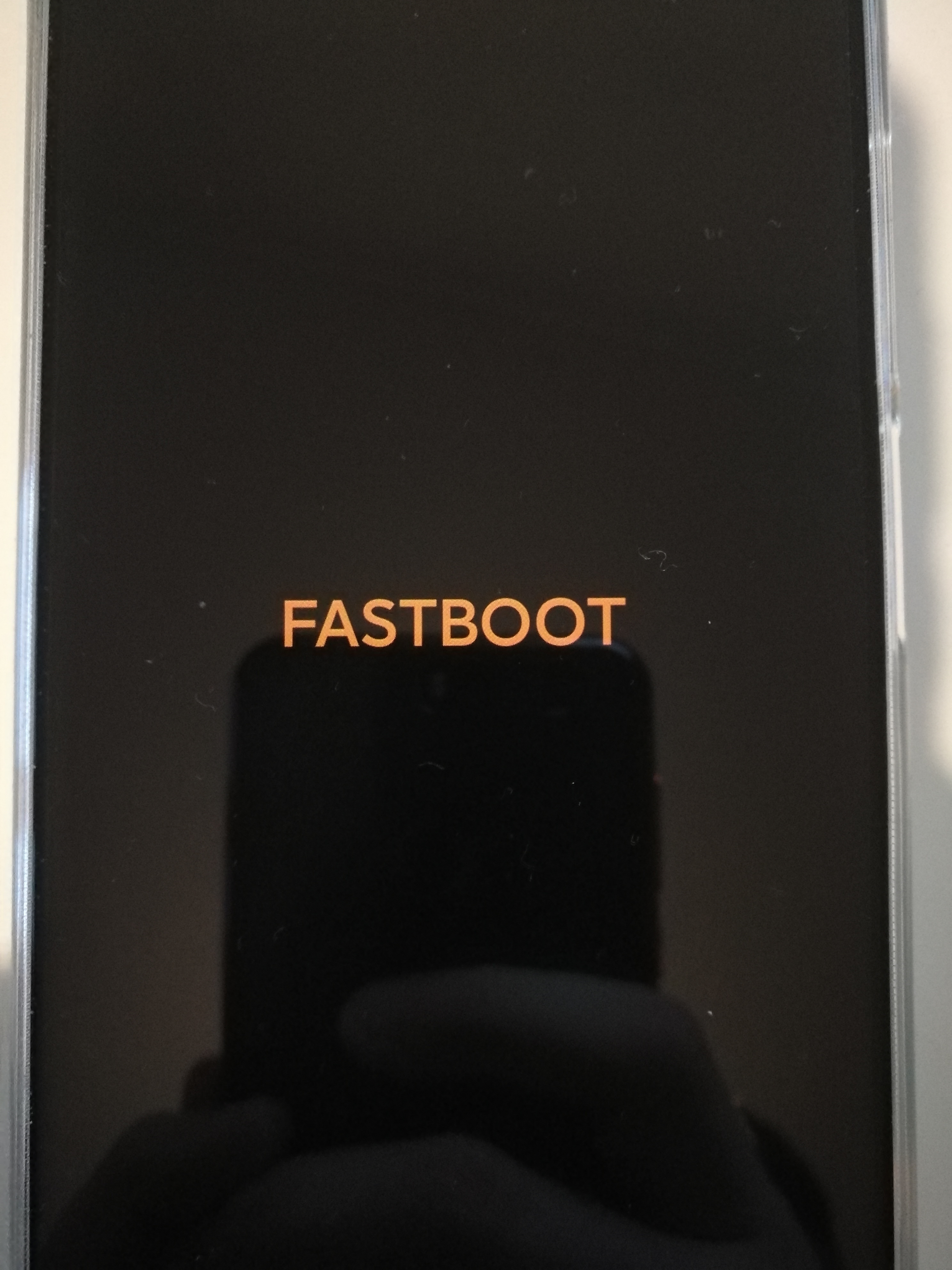

Hi, I downloaded xiaomi.eu xiaomi.eu_multi_HMK40_POCOF3_V13.0.3.0.SKHCNXM_v13-12-fastboot.zip and my phone doesn't reboot after clicking windows_fastboot_first_install_with_data_format.bat. It is still booting to fastboot. In attached files all info from cmd and fastboot logo change to orange. Any way to at least come back to original system?
  • info.txt
unpack ROM with WinRAR and flash it again..
Well, i did that with no effects. Of course I unpacked downloaded zip file and run windows_fastboot_first_install_with_data_format.bat with the final result as the same as output in my info.txt. Phone won't reboot.
I am retarded or my phone because now it worked...
your log is not full.. check it again and paste here..
