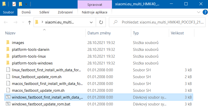

After Running RUN_TWRP.bat , phone reboots into TWRP, i select xiaomi.eu_multi_HMK40_POCOF3_21.10.27_v12-12-fastboot.zip , but nothing happens , it just flashes for a seccond and brings me back to TWRP Main menu, what am i doing wrong?
The ROM with Android 12 is installed in fastboot mode (you have it written in the name of the zip file.).
To use Windows:
-Unpack downloaded zip file in the PC
- Connect to PC via USB cable
- Run fastboot installation script from unpacked zip windows_fastboot_first_install_with_data_format.bat
- wait for the phone to restart the system
- After reboot its done (first boot may take up to 15min)
- if flashing process stuck on setting slot a, just press Enter

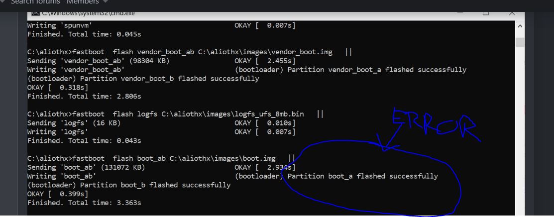

Hi, I run scritp of first installation, I have a error on writting boot. So after 10 minutes I stopped and un-plug smartphone. Now the phone no longer turns on, neither fastboot no recovery. Any advice on how to proceed or do I go directly to assistance?
I had this error too. If you can not boot up or get into fastboot or recovery then you will need to access via EDL making a bridge at the test points (google it). Prob is the glued back cover will probably be broken in the process so I chose to send it to service in warranty.
