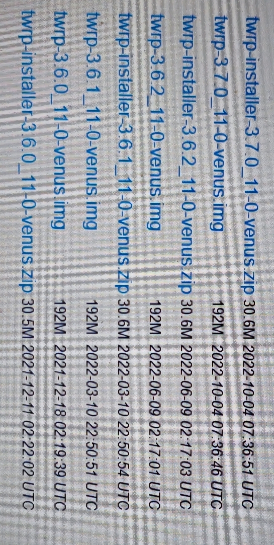

In TWRP I can't mount the data and it doesn't have decrypted files, the rom doesn't appear and the list of folders that appear (empty) appear with other names than the ones that can be seen in any file explorer.

Then use a more recent recovery which is able to decrypt.
And "Installation via TWRP" is the same as "Update via TWRP".
