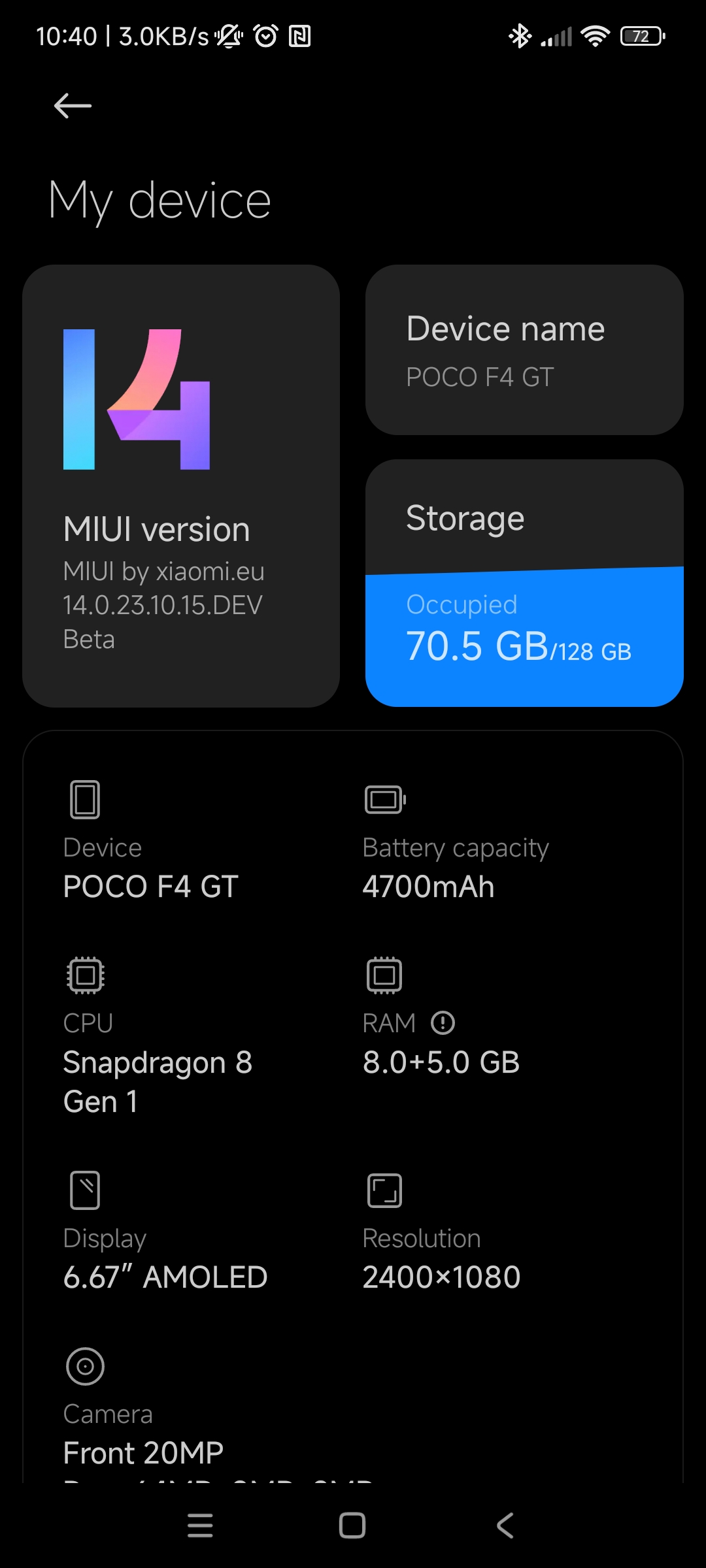

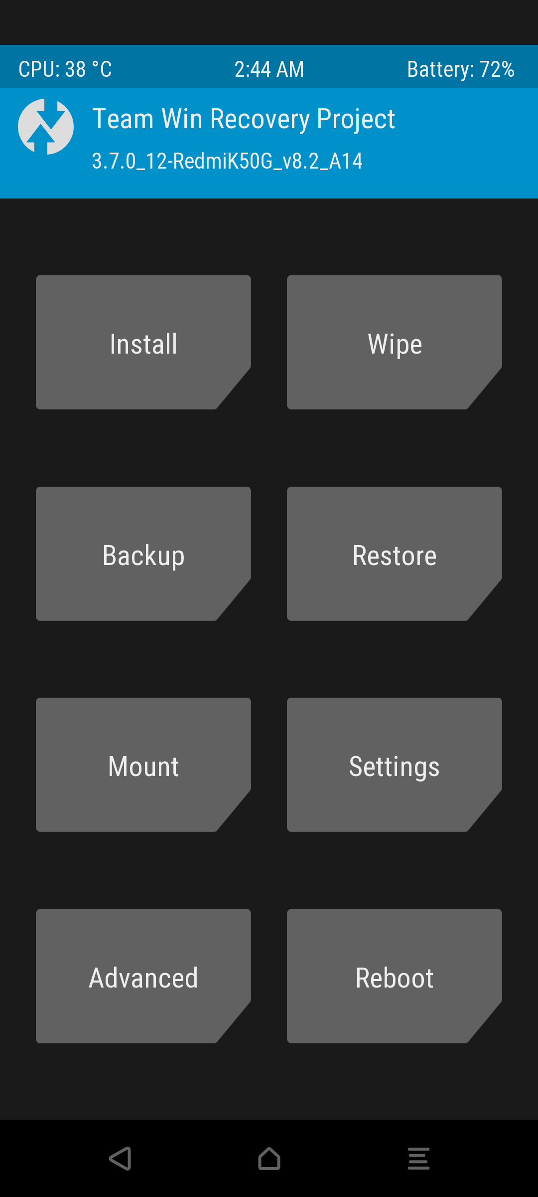

Poco f4 gt any issues? And my question is can i go from miui14 weekly to hyper 1.0 stable with dirty flash via twrp? Added versions of my twrp and weekly

(/advanced/flash current TWRP) then my storage is 0mb and impossible to mount /data (saying that unable to decrypt /data because of invalid argument
What device? twrp 8.* ?
If you have a 14/pro or Ishtar, take some more time to read about the situation.
Remove the fingerprint/face unlock and only use pin or pattern, try it again with a new pin or pattern.
If this still doesn't recognise the encrypted partition, remove all pin/pattern.
If this fails, in twrp wipe--> advanced wipe --> data --> repair (or change) choose to repair filesystem
