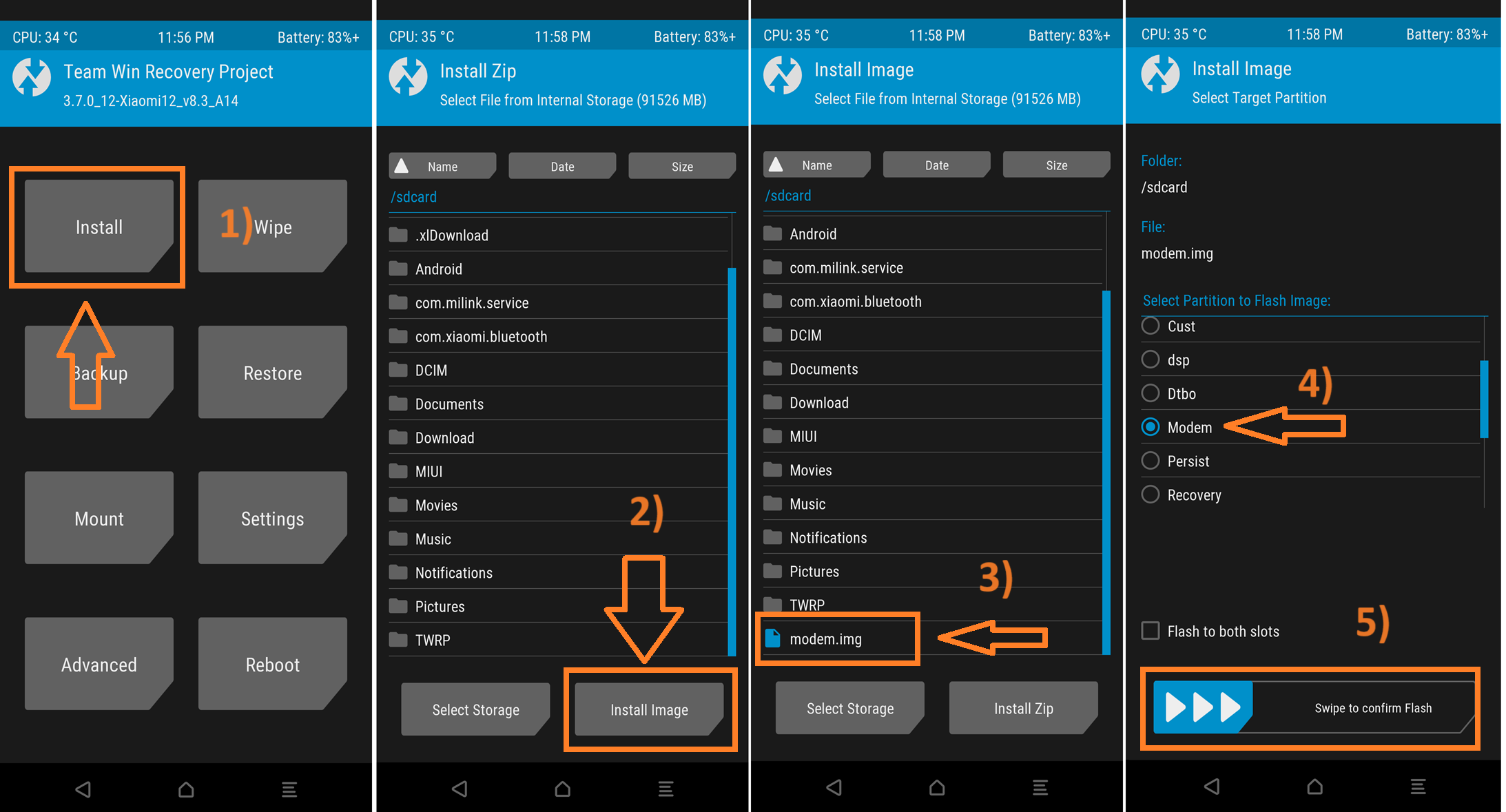

Hi Devs, I need help. I flashed the HyperOs Stable version on a Redmi Note13 Pro 5G (Garnet) Device. Everything went fine, but it seems that the whole cellphone part is missed?! It says "No Service". Thus no mobile data and no cellphone calls possible. Did I miss something? I used the flash batch script with wipe data, because after unlocking data is wiped anyway ... Could somebody help me further...???
If you want to use xiaomi.eu ROM and catch the signal follow the instructions below:
Redmi Note 13 Pro 5G / POCO X6​
- Download this firmware Global > extract the zip. > firmware-update > modem.img > use this file
Install modem.img
fastboot command:
Code:
fastboot flash modem modem.img
fastboot reboot
You can also install the modem in TWRP:

Again, thanks to the Devs to provide the zip.
Question is, if the correct and working modem will be part of ROM updates soon.
Flashing the add. zipfile after each update is a bit off...
It will not happen.
It's only "the correct and working modem" for the Global model of the device.
Like I said in the post gogocar62 linked, "there is no way to guarantee that the firmware from Global ROM will always be compatible with the Chinese ROM".
In fact, the Global firmware is already incompatible with the latest Weekly ROM, it makes the camera unusable.
