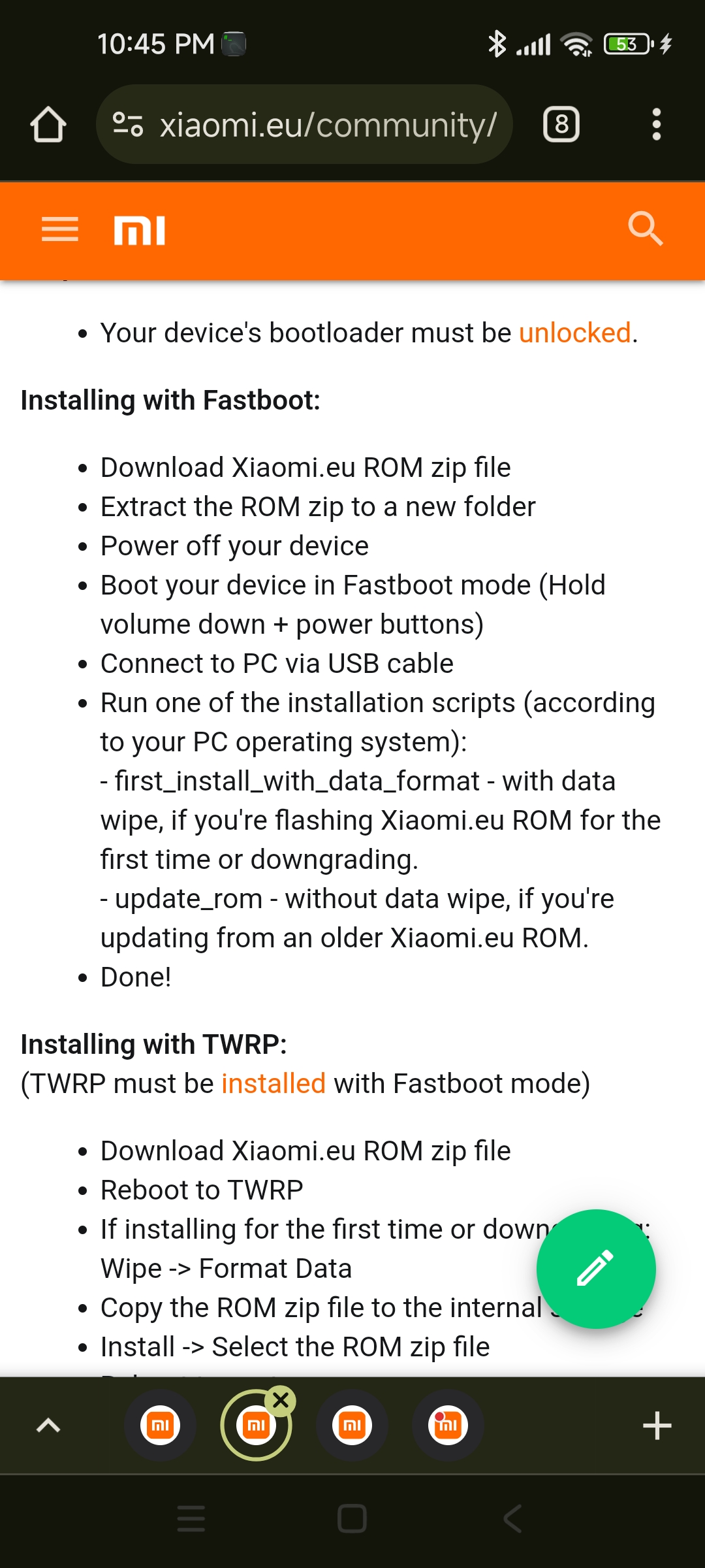

Hi Guys. I have an Xiaomi Mi 11 Venus. A/B. Yesterday i tried the EvolutionX Rom where u have to install Boot Vendor Boot and DTBO file or so. All went good but i do not like the Rom. Has Bugs and Drains Battery fast. So i wanne get Hyperos Rom. What are my Steps. I read that i have to Flash via MiFlashTool a Fastboot Rom. But the MiFlashTool does not Flash. Phone is in Fastboot Mode and Flashtool finds it but it flashes in 5 Seconds..... What am i doing Wrong? Can Someone Guide me?! Tried also Flashing TWRP.img but then i can not Boot and my STorage is 0MB. So i have to Reflash those 3 Files and Evolution X Rom starts up again.

Did you read OP post #1 - there is no word about MiFlashTool.
See the screenshot
However, Xiaomi.eu is custom ROM, not the official Xiaomi (EEA or other) ROM for whom the official instructions say to use MiFlashTool
This forum is dedicated to the custom Xiaomi.eu ROM, hence a wrong place for stock/official ROMs

You Read my Post? I am on the Evolution X Rom and Wanna flash this one. I do not wanna flash anything else. But i wanna know how i revert my Recovery and so on because in the Evolution thread u have to Flash another Recovery to Boot and AB partition and other Stuff. And my Device now has not TWRP anymore. And my Device has an AB Partition. And when i try to flash it like in the First Post it does not Boot up, so thats why i ask here what i can do... I have read that i have to flash a Fastboot Rom first to revert my Recovery for flashing TWRP and then the Hyperos. But it does not work.
Yes, I read your post but you didn't read OP Instructions - there are no word.about using MiFlash
Read and follow OP post #1, F A S T B O O T installation, F I R S T install sctipt
That's it, you don't need TWRP (and maybe there is no TWRP for your device that supports A14 and data encryptiom).
That's why there are sctipts to run directly from Windows or Linux.They will install everything in the Fastboot mode.
Of course, your Bootloader must be unlocked and you must have proper drivers for Fastboot
Again, no MiFlash. Quoting:
Installing with Fastboot:
  • Power off your device
  • Connect to PC via USB cable
    - first_install_with_data_format - with data wipe, if you're flashing Xiaomi.eu ROM for the first time or downgrading.
    - update_rom - without data wipe, if you're updating from an older Xiaomi.eu ROM.
  • Done!
