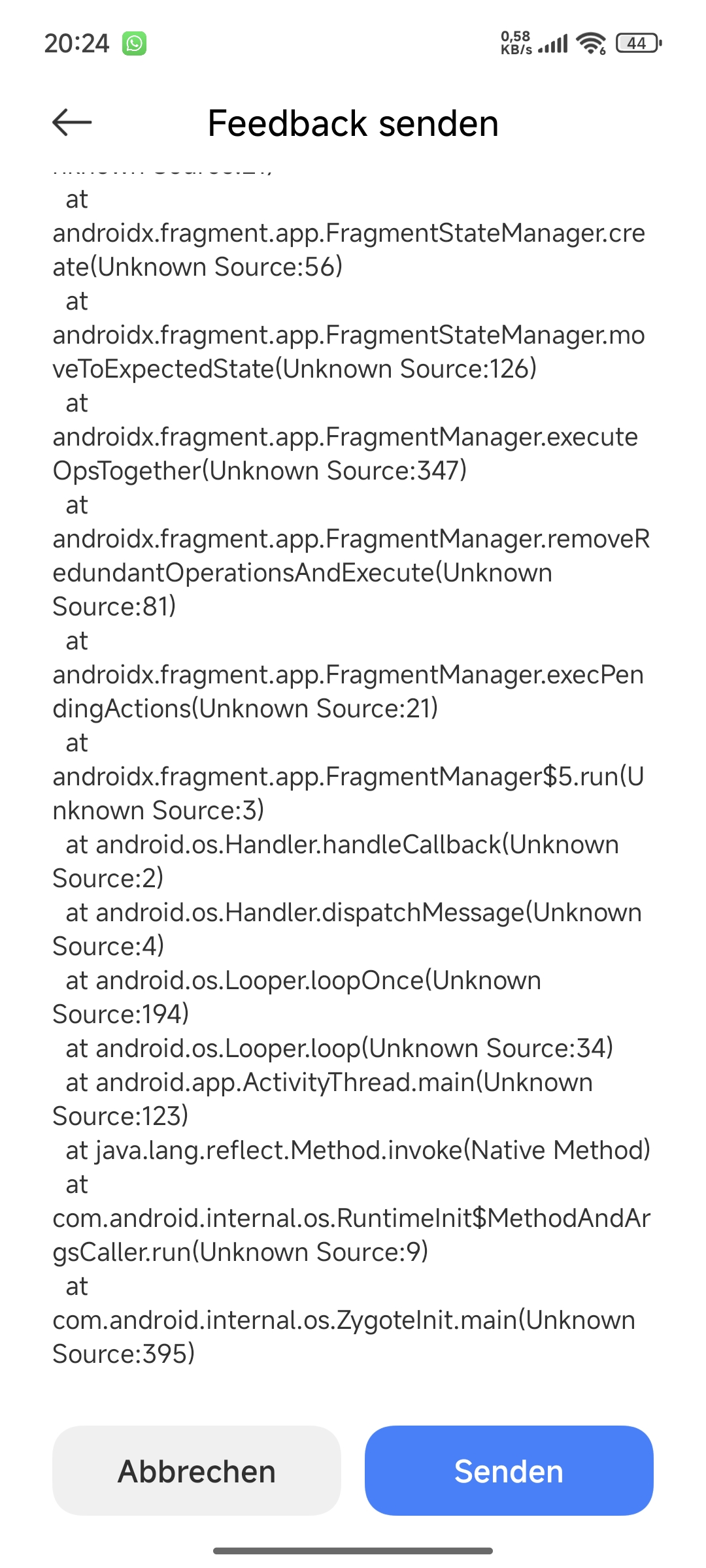

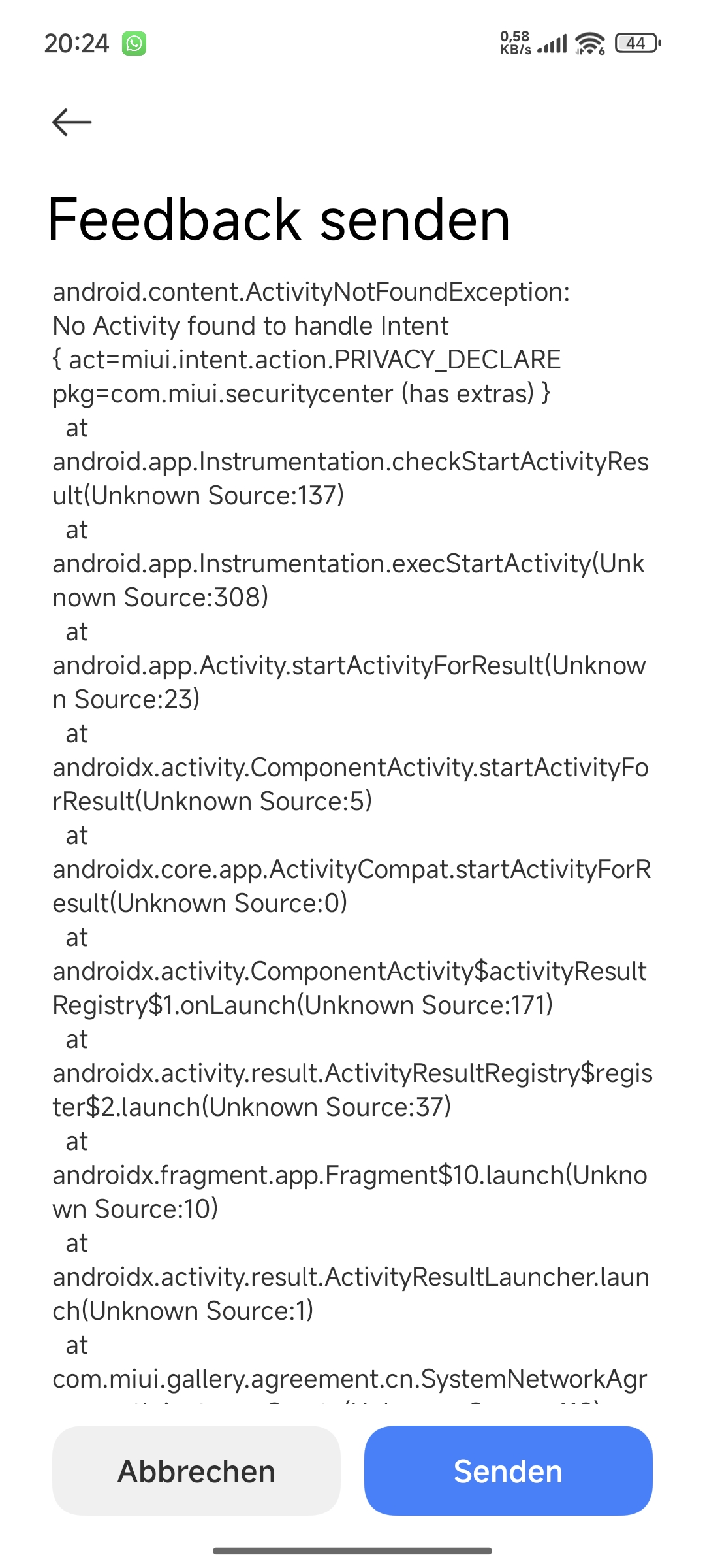

Gallery Editor Crashes everytime
I did the Script with factory reset and Update
If needed i can do log later

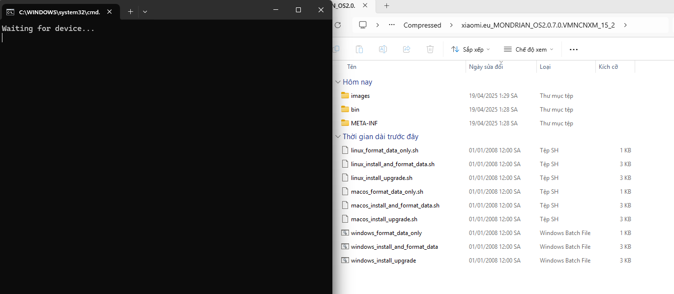

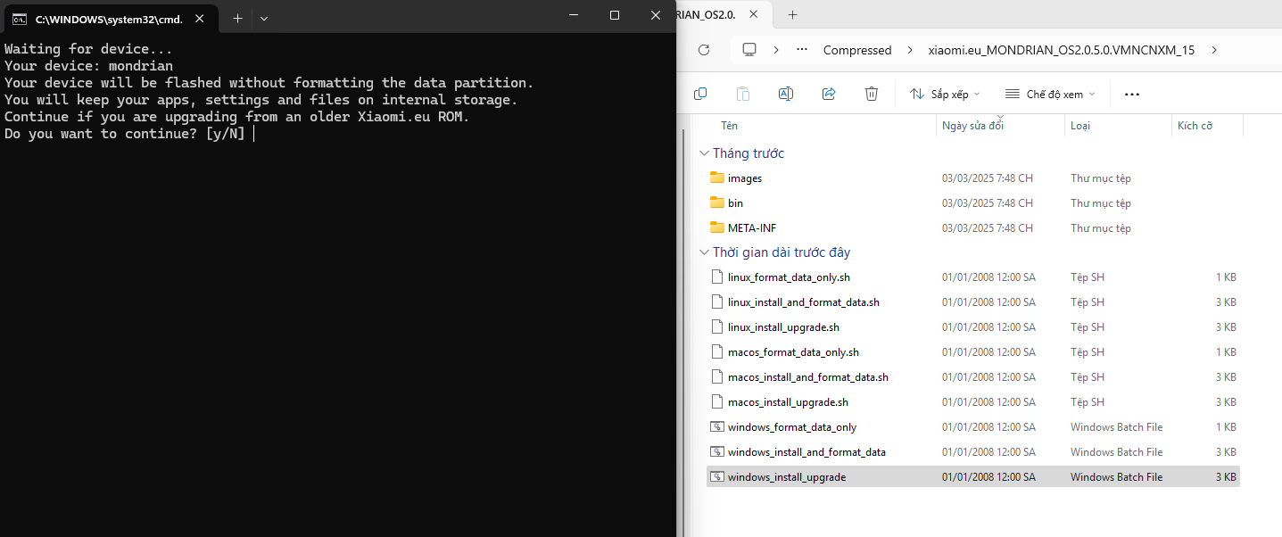

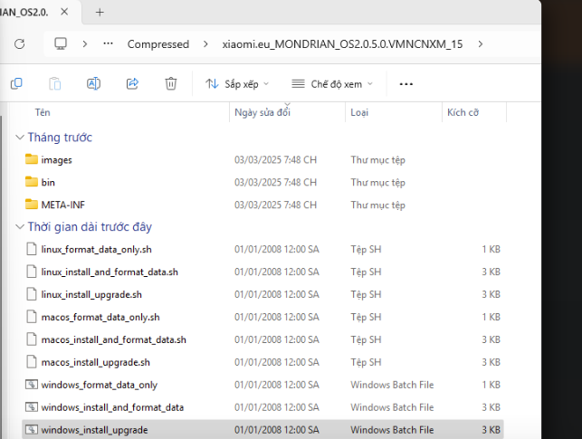

Why can't I run the upgrade file?
While still able to open the old version?
Do you have a good connection between the phone and computer?
One way to check is, in fastboot mode, to enter ...
fastboot devices
If the connection is good, this should bring up a code and 'fastboot'. If it does not bring these up, then the connection is not good and you should not procede.
fastboot devices

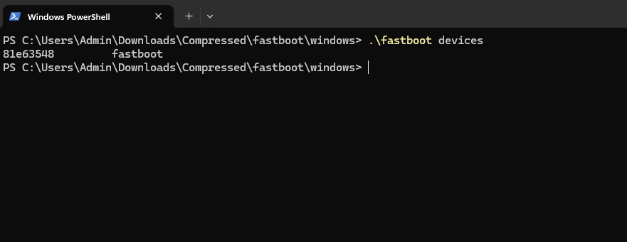

phone and computer are connected. But I still can't upgrade
What is the response when you run the batch file, eg. windows_install_upgrade.bat ?
Edit: You also have to be in the appropriate folder where the batch file is and run it from there.
Also, I have never done it from within Powershell, I always use the Admin Command prompt. I do not know if that makes a difference.

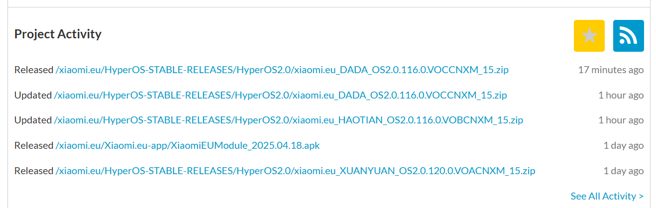

Why many uploaded files for HAOTIAN and DADA? Which changelogs?
Gallery Editor was unusable unless you already confirmed the permissions dialog before.
The multiple reuploads is because SF upload speeds are broken, and uploading at 20KB/s is unrealistic, so we retry until we get decent speed.
EDIT: Finally done.
