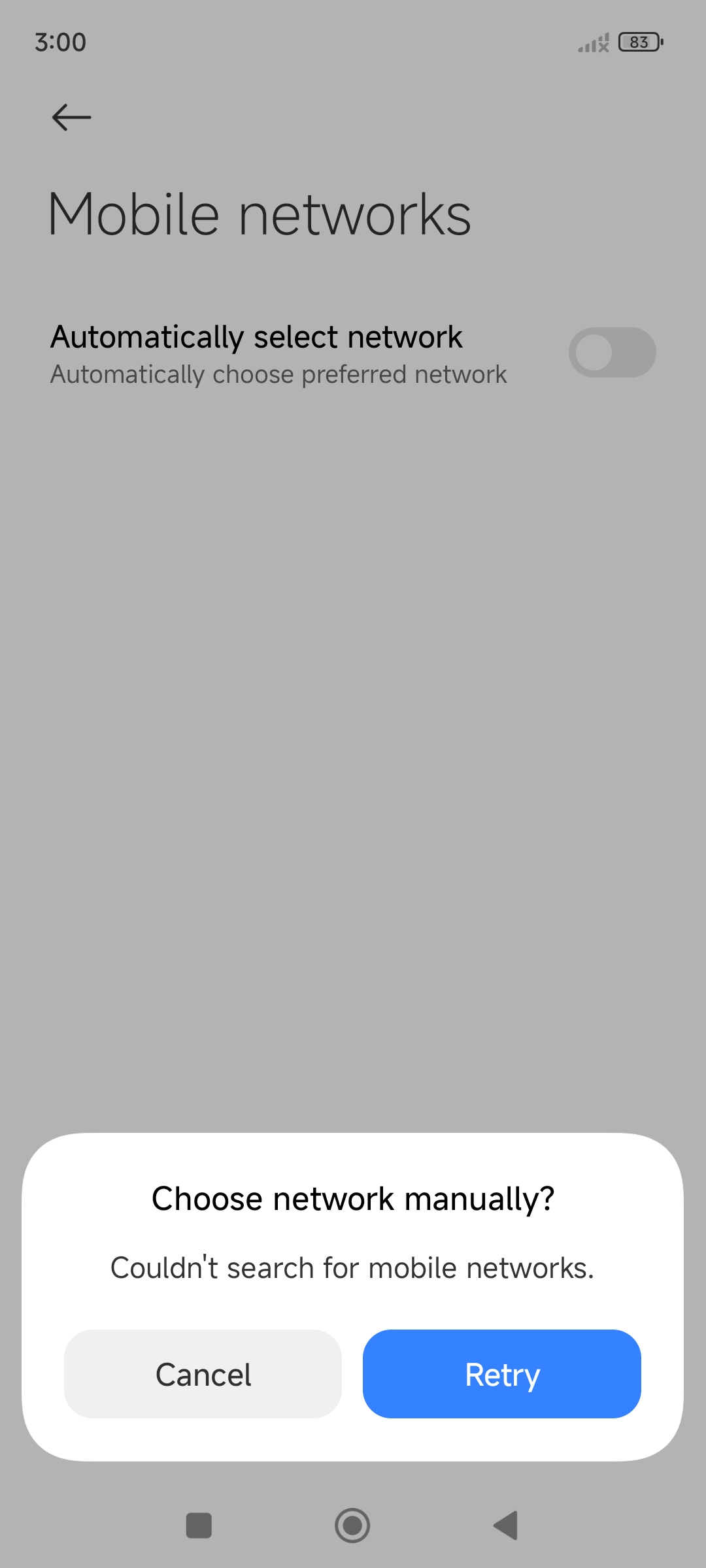

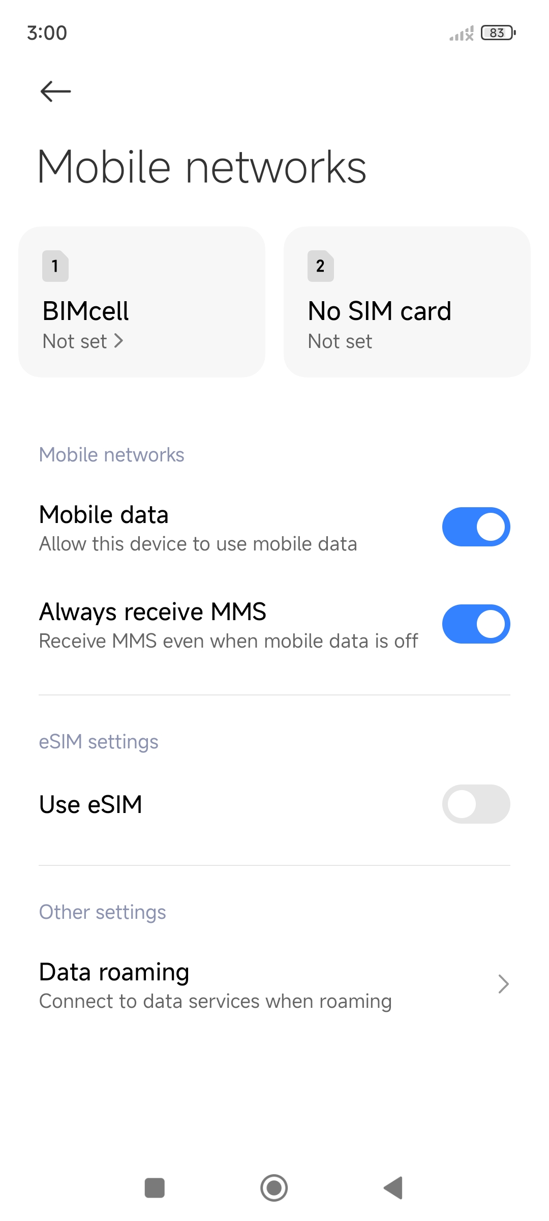

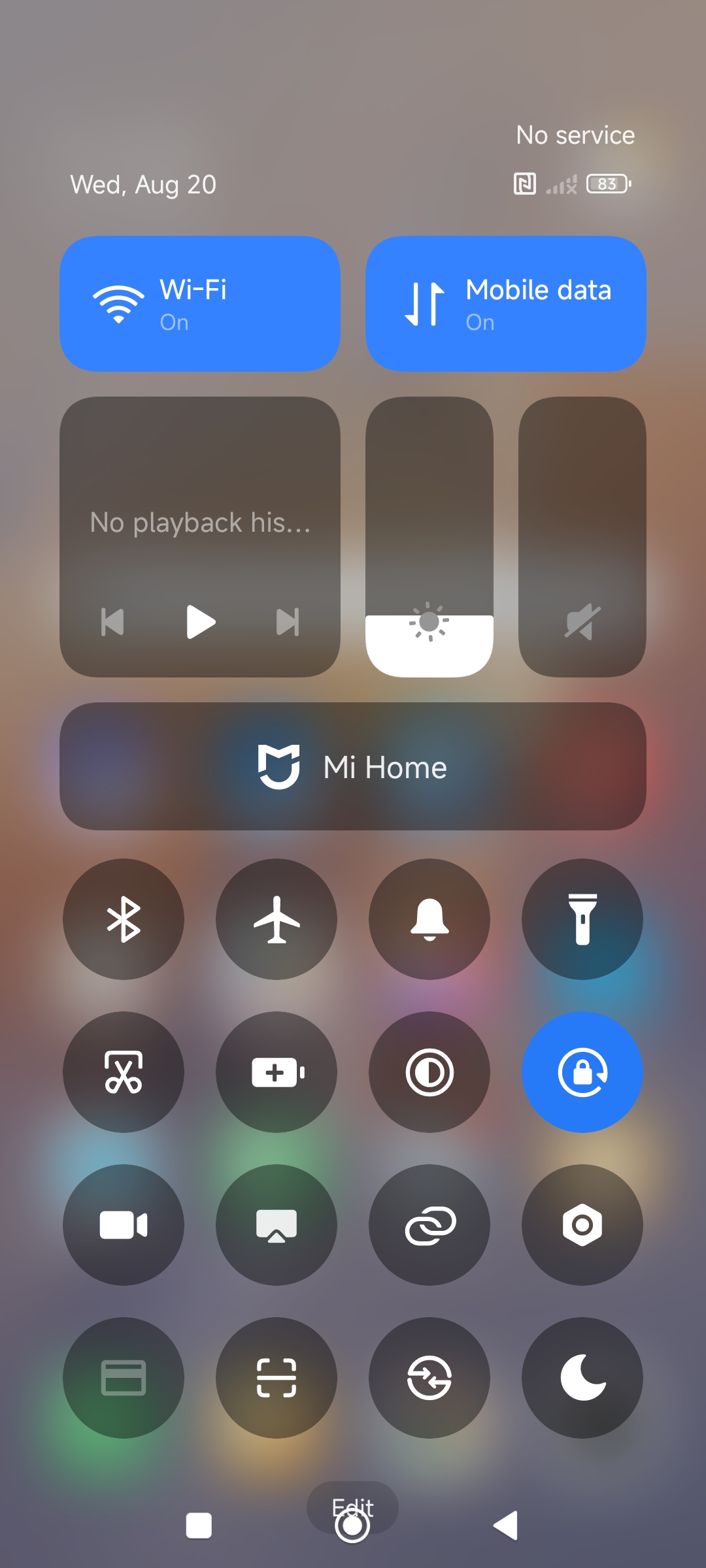

I installed Xiaomi 13 12/256 Global on my resistant device. But the IMEI and serial number were deleted. Currently, there is no network connection :(
That doesn't sound right.
Have you wiped and reloaded the firmware?
You can also flash the modem again.
More details needed here. Was it an upgrade? What firmware and version did you have before?
Describe no network connection more. What is the phone doing?

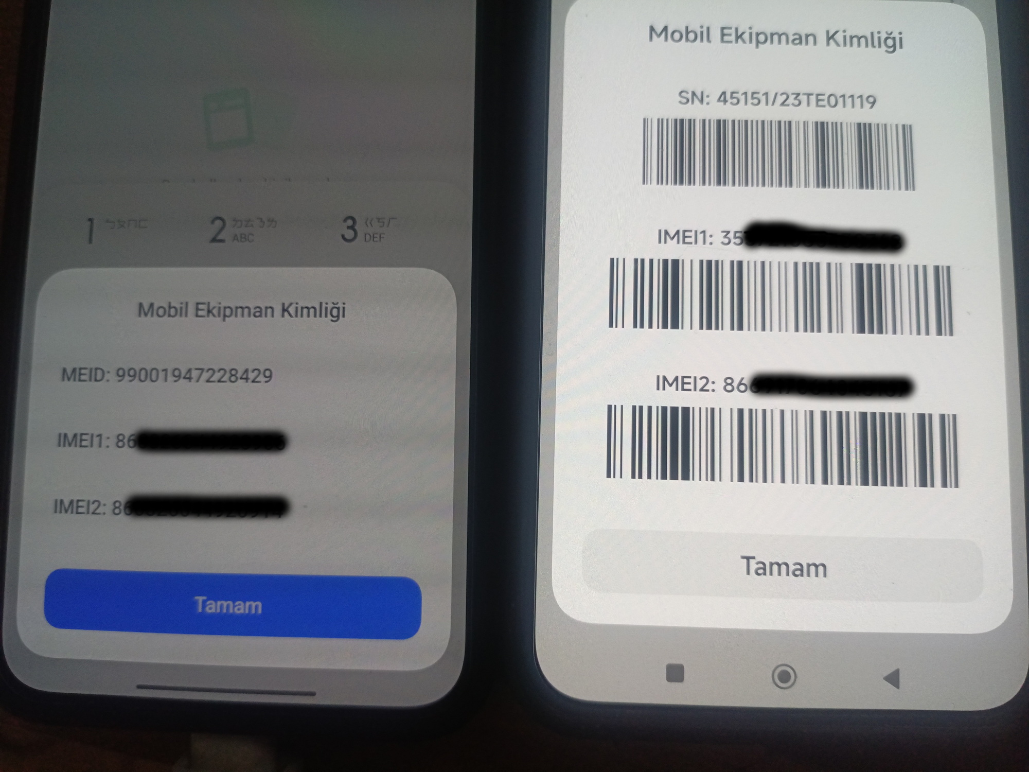

Previously, I had Taiwan ROM OS2.0.103.0.VMCTWXM. I reset it and installed Fuxi Eu ROM. No network. I rewrote the IMEI with the dft pro tool, but there is still no network.
Both devices are the same, but the one on the right works fine while the one on the left does not receive a network signal. The software and model are the same. Is this visual difference due to QCN?
