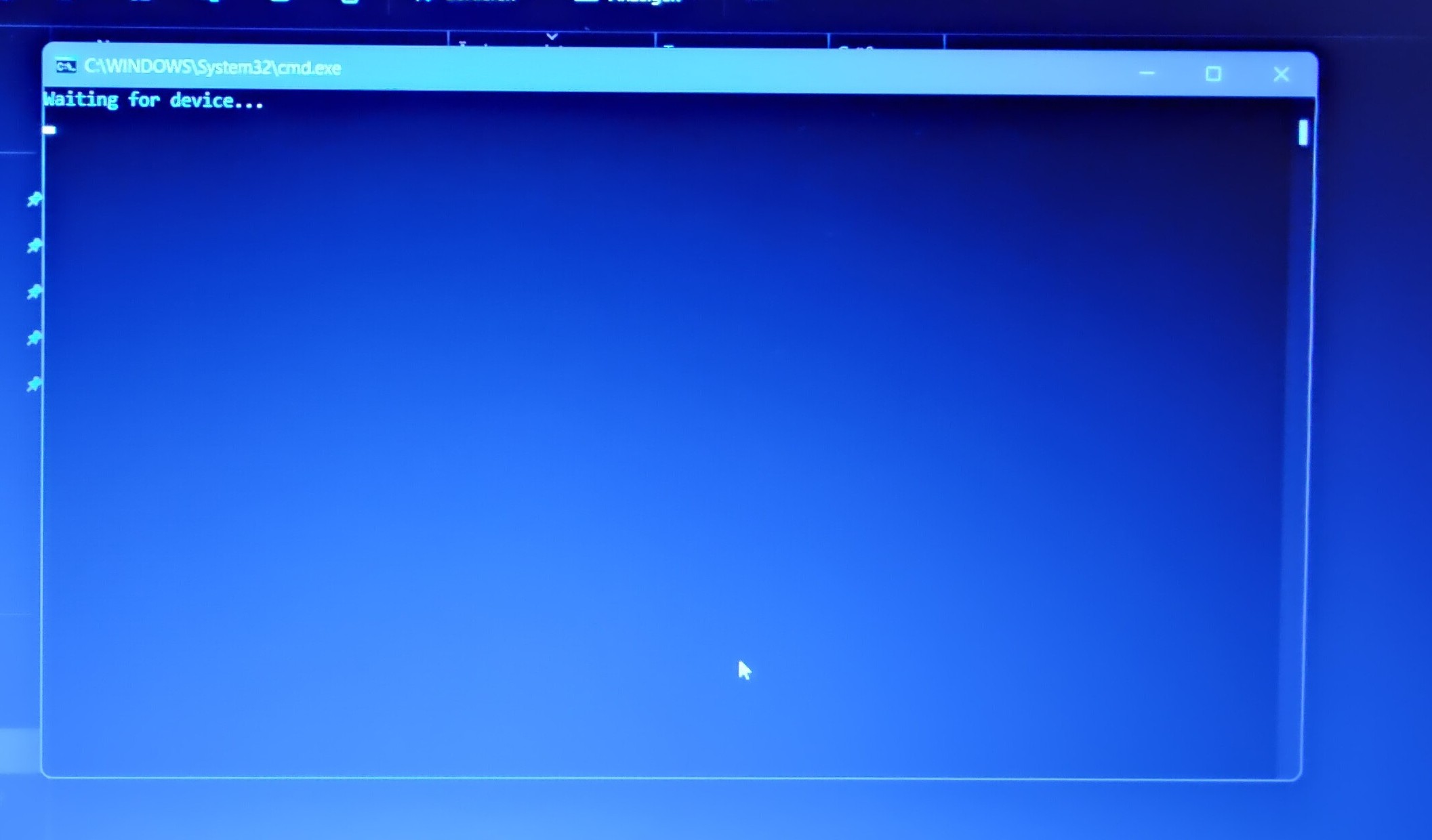

I get this message when I connect my phone to my PC
Same here.
Even though it shows FASTBOOT on screen I dont think its actually in fastboot mode (maybe its overwritten the boot/recovery img) as even just using power button or power button plus Up/Down button it still shows FASTBOOT logo. PC doesnt recognise it but it can recognise my old Mi 9 so its not a driver/adb issue.
I cant even turn it off
If PC cant recognise it not sure there is much chance of recovering a working phone :-(
