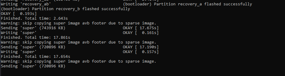

The 2.0.3 update on redwood was unsuccessful. during installation there were errors about the installer not seeing the size of the phone partitions. For example, "Warning: skip copying vendor_boot_ab image avb footer (vendor_boot_ab partition size: 0, vendor_boot_ab image size: 100663296).".
I will try to install 1.15.0, then I will replace images from 2.0.3 in the same installer.
Error while installing rom. Installation stuck for 10 minutes and cannot reboot. XuanYuan Mi 15 Ultra.
Edit: CMD closed unexpectedly, and after running Windows_install_update.bat again, got 10 warnings identycal, and finally rebooted.
Still had to update modem manually after rom update.
