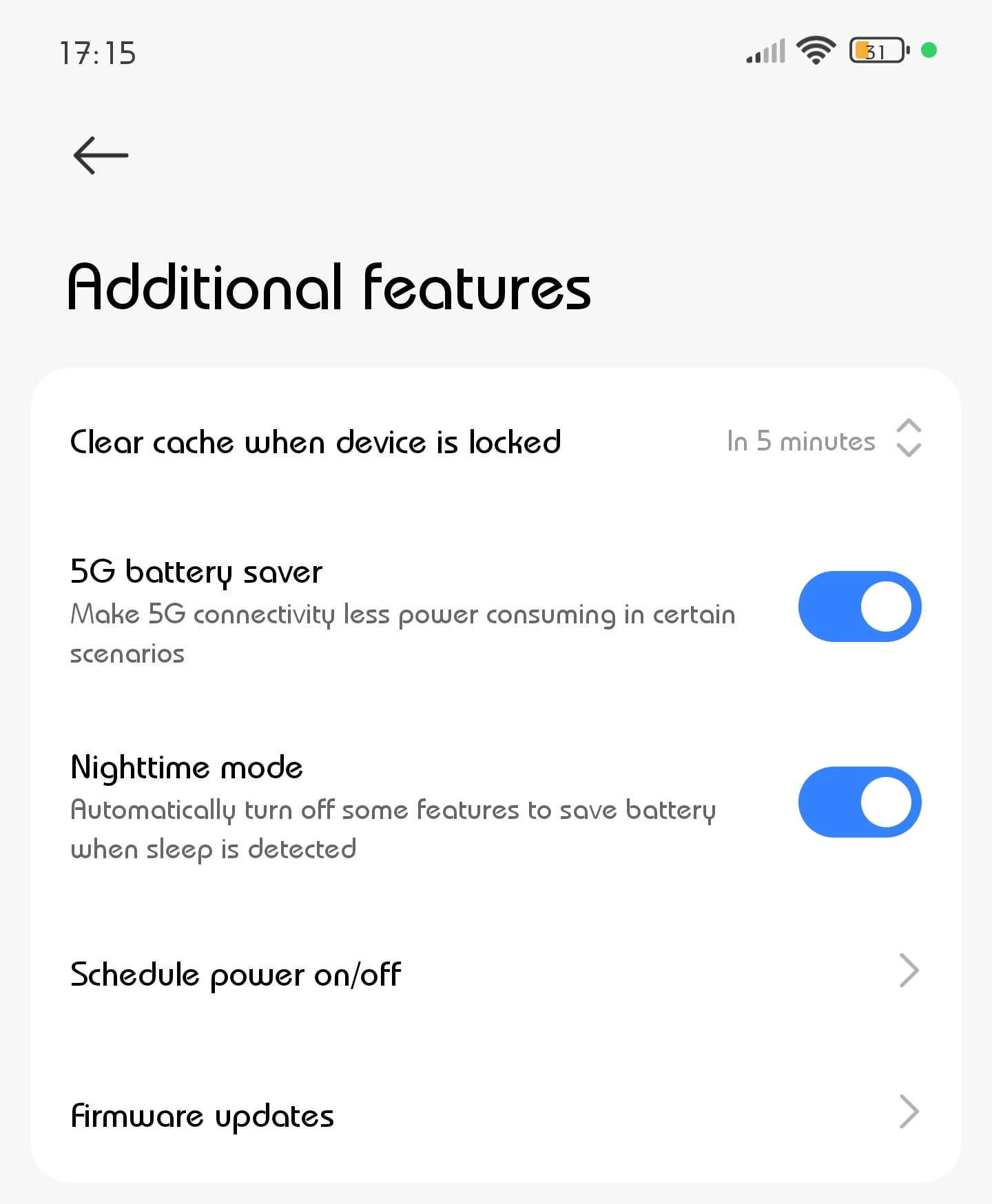

- Settings / Battery / Additional features (img 1);

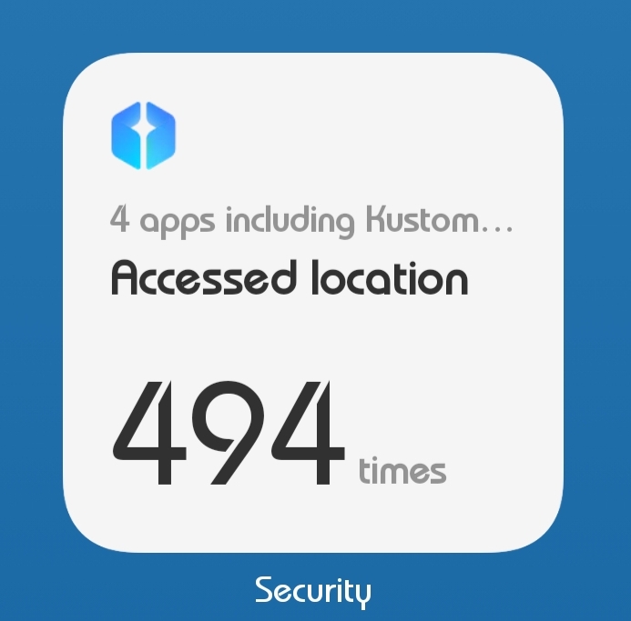

- You can monitor and check this with the 'Security.Privacy' widget (img 2);

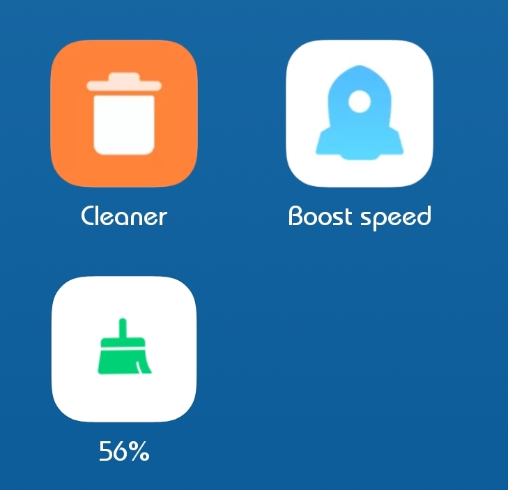

- Use Widgets or Functions similar to these (img 3);

View attachment 55507View attachment 55508View attachment 55509

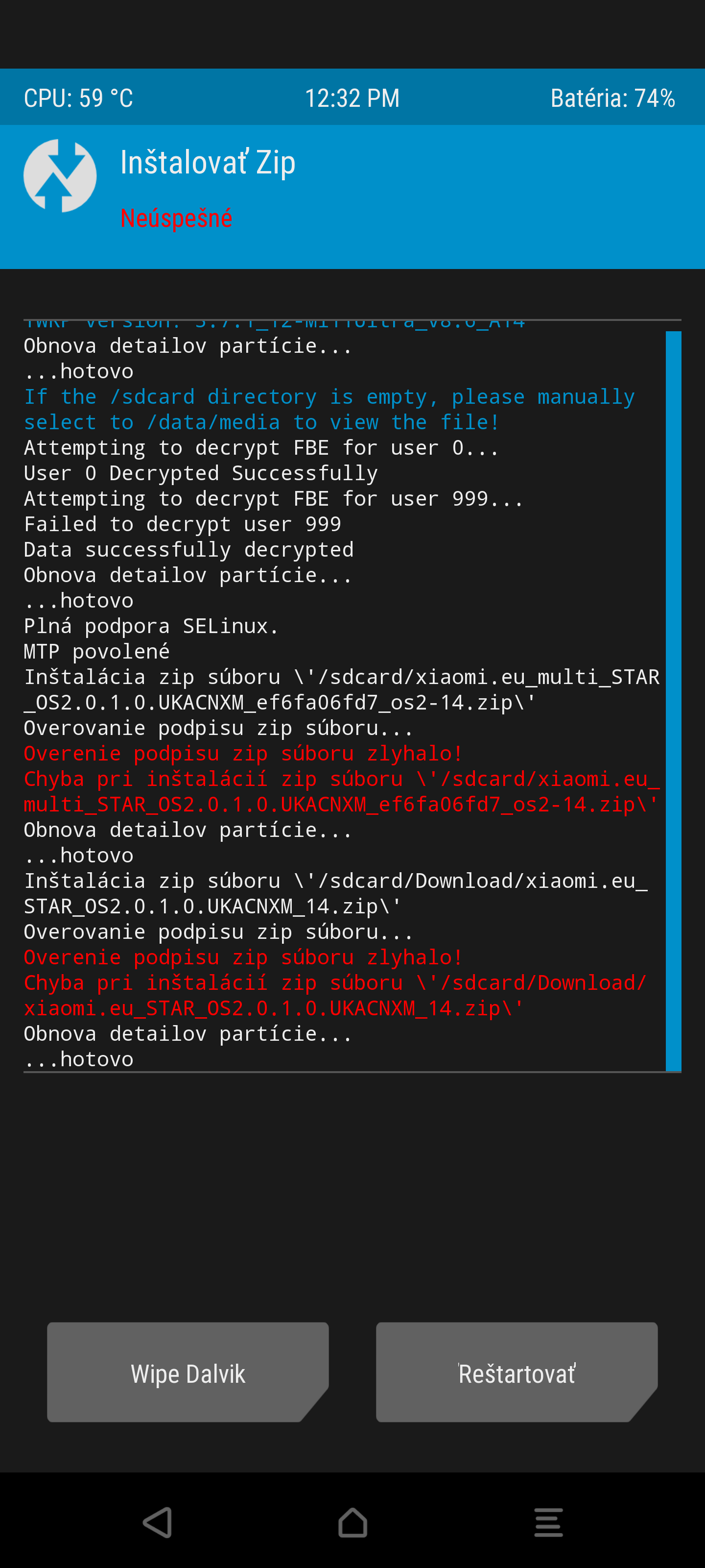

I am facing with a problem of updating my Xiaomi Mi 11 Ultra (Star) to HyperOS 2.0. I have downloaded file "xiaomi.eu_STAR_OS2.0.1.0.UKACNXM_14.zip". After choosing this file in TWRP I will get error "signature verification failed". Also I have tried to download update trough Updater. Same result. I am not sure, what I have done wrong.

You are right! It worked without any problems on my work laptop. I only have a LeMobile Android ADB usb installed. Thanks for the answers. The ROM is perfect. Which USB driver should I install?
