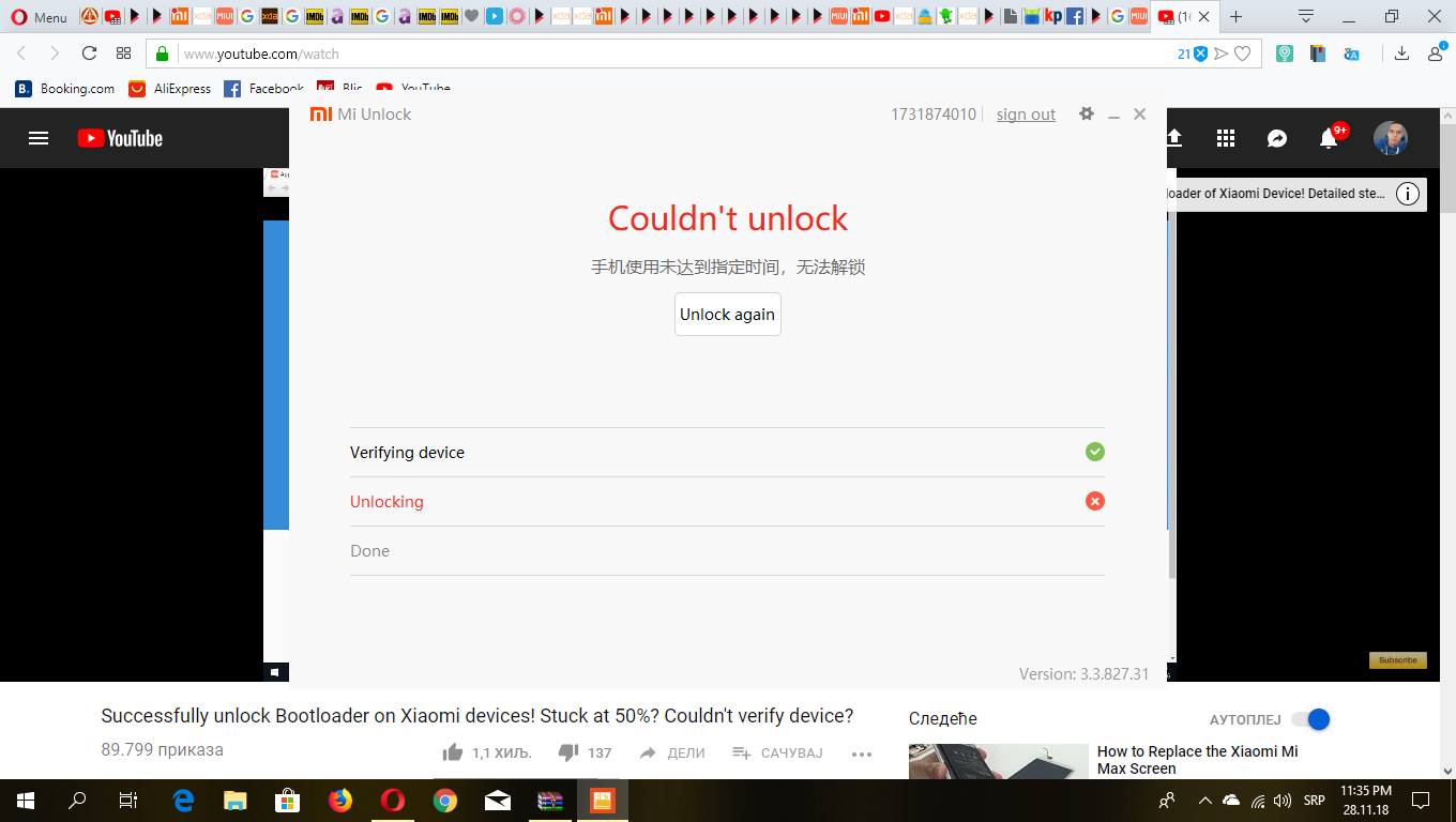

After 360 hours passed, i tried to unlock my MI 8 and i got this error... Somebody help please?

I tried everything you said, in all situations i stuck on 99% with this chinese error translating in english: unable to unlock when the phone is not used for the specifed time.. What this mean?
I had the same error and i solved it.The procedure was: sign out from MI account (from the root of settings, under the Account section) and then sign in. After this go under Developer Options and add the phone in the Mi Unlock voice. Then i unlocked my bootloader without further problems.

I waited 360 h again, then do this that you said. Again same error.....
Edit: worked with mi unlock 2.3
