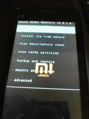

    Hi... I dont know if anybody need this recovery, but I think its pretty neat.
    It works with touch :)
    http://www.mediafire.com/?z6whh4kzo6qyf3w
    (Source miui-au.com)
    Just rename it to "updat.zip", put it in the root of your sd and flash it with the standard recovery :)
    Works on my Mi-One Plus.

  11. blackstones
    Mar 29, 2012
    519
    49
    67
    Looks like a blog :)
    do you have the possibility to upload some photos of it?
  12. type-R
    type-RMembers
    Aug 14, 2012
    154
    18
    28
    Male
    Russia
    Do you mean the photo of recovery???
  13. blackstones
    Mar 29, 2012
    519
    49
    67
    Yep the recovery thank you :) Do it support installing update.zip to both system one and two =)?
