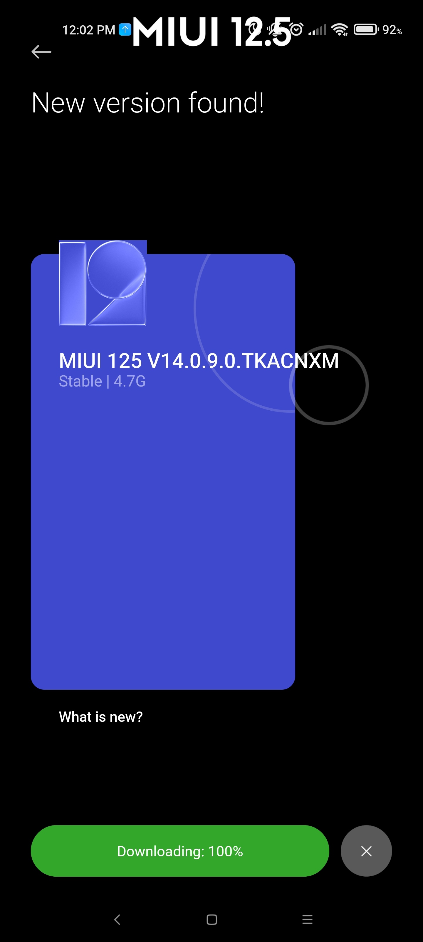

When I try to update my MIUI version it downloads the new version but gets stuck at 100% as you can see in the image.

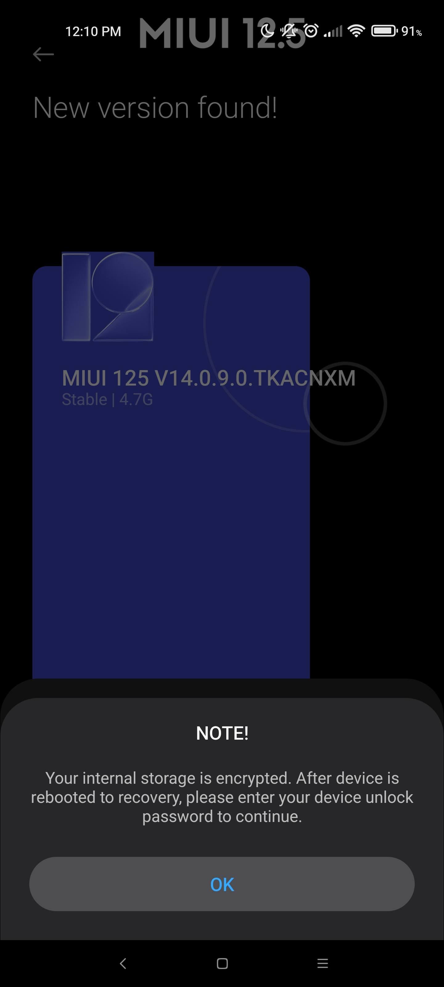

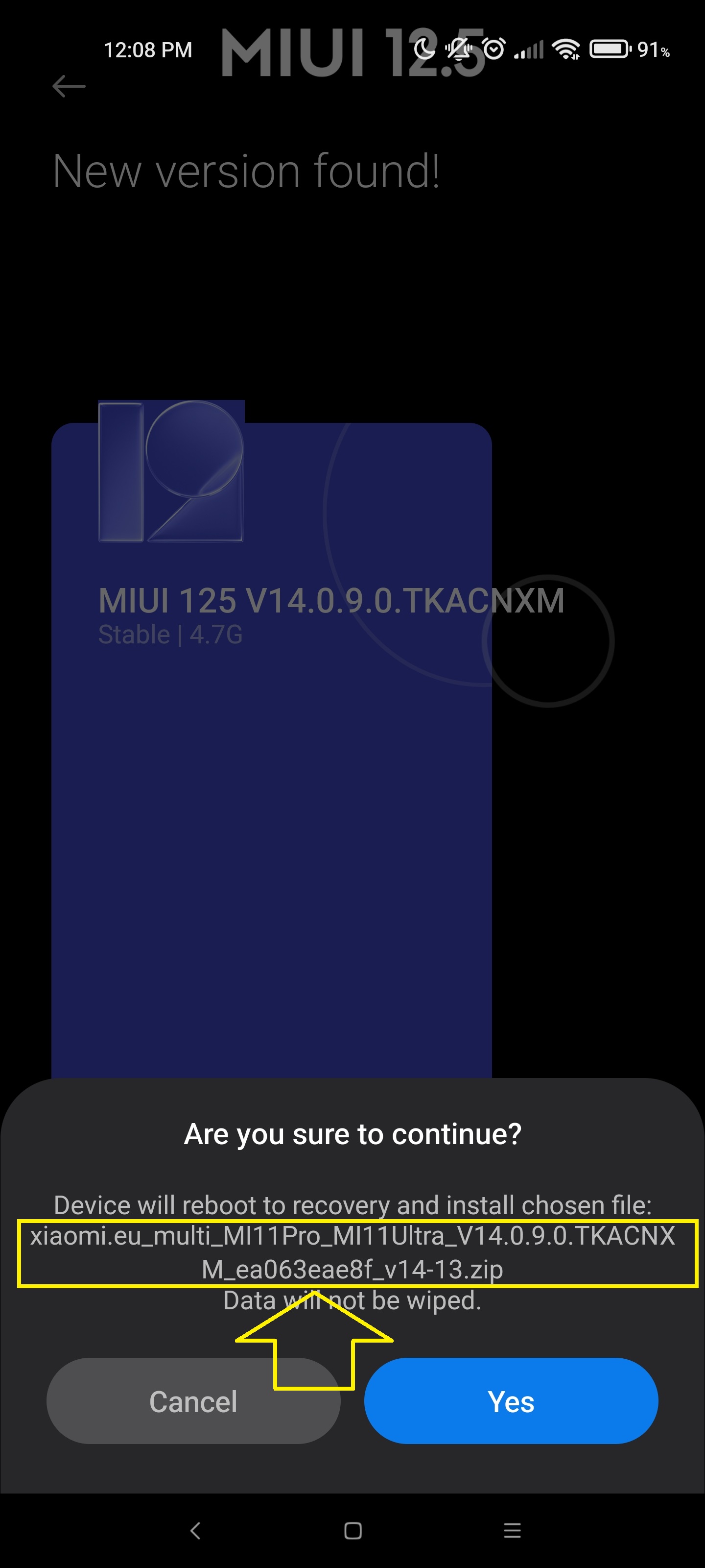

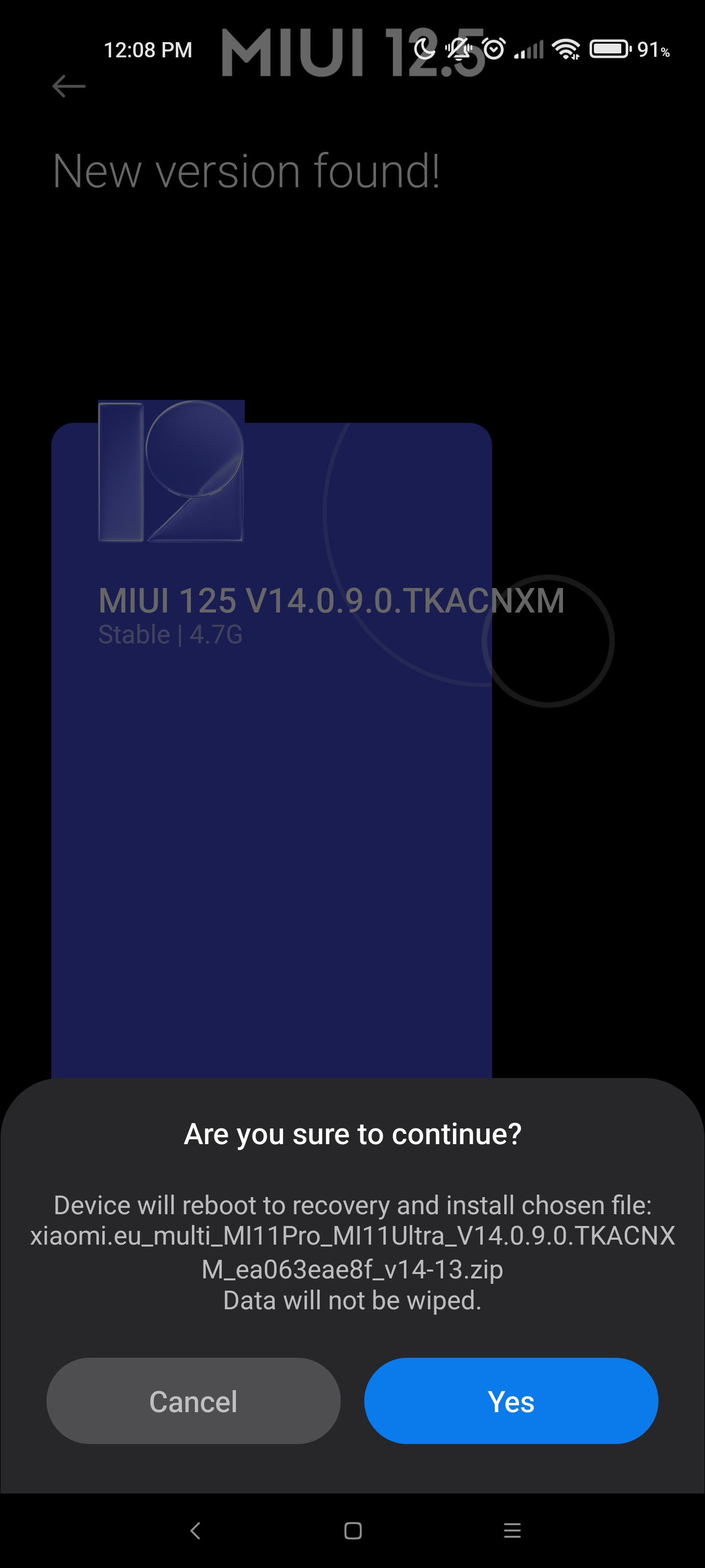

I've tried downloading the latest version from this website and enabling developer options to pick the specific file to update with but in that case it says my storage is encrypted and it has to reboot to recovery mode to install so I click okay then another box pops up asking to continue and then if I click the "Yes" button nothing happens, even if I wait. All I can do is cancel.

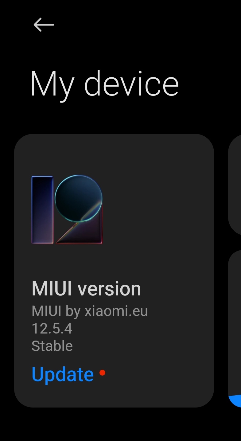

I think you are wrong. It looks like the user is using the xiaomi.eu ROM but does not have TWRP installed.
misterseeber
From the pictures it looks like you have a xiaomi.eu ROM on your device.

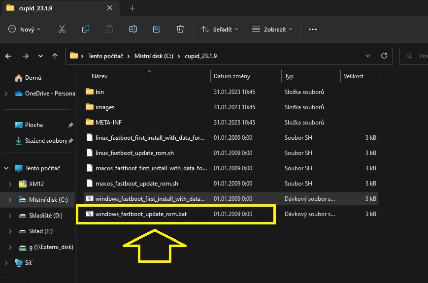

I recommend updating with the "fastboot method".
  • Download Xiaomi.eu ROM zip file to PC
  • Power off your device
  • Connect to PC via USB cable
    - update_rom - without data wipe, if you're updating from an older Xiaomi.eu ROM.
  • Wait until the device restarts itself
  • Done!
  • run one of the installation scripts (according to your PC operating system):

I'm running Windows but I don't know what you mean by installation script sorry I did this a while ago when I got the phone new but now I don't know what I'm doing.
And another question, I'm assuming I have to do this every time I want to get the latest version of MIUI?
No, if TWRP is installed, it will be possible to update on the phone.

@gogocar62 is correct, I'm running MIUI 12.5.4 by xiaomi.eu atm. I got the Chinese version of the Mi 11 Ultra as it was cheaper so I looked up how to "flash the ROM"(?) ages ago when I got it and followed a video. Almost bricked my phone at the time
Again, thanks for the help. I'll give this a go and see if it works

Check out his third picture from the Update app.
I saw that, but isn't that dialogue shown on the official ROM too, it just won't do anything after clicking "Yes" because it's not the official ROM?
Anyway, then I take back my claim from above. Even though I find the MIUI 125 quite strange.
