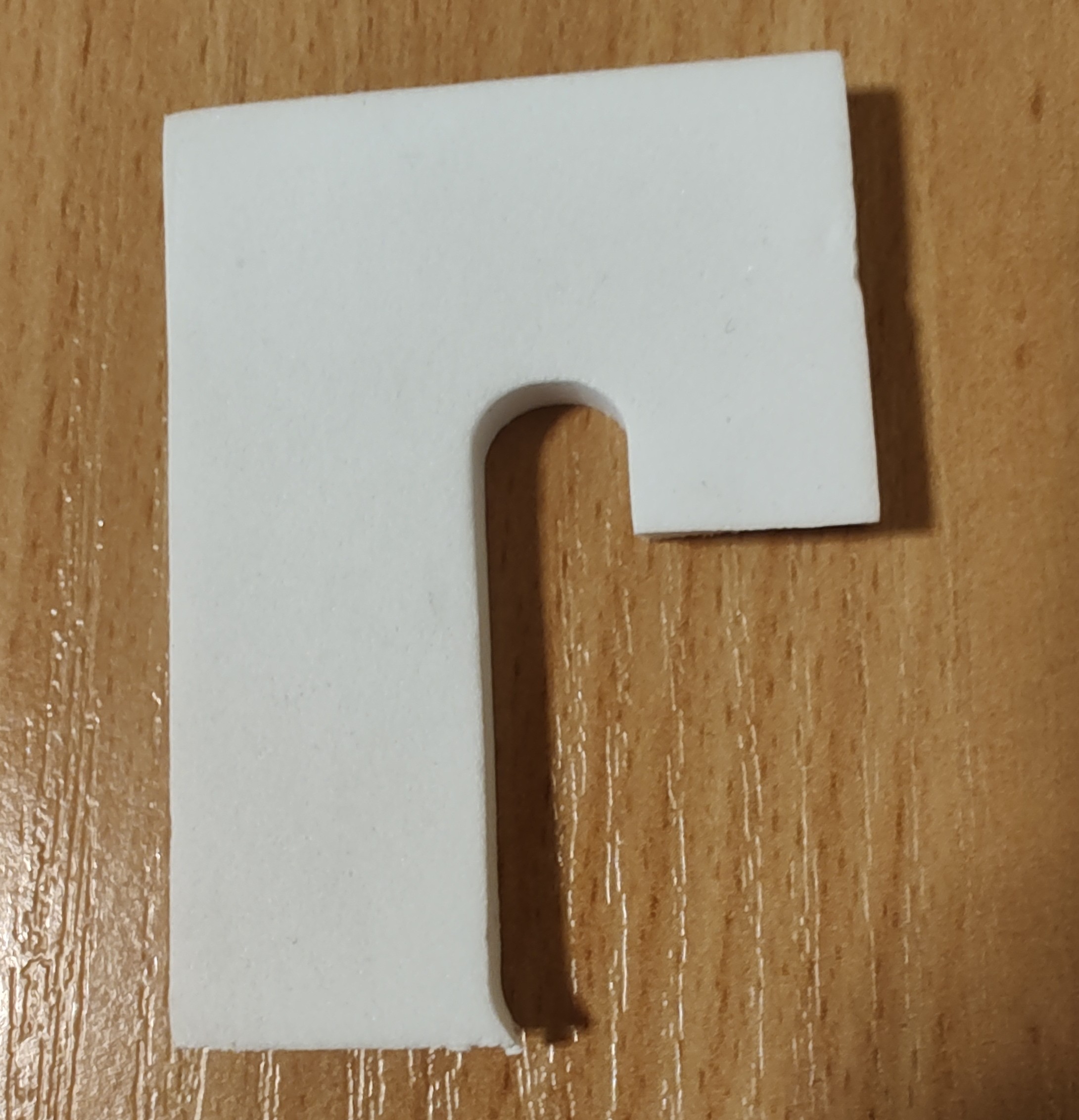

Hi! I have your same problem and tried multiple times with this pressure system and I think you have found the solution! Now do you have some issues with the payments after insulating the NFC? What kind of material did you use? Could you please evidence me in the photo where did you put the insulating material? I cannot find the spot. Thanks in advance
I don't use NFC to pay and honestly can't tell if it does. The material is a soft and insulating as shown in the picture, can't really explain what it is since I don't know myself, but I think that any material applied would work as long as it is thin enough and soft.
