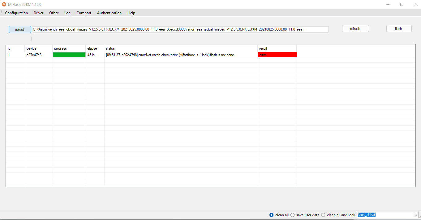

Try to install an Official fastboot ROM via Mi Flash tool (use "clean all" option and not "clean all & lock" of course...).
If your device still can't boot to System, then contact an "EDL Unbrick" paid service via Telegram (@*spam*paid*service*).
Strictly follow this guide after that your device is working fine on an Official ROM: https://xiaomi.eu/community/threads...-for-mi11-pro-ultra-lite-5g-using-twrp.62738/

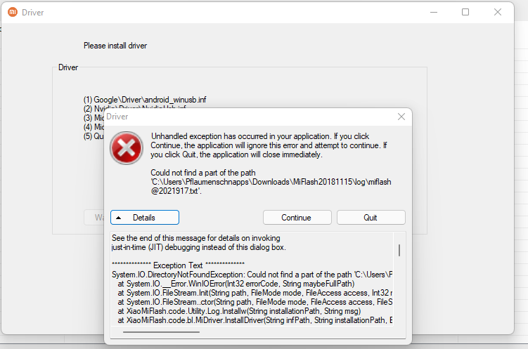

I downloaded newest flash tool here: https://www.xiaomiflash.com/download/
Then installed, started with admin privileges. Then I get asked to install drivers. I hit OK and then get this error message (and loggs attached). What should I do?
See the end of this message for details on invoking
just-in-time (JIT) debugging instead of this dialog box.
************** Exception Text **************

Poney70
Donator
Oct 3, 2019
5,490
337
Hello, follow this guide to install Xiaomi drivers: https://xiaomi.eu/community/threads/problems-with-updating.61957/post-616357
And you don't really need to use Mi Flash tool, you can run "flash_all.bat" file inside Official fastboot ROMs to flash your device. :)

I tried the flash with the Xiaomi Tool (found a workaround to the first error). but encountered this error duding the flash process. Screenshot and log attached.
This error is not important, flash is complete. ;)
