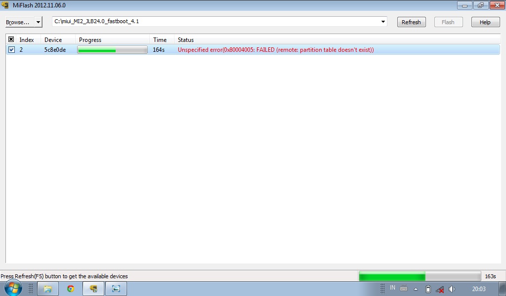

My Mi2s cannot flash miflash, and can't wipe data, update.zip is corrupted, stuck on mi logo. and my recovery is not CWM :(
but mi recovery.

you may have messed up your partition table. If you dunno how to manually fix it you can restore everything in dload mode with the tweezer-battery-shortcut
can you explain me ? :(
what is dload mode?
Can you teach me step by step ,micha?
Hi, I have updated little bit the procedure to make it more user friendly + added 1 hint to get even more Storage space :)
I know but you can manually enter dload mode with the shortcut described in this thread.
When your phone is in dload mode miflash recreates the partition table
woww,,, amazing. :D
Thank you Master Micha. You've saved my life.
My M2S have risen from the grave now. : D

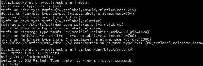

Could someone help me on the parted command. It like it doesn't do something instead of giving me the partition table. Screenshot here. What did I do wrong?
Edit: When I try "adb shell parted -s /dev/block/mmcblk0 print"
this give me "Error: Error opening /dev/block/mmcblk0: Permission denied".
I looked (in system/bin) parted file's ownership (root:root) and permissions (777). Don't know what to do more than that..
Edit: PLEASE FORGET all that I wrote! I tried again and for now, it works. And what I meant before is that I couldn't see that I wrote the first time after tipping "parted" because of many lags, bugs, virus, trojans, ads, spiders, dust and others stranges inhabitants in/on my pc :D
