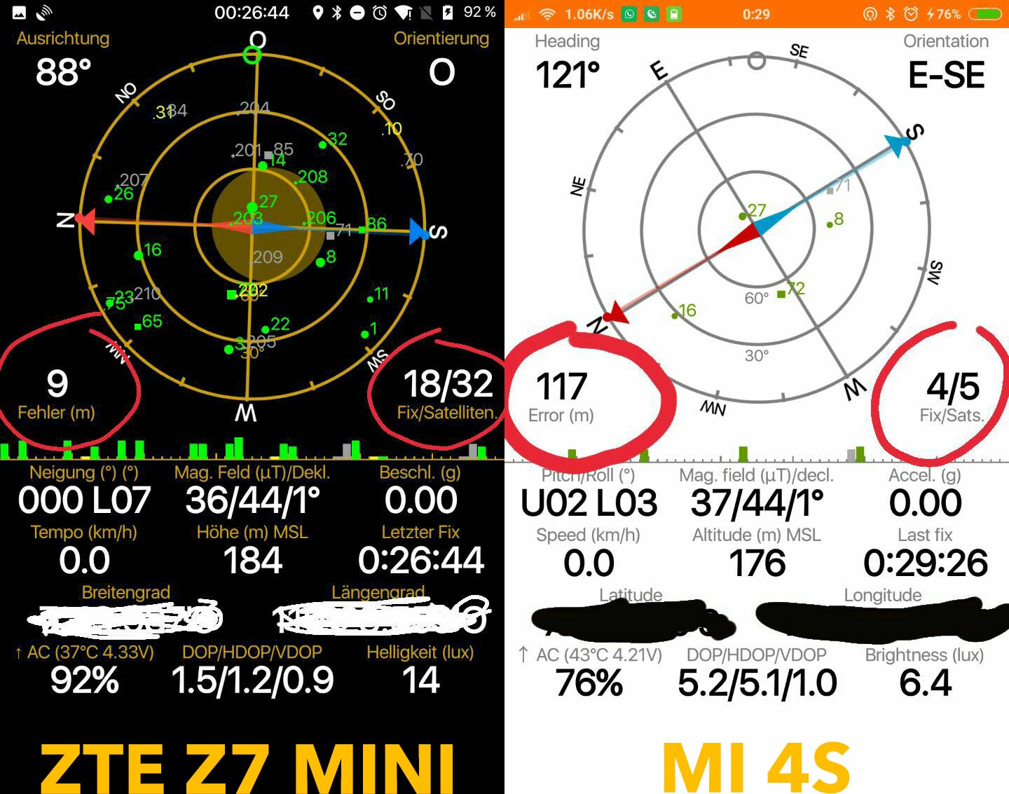

I did a comparation between my old ZTE Z7 mini and my Mi4S using GPS Status.
the result is just so disappointing.
My ZTE Z7 Mini could lock within 10 seconds, using 18 out of 32 satellites detected, and with 9 meters accuracy. --> see the picture with black background
and my Mi4S... could not really lock...
it only connect with 4 out of 5 satellites with huge error (117 meters accuracy) --> see the picture with white background.
My friends then tried it with their Mi4C, Redmi Note 3 Pro and Mi Note...and they too have difficulties to get a lock with GPS. Using google map during a drive is a catastrophe. the position points jumps all the time...
We tried several tips and tricks how to get a better GPS lock. NONE of them make any differences...
