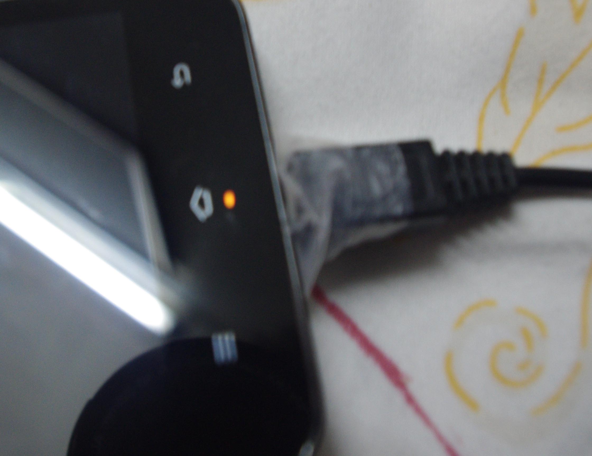

Use scotch tape to press the usb down onto the connector. Scotch tape leaves no glue residue. Need to find a fix for this soon. I emailed ibuygou support.

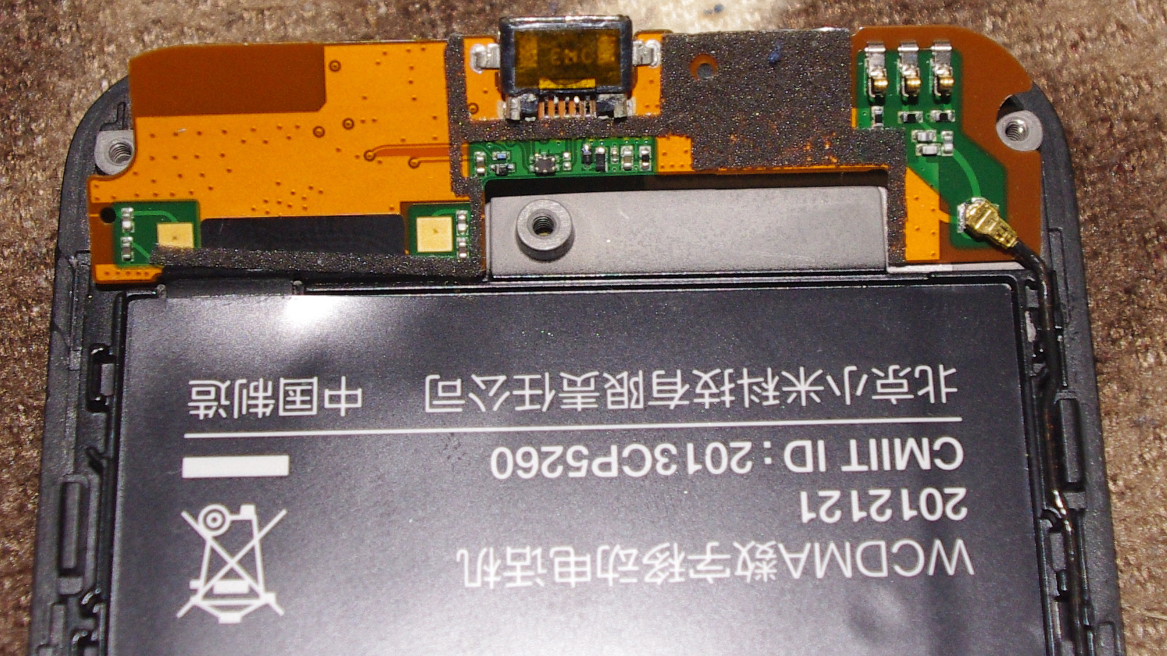

Update. My phone was not charging any longer. Took it apart. Looking for this defective part replacement.
Need a replacement for this. Unable to find it. Anyone?
Cool pictures. Yes we need to find these parts but i couldn't find a part broker for xiaomi. I'm going to try to ask sciphone first then xiaomi directly
Envoyé de mon LG-D802 en utilisant Tapatalk
So I was able to solder a new Micro-USB port on the phone. Unfortunately that didn't fix the issue. The whole module needs replacement. Not just the micro-usb port. Tough luck finding that.

That part I am sure is bad on daughters phone, also. Replaced USB port, didn't fix. Ended up with spare battery and external charger to keep hers working'
