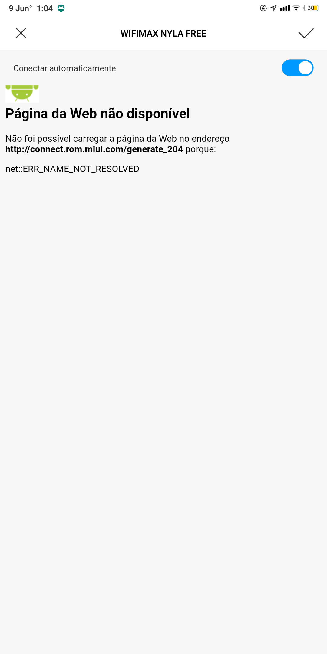

Installed 10.3.1 on my Redmi Note 5 and get this error
when trying to connect in wifi

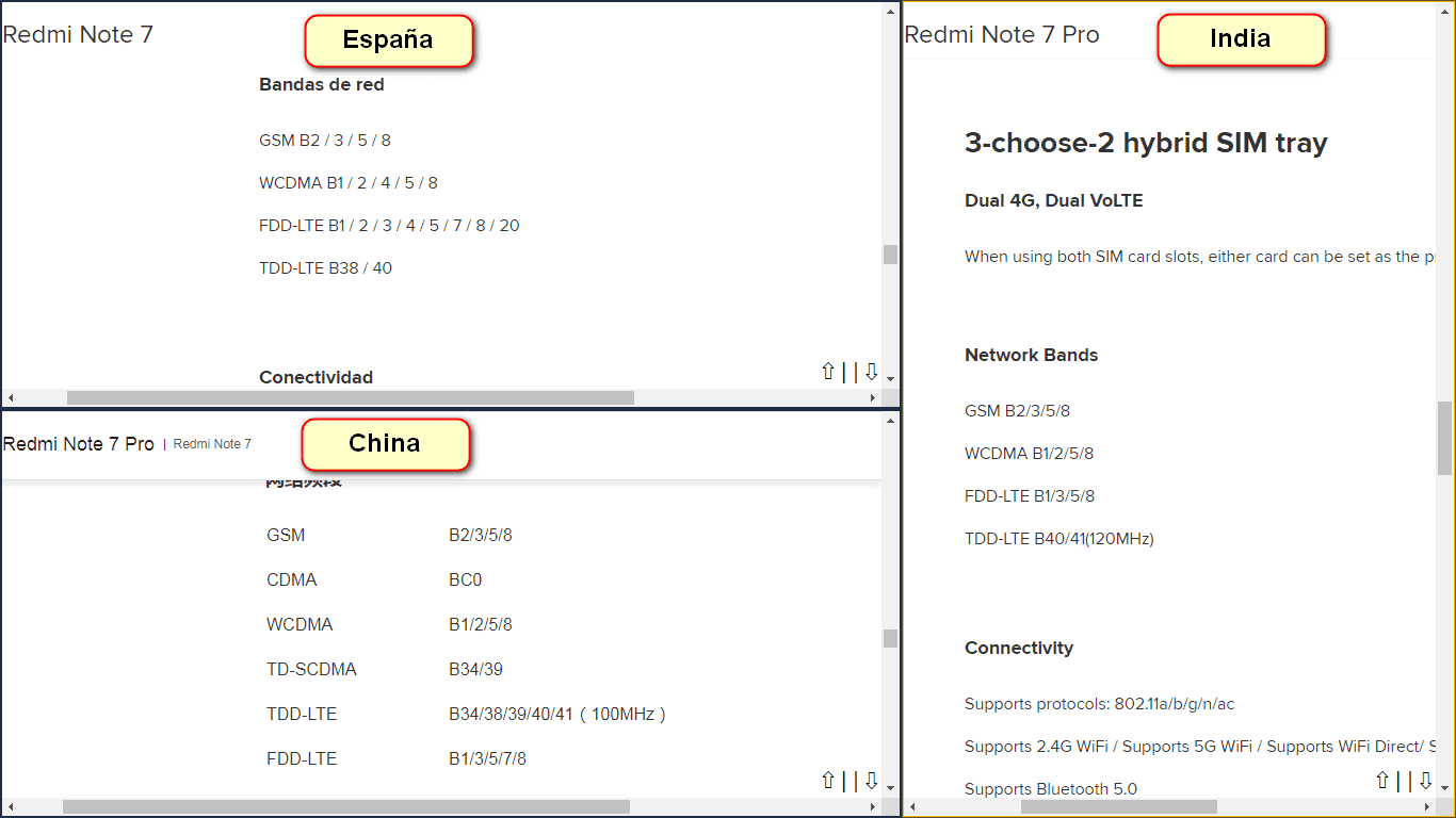

Hello, another question
i have note 7 pro Chinese variant, if i flash this ROM or the Indian ROM, will it affect my lte bands?
considering the Chinese and Indian variant have different lte bands
Chinese variant has bands 7, 34, 38, 39 where as the Indian one does not
Radio band and LTE channel are natively buried into your phone model. No way to change or modify them.
You can Flash whatever ROM you want without risk!
Reactions: SopiMan
Why there is no V10.2.2.0.OAGCNXM just V10.2.1.0 as stable Xiaomi.eu ROM for Mi5s - even though there is V10.2.2 China Stable Version officially available?
So to speak, all roms support all lte bands. But it is up to the devices hardware?
