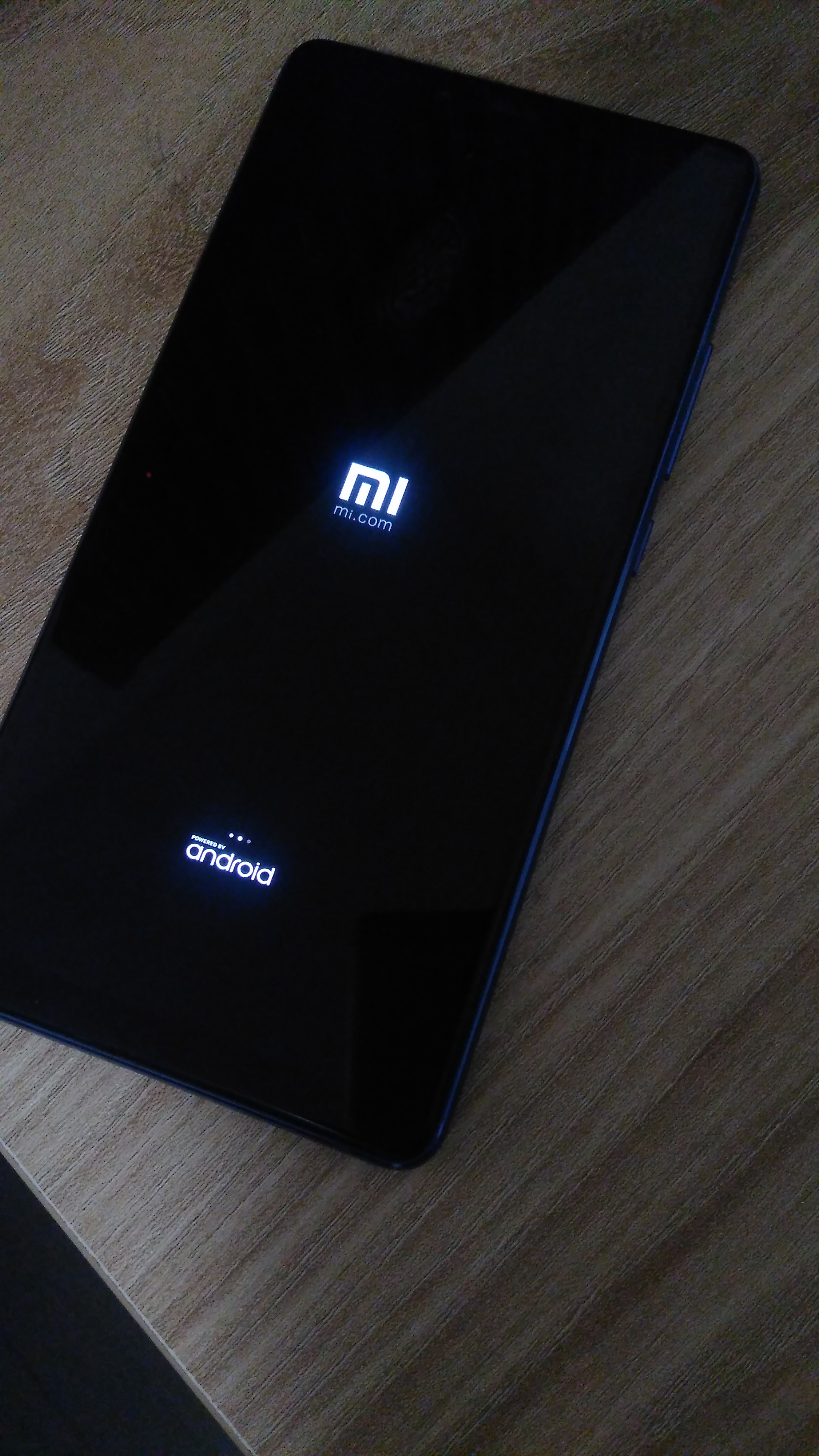

I just finish to install miui 10.0.1.0 in my MI8 SE but after 30 minutes, I see the loading screen stucked. I Tried to reinstall also, but I have the same problem.
What can I do?
What can I do?
??? Help please or I will have to return back to the shop.... :/
Go to twrp and format data (confirm by typing yes). Data will be lost.
I think it was what I did when I installed the rom. I had the same problem with boot loop. After formating data, you will have to copy again the rom into internal memory of the phone. For this, you just have to connect the phone to your computer, it will appear in "My Computer".

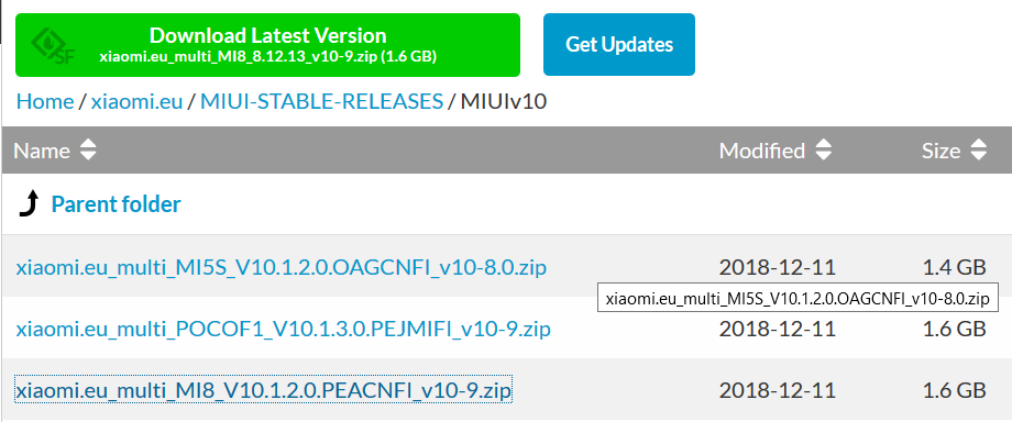

Found two files for MI8 on STABLE Link at sourceforge:
xiaomi.eu_multi_MI8_V10.1.2.0.PEACNFI_v10-9.zip (2018-12-11)
and on the Top, the "Download Latest Version" file:
xiaomi.eu_multi_MI8_8.12.13_v10-9.zip
Are both files STABLE releases?

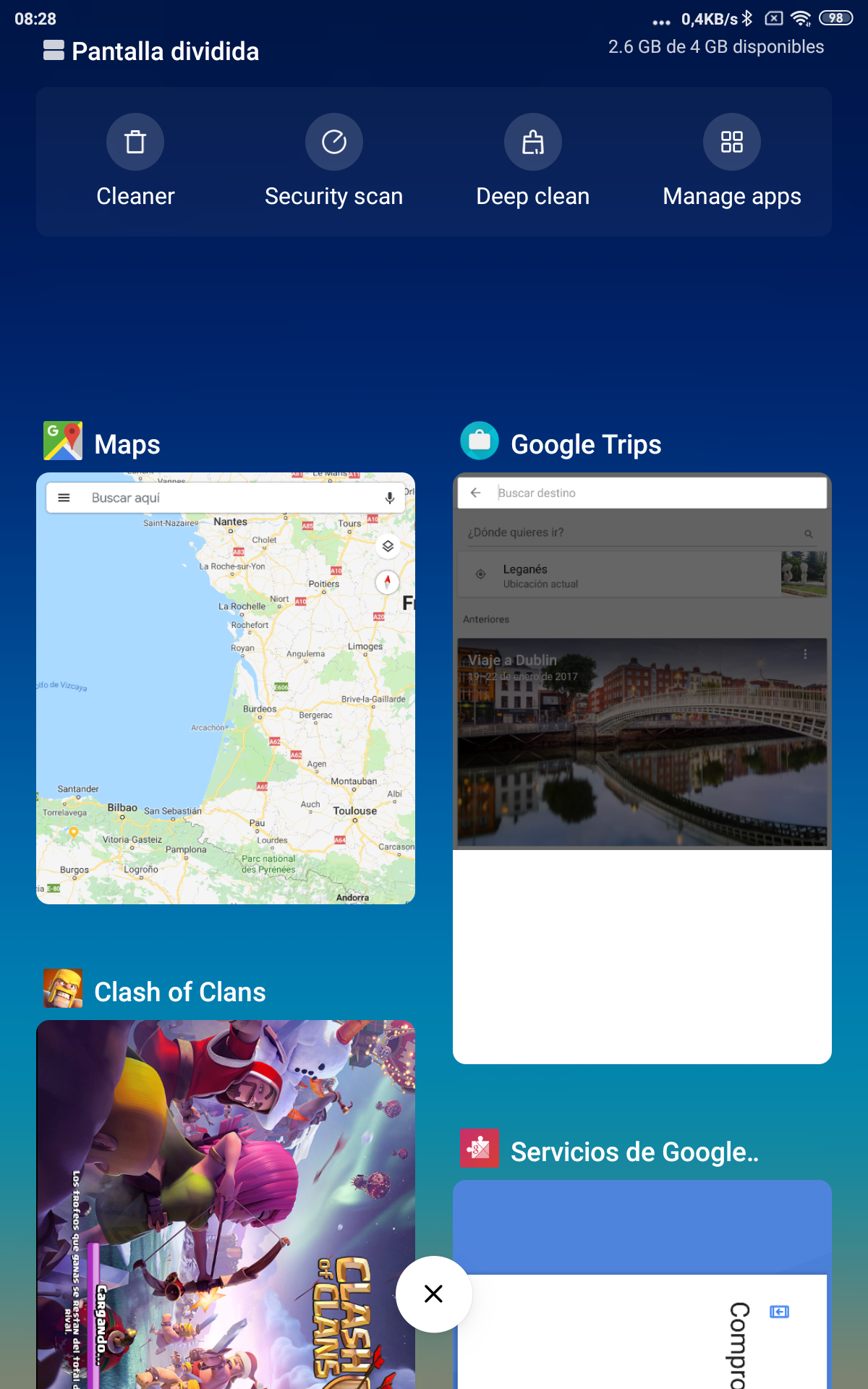

no puedo acceder a las app de Xiaomi de CLEAN, SECURITY SCAN desde mipad 4 con esta rom
Ehy thank a lot!!! I just figured out!
I wipe data through Twrp with the WIPE DATA button, then I reboot in recovery mode and copy another time file of MIUI10 inside the phone.
Then I perform a reinstall of the ROM and it works!!!
Omg finally I can use my new Mi8 SE! Thanks a lot guys!

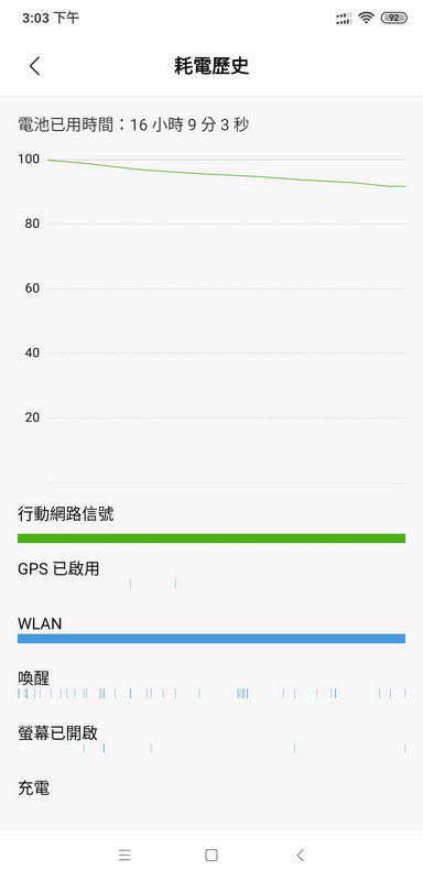

Since unplugged 3 days and 11.5 hours ago the battery went down only to 44% with 3.5h of SoT. It's. Just. Amazing.
Oh, forgot to update the post - so the final figures:
- 5 days 12 hours since unplugged from charger (100% to 4%)
- 6h SoT with my mixed usage pattern (forum app, Gmail, Via & Chrome, Telegram, FB messenger, VLC, no hard gaming)
- idle drain was 0.26%/h
- 6h of awake state during this whole period
- CPU: 2GHz 1h 41m; 1.4GHz: 52m; 652Mhz: 9h 44m; other freqs were between 2..15 mins
- WiFi 2.4GHz + 3G (continuously & alternately)
- sync always on
- brightness was fix 40%
- The only "extraordinary" thing I did to tune the ROM's operations was: I disabled ZRAM with Magisk 18 + Swaptorpedo module (IMHO it's a bad idea to use such a feature when RAM is more than 2GB, especially if you consider MIUI's quite aggressive RAM management (that is waste of money: IMHO free RAM is wasted and thus it's wasted money, this is not Windows)).

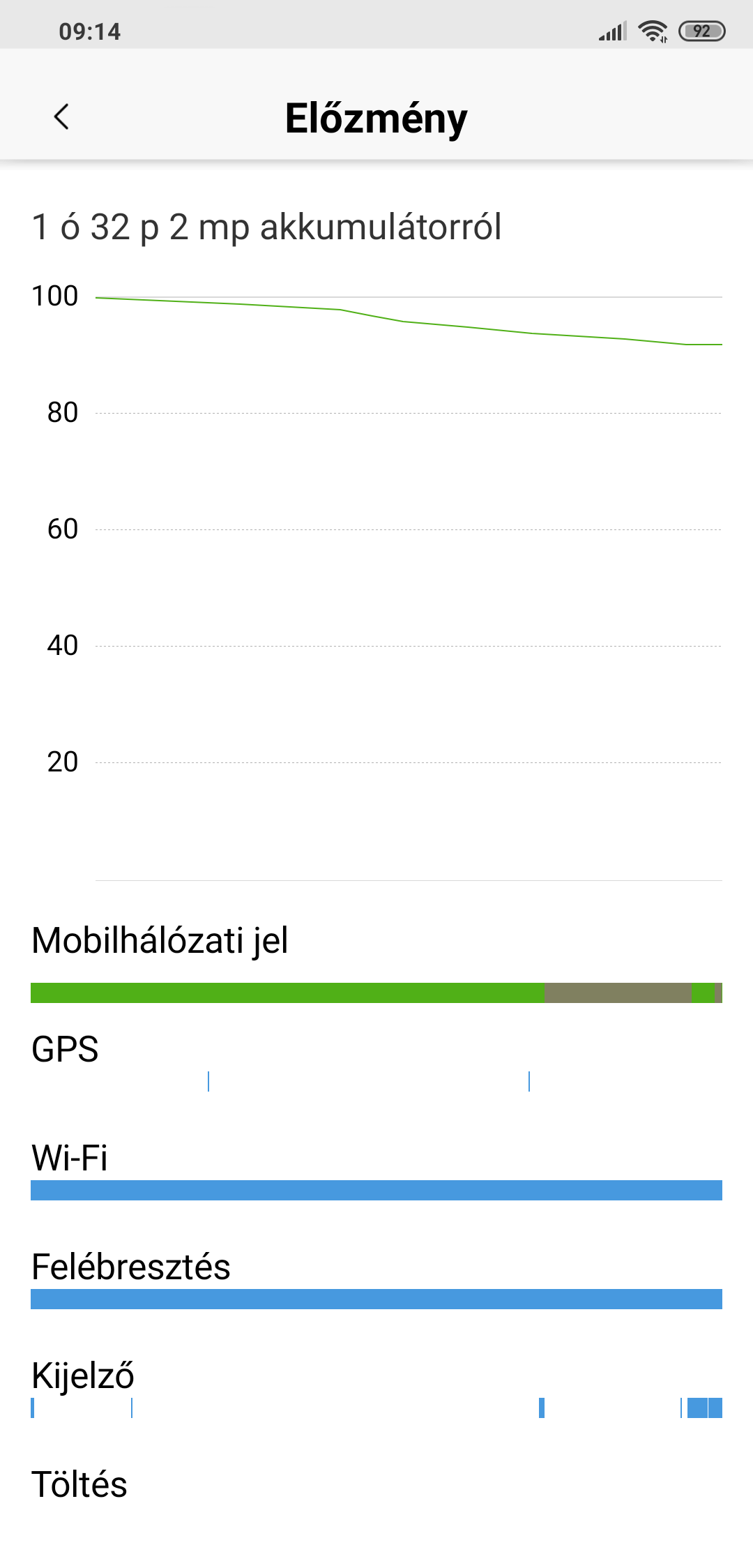

I installed clean method wipe data cache and dalvik with twrp 3 times. But battery drain is horror and not work *no-support-for-this-app-on-this-forum* after install fix. One and half our time after has 8% drain.
Did you format data (need to type "yes" in twrp) before flashing?
I choose advanced wipe and here data, cache, and dalvik wipe, Ithink same here data and format data., Or not?
