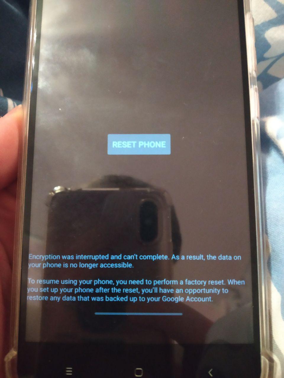

Stable ROM for 5x isn't working correctly...please look on the pictures...error of the voice recorder, one time before was total error of gboard... cancelled the installation...please check...I had a beta before...then clear via TWRP the cash, delvik, system, data, and format data via "yes"-option...but still work incorrect...
similar problem, the firmware is not even installed, first a keyboard error, and then this error
MI 5X xiaomi.eu_multi_MI5X_V10.1.3.0.NDBCNFI_v10-7.1.zip
