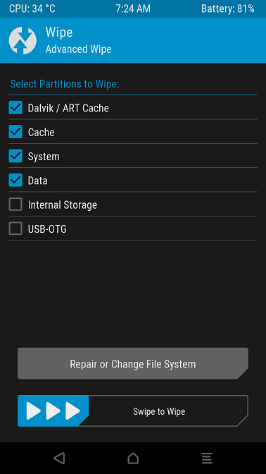

New rom on Mi 8 SE is big update because installs new android. Do i need to format data and wipe all?
As i can see TWRP 1217 works ok with this update?
You should select 4 wipe
Also 1217 works good to update V10.2.2.0 from V10.2.1.0

on big updates i always wipe system. TWRP stais installed so if something goes wrong there is no problem. just c/p new rom from pc to phone
Sent from my MI 8 SE using Tapatalk
A ROM installation already wipes System, so what you're doing is meaningless.

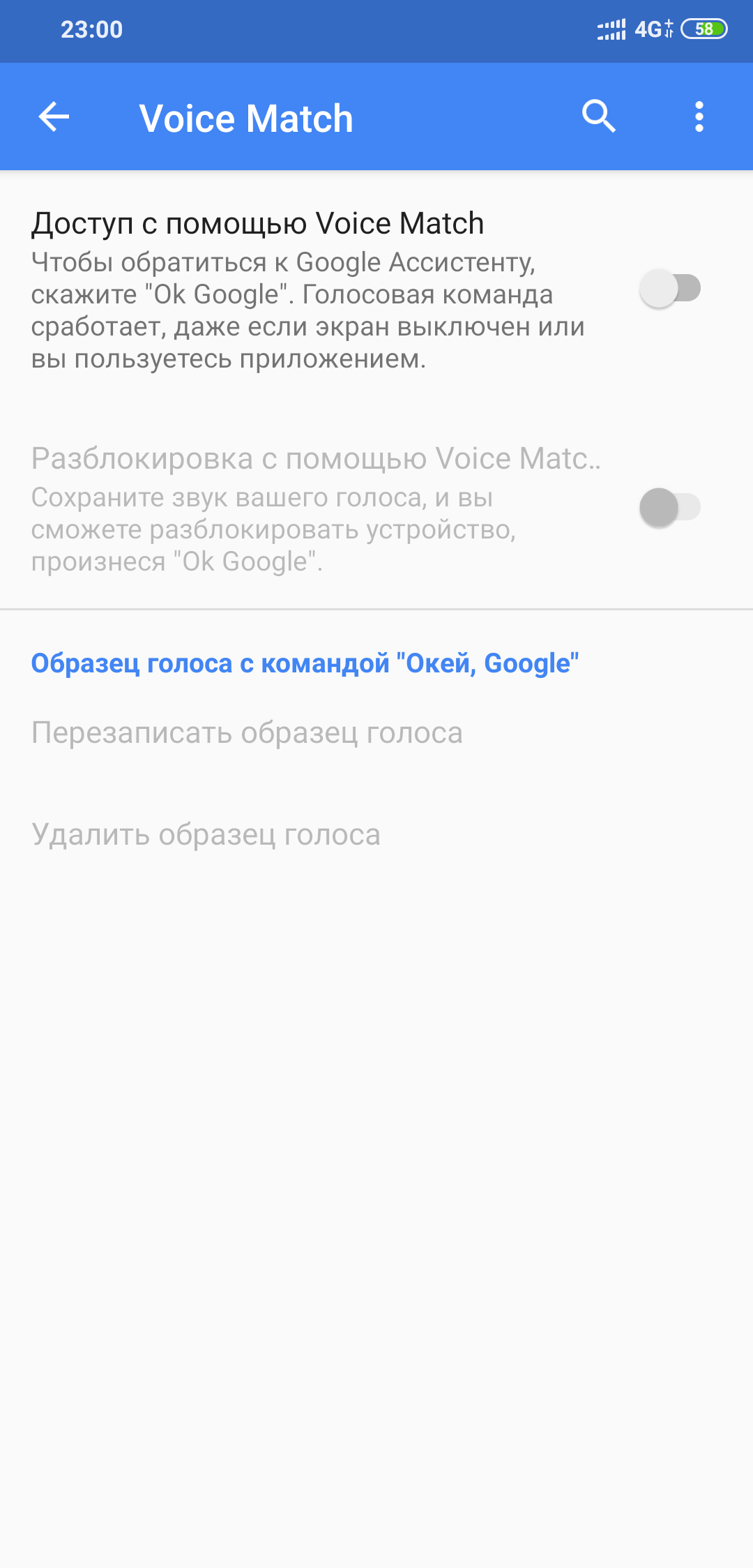

Hello. Please help. Do not work Voice Match. MI8 phone. Firmware MIUI 10.2.2 EU. Russian
  • Screenshot_2019-02-09-23-00-50-155_com.google.android.googlequicksearchbox.png
