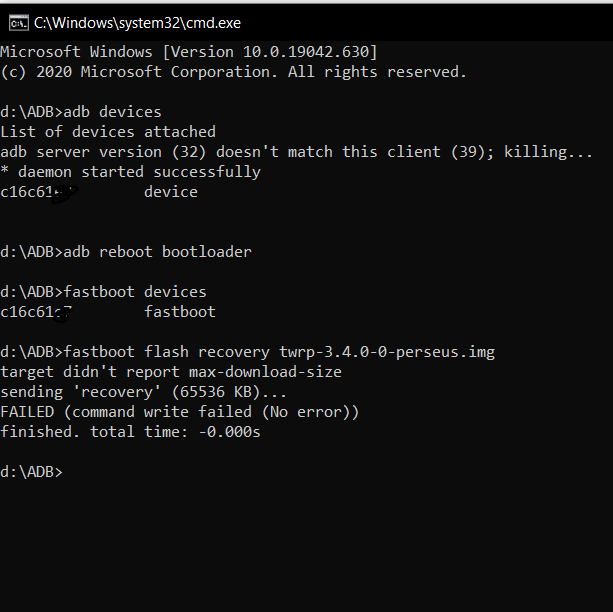

so.
NOPE
i installed the Qualcomm drivers.
rebooted the laptop.
i get stuck at <waiting for any device>
i changed the USB 3 port with the USB C
i can see the phone on adb devices
i can send the reboot to bootloader command
the bootloader starts (the guy with the hat)
if i give the flash command... nothing.
if i give the command mentioned above fatboot boot twrp.img... nothing....
so no luck. :p
i shall try my wifes laptop. an older one with USB 2
The same on my wife's laptop.
I've tried 2 cables. The original MiMix3 one. And another one.
Sent from my Moto Z3 Play using Tapatalk

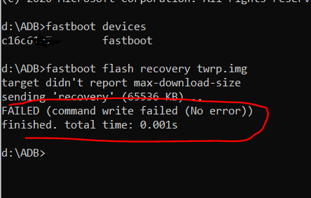

so... it does not work
i've installed the qualcomm drivers
i've installed xiaomi drivers (with a RED warning upon installing)
the phone is visible in device manager

the pone is visible on fastboot devices command
but as i give th flash command... i get this error
33127

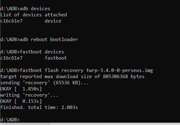

Use USB 2.0 port. If you don't have any USB 2.0 port on your computer, buy and use a "USB 2.0 hub". ;)
progress.
it turns out that my current USB-C hub has 2 - USB 3 ports, - 2 - USB 2 PORTS, one USB-C port and wireless charging.
33130
now how do i make it STICK?
i managed to boot into recovey.
