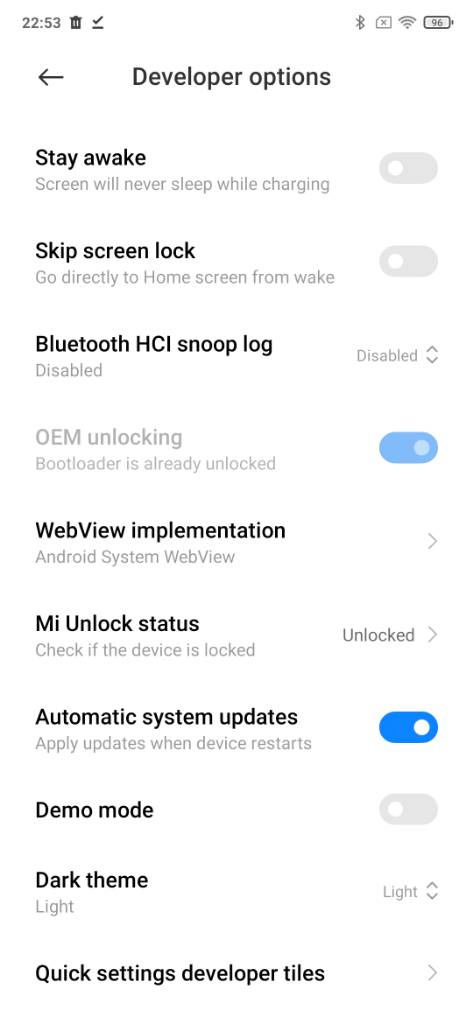

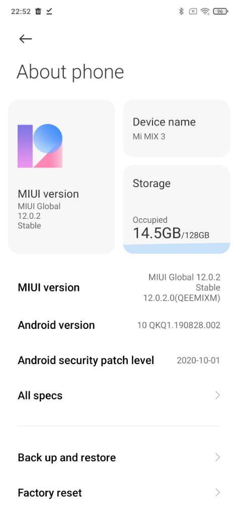

Greetings,
I'm new in the Miui universe.
I bought a second hand MiMix3 in order to use it JUST for video editing of my Insta360OneR footage. Yes, the mobile editing experience is better and faster than the PC one.
I wanted to install a custom ROM, in order to get more speed out of the device.
The requirements were to install first a xiaomi.eu ROM then to install the custom one.
So I visited this thread.
I downloaded the TWRP and I tried to flash it in order to proceed on flashing the ROM.
The img file is a 26 mega one, if I recall correctly. The phone is visible in adb devices. I can access the storage and copy files from and to the phone. So... No driver issues.
But when I launch the fastboot command nothing happens. I've waited for minutes. Nothing. So I cannot proceed.
The phone seems to have been unlocked before I got it. See the attachments.
Can anyone tell me what to do?
Can anyone tell me what to do?View attachment 33105View attachment 33106

You have to reboot your phone in fastboot mode using any of the following options
1, "adb reboot bootloader"
2, hold vol- while rebooting your device
3, using the extended power menu
Then flash twrp using command line
"fastboot flash recovery twrp.img"
finally
"fastboot reboot"
and hold vol+ key to boot to twrp
Reactions: DTTR76

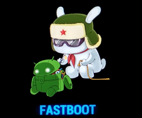

I've tried that too.
I cannot remember exactly the message I get from the command prompt... I think it's ” waiting for device”.
I have the phone the command to reboot into recovery, it works, reboot into fastboot, it works. Just the command to flash the .img does nothing.
When I reboot into bootloader I get a green Android mascot with a red star on his hat. Is that it?
Then when I give the fastboot command I think the mascot disappears and I get something written on the top left of the screen with small small small letters.

The mascot looks something similar to this?
An image of the screen with the "small small letters" will be good
Reactions: DTTR76
That's the mascot.
I will try to make a photo of the small small small text. It's so small I cannot read it.
