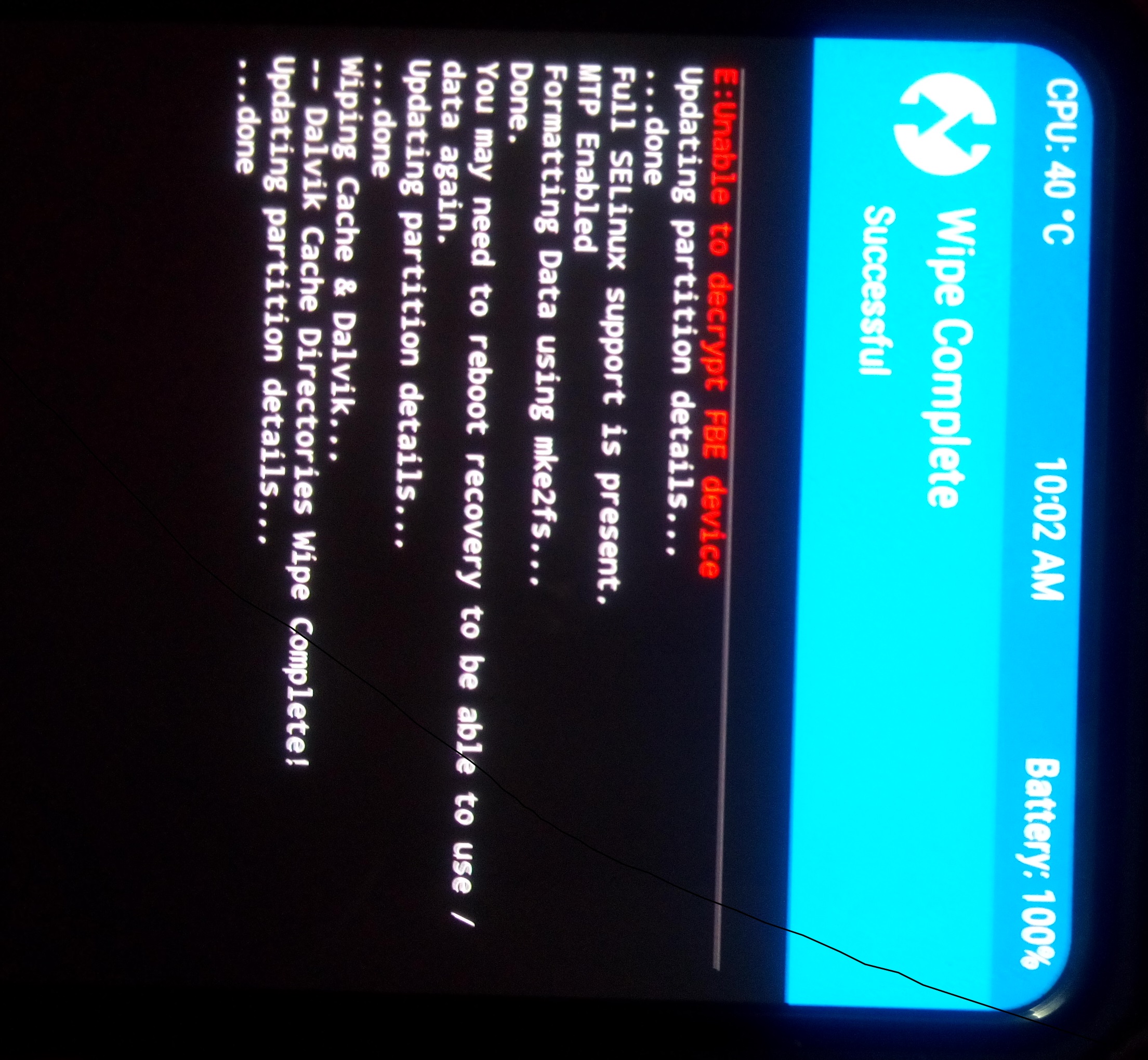

i have a problem and need assistence for a mi9tpro. i installed the twrp, whiped data,copied the xiaomi.eu_multi_HMK20ProMI9TPro_V12.0.6.0.QFKCNXM_v12-10... stable rom and selected it for install. after it did the instalation the phone refused to boot into the operating sistem.
i booted again into the twrp, pressed format data and it showed successfull but with a error message. now i can't copy any file to the phone and i am stuck with a phone withouth operating sistem
Reboot to system from twrp..
As soon as you already flash the rom , just reboot to system and device will be turned on..
EDIT
And just to know , read what it says at twrp ( you may need to reboot to recovery to be able to use data again )..
With a reboot to recovery again you will see your storage ..
EDIT
thank you very much, it works now! i am dumb and it was the first time i replaced a rom so I missunderstood twrp instructions and i thought i need to reboot to recovery if i want to have twrp active in the future instead of booting to it from pc, so i just did a normal reboot after installing rom.
