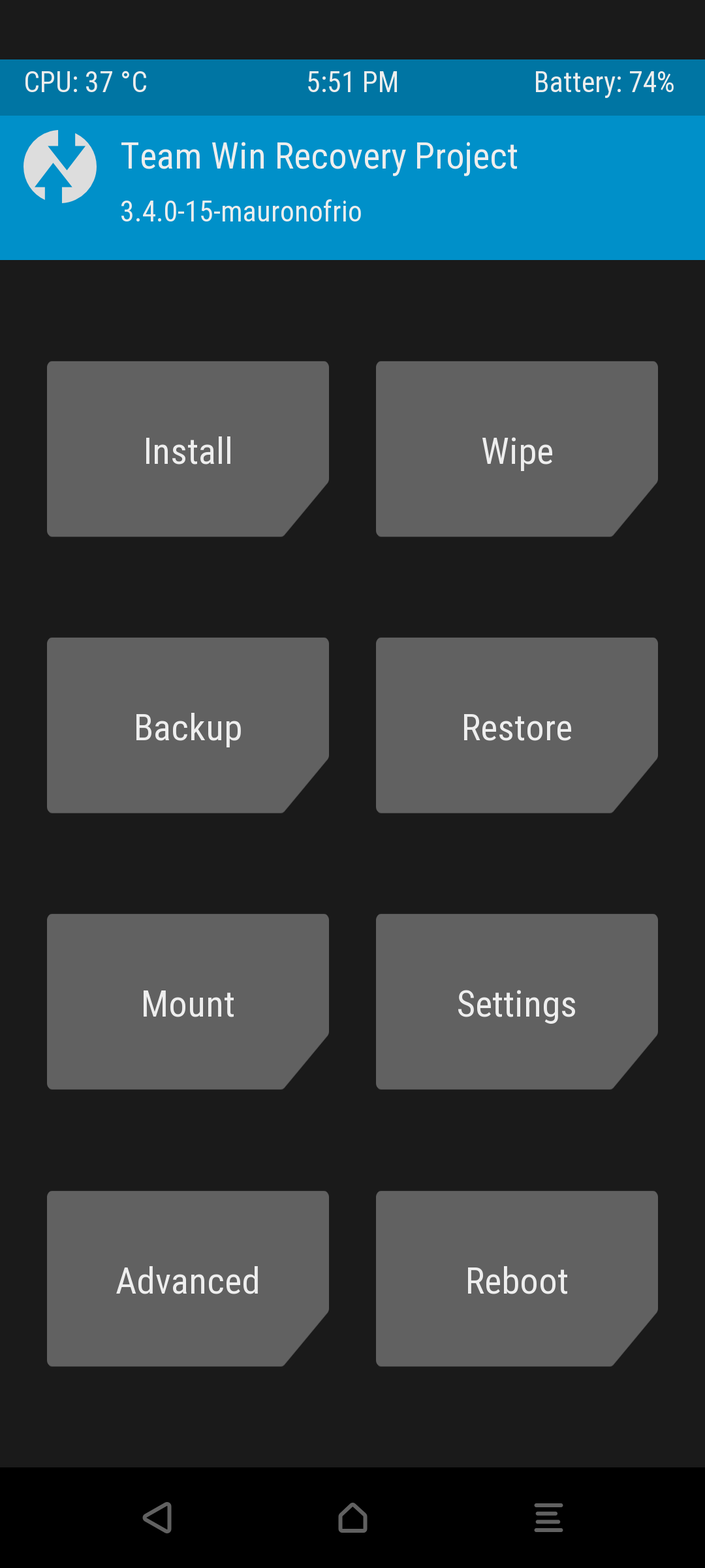

Guys, please, I need help! I have a Mi 10 Ultra, it was running Stable ROM v12.1.1.0 and I just downloaded weekly ROM v21.2.3 to flash it using TWRP, but it won't start now! It just takes me back to Recovery and doesn't start! Please help!
Fortunately, I was able to get the ROM I was running before on a USB and installed that again and it works now and I didn't loose anything. But can someone tell me why this happened?
Happened because you flashed a weekly rom over stable rom data.
To move from stable to weekly or from weekly to stable you need to format data in twrp
