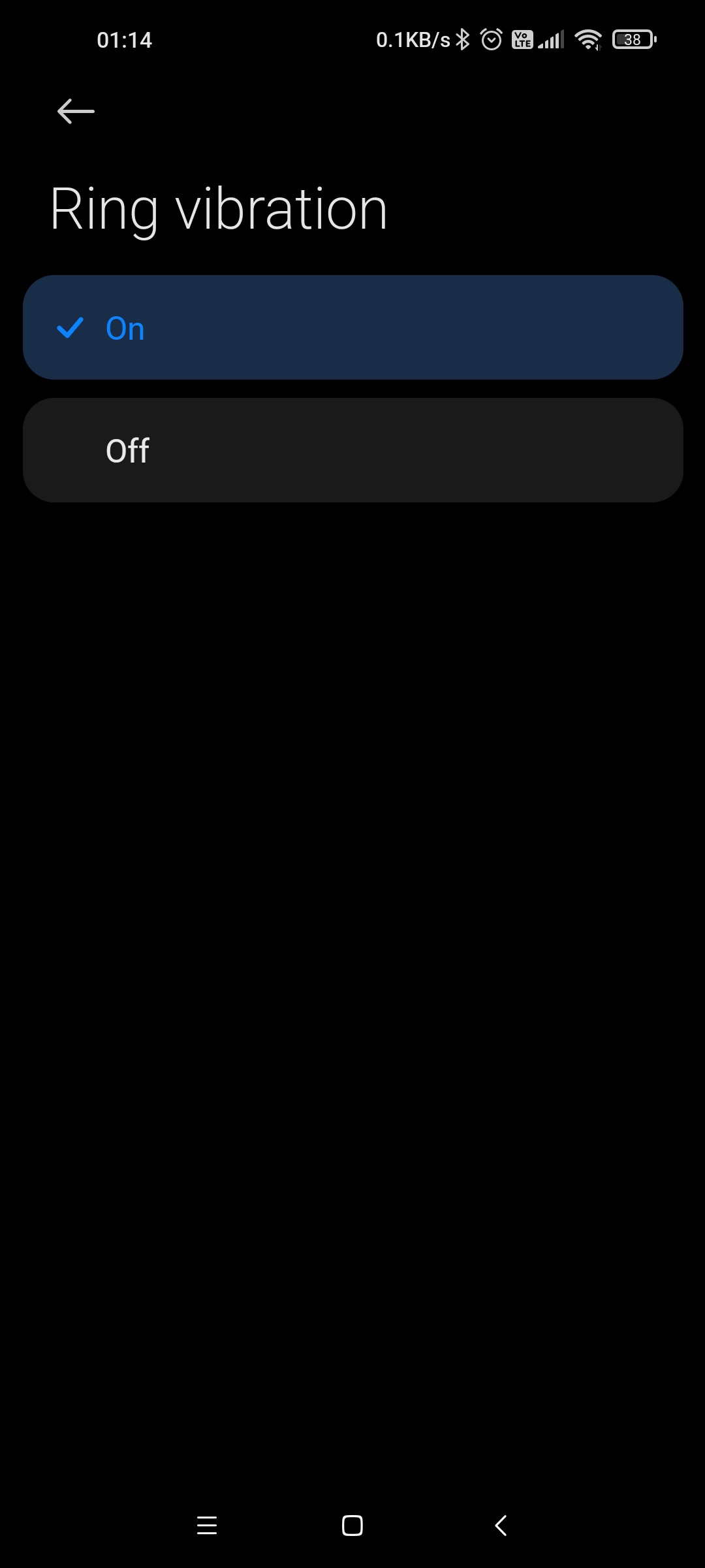

My vibration motor goes off occasionally. The test doesn't pass (When you click kernel version several times). It only works when you turn on and off below setting.
