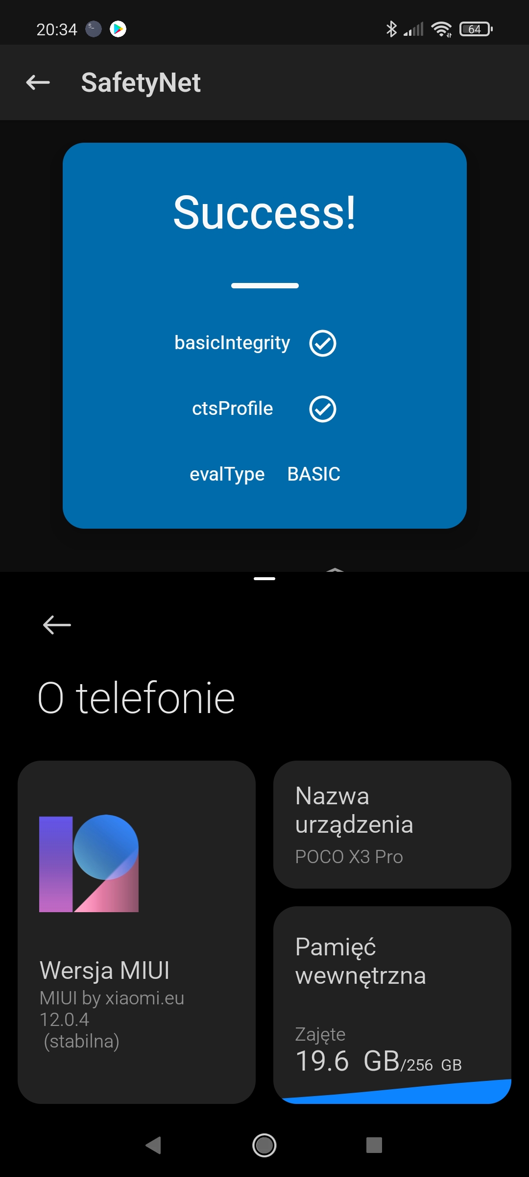

Ok, here's how to pass SafetyNet on this ROM on the POCO X3 Pro:
1. Install Magisk. Instructions (follow instructions for ramdisk/boot.img; you can get the boot.img easily from the xiaomi.eu ROM ZIP file): https://topjohnwu.github.io/Magisk/install.html#patching-images
2. Open the Magisk app, go to settings and make sure MagiskHide is enabled.
3. Install MagiskHide Props Config from within the Magisk app.
4. Install any terminal app, eg. https://play.google.com/store/apps/details?id=jackpal.androidterm
5. Reboot
6. Open the terminal app. Run su, permit root access, then run props. Wait for the script to ask you to select an option.
7. Choose the following options (follow each with Enter): 1, then f, then 23 (should be labeled "POCO"), then 6. Double check if the chosen device fingerprint is "POCO X3 Pro Global (11)", then press y.
8. Reboot. You should be able to pass SafetyNet now.
Reactions: Poney70
2. Install Universal SafetyNet fix. Download the first ZIP file from the next link, copy it to your phone, then "Install from storage" from within the Magisk app. https://github.com/kdrag0n/safetynet-fix/releases/latest
Hello, the 2nd step is not necessary => Xiaomi.eu ROMs are already patched (in system framework) since mid-January, 2021. ;)
Reactions: TheReduxPL
