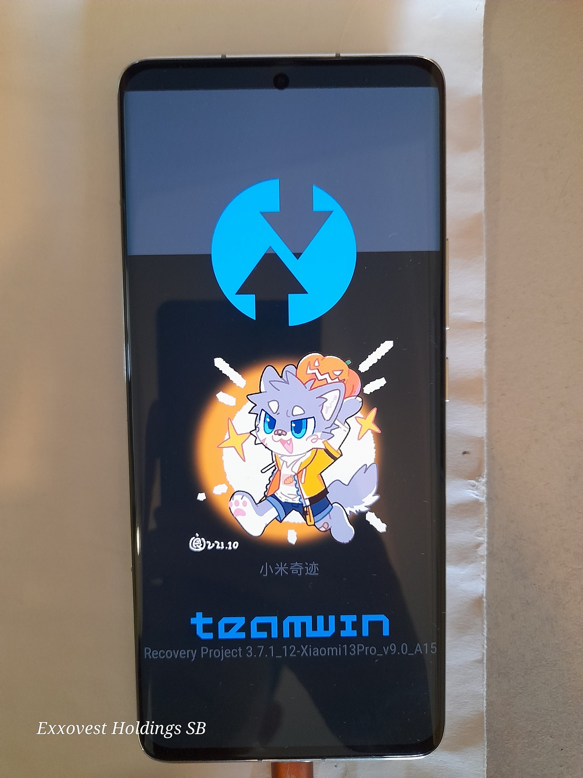

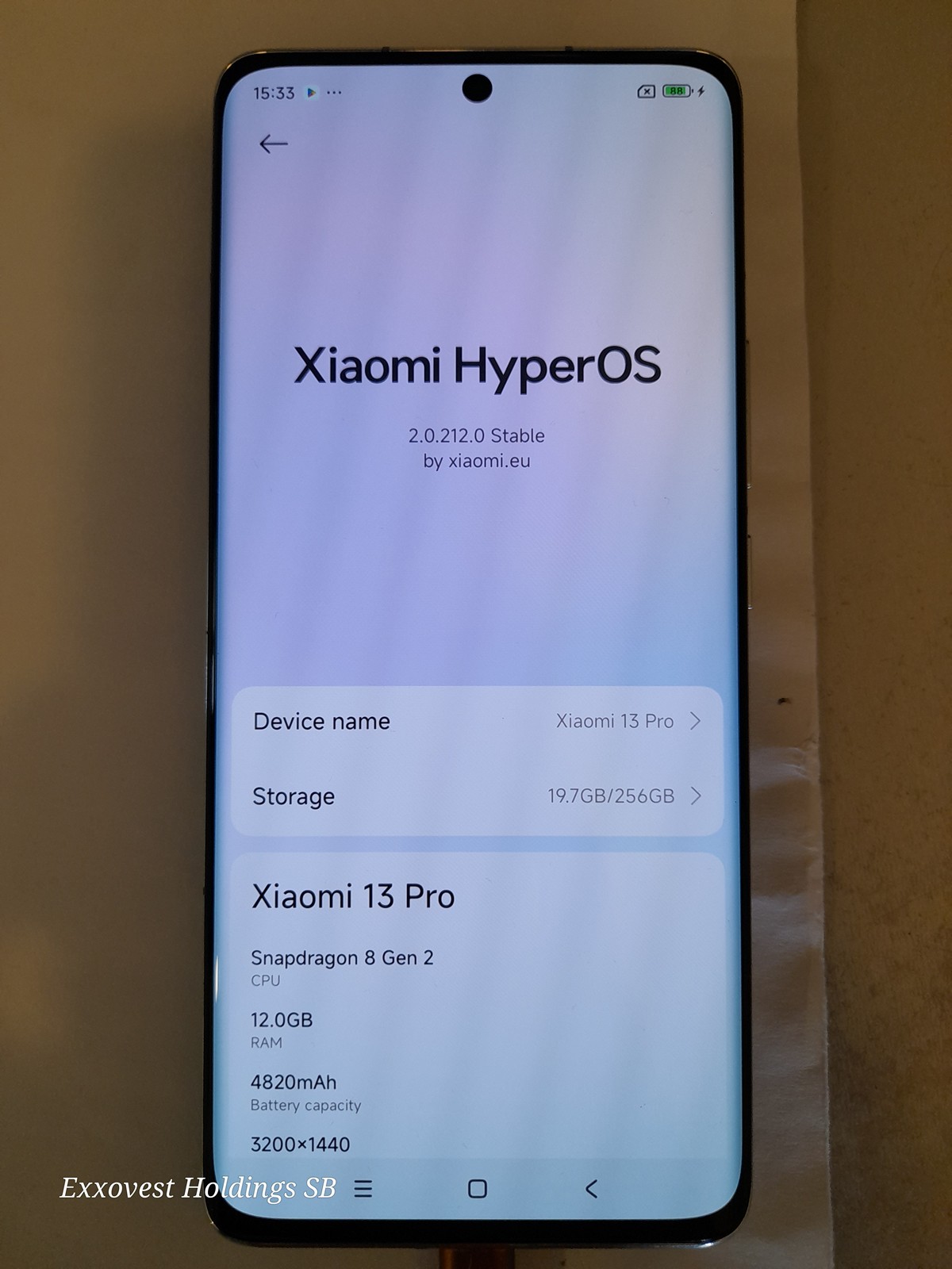

I always faced this issue with most of devices running custom ROM(with Stock UI), which is, it would hang at TWRP after a factory data reset. My phone's model is Xiaomi 13 Pro(but i faced the same issues generally with many other devices).

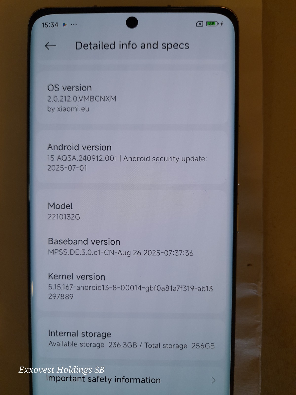

1 - Unit is a Chinese variant Xiaomi 13 Pro, so i wanted to flash it to Global. Bootloader ủnlöcked, installed TWRP.
2 - Installed xiaomi.eu ROM via fastboot, clicked on windows_install_and_format_data.bat file, successfully 100% done without errors, booted into system fine.
3 - the ROM seems like a global official one, with everything works perfectly.

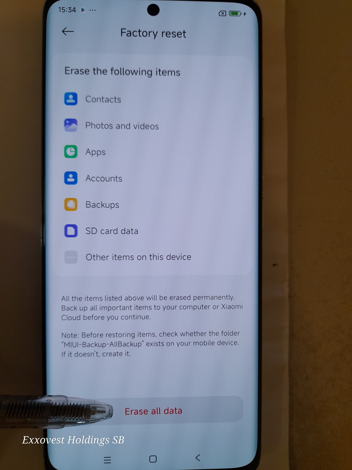

4 - issues is when i try to perform a factory data reset. When i goto settings-additional settings-factory data reset...

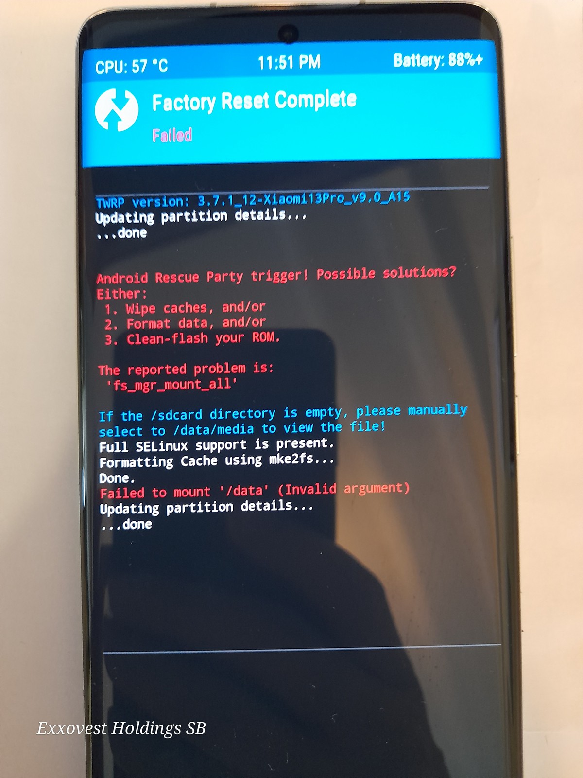

5 - It will then boot into TWRP & won't enter system.
6 - I did tried to do a normal wipe in TWRP
7 - the basic wipe in TWRP resulted with error failed to mount '/data' (Invalid argument), seems like the data partition has some issues, reported 0MB.
8 - following some guides online, i then went to repair file system, set to ext2, then ext4, then the data's partition 256gb appears, but still wont boot into system.
9 - i will have to reflash it by starting from step 2, & it will work again, but i'll nvr able to perform a factory data reset.
Can someone pls guide me on how to properly run my unit with a xiaomi.eu ROM, that would also enable to factory data reset normally?

Try selecting "Advanced wipe" and choosing metadata, data, cache and dalvik cache.
If that doesn't work, you'll have to use the format_data_only script in order to reset.
