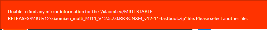

This error message comes up when I try to download Venus 12.5.7 on sourceforge.
I will simply wait and try again tomorrow, but wanted to share it.

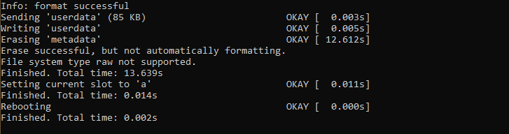

You said that the flash script was closing when the 2 mentioned lines are there. Can you open command prompt and run the script from there? There should be an error there.
C:\platform-tools>adb devices
* daemon not running; starting now at tcp:5037
* daemon started successfully
List of devices attached
dd77da02 device
C:\platform-tools>adb reboot bootloader
C:\platform-tools>windows_fastboot_first_install_with_data_format.bat
You are going to wipe your data and internal storage. It will delete all your fi
les and photos stored on internal storage. Do you agree? (Y/N) y
'findstr' is not recognized as an internal or external command,
operable program or batch file.
C:\platform-tools>
That is the erorr that i am encountering.If i erase the 2 line from the script it works.
