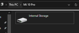

may i know how to solve this problem?i cant mount the storage... and cant copy the zip to the storage, why didt show the storage ?
That's from TWRP or phone's system?
- If TWRP => Reboot to Recovery again... or try another TWRP version. ;)
- If phone's system => You have to allow transfert files on your device via USB (check phone's notifications) or, if you can't allow it, try with another USB cable.
