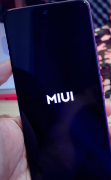

Hello, @ingbrzy
I've followed the steps mentioned here.
Unlocked bootloader;
Installed TWRP and Magisk using XiaoMiToolv2
Uploaded zip to internal storage (xiaomi.eu_multi_MI8_V12.5.1.0.QEACNXM_v12-10.zip) while on the TWRP recovery mode
Installed the zip plus wipped dalvik&cache
Rebooted
But the phone gets stuck on boot - It says "MIUI" and does not go past that.

(grabbed this image from the internet as my phone is corrently not working)
Anyone has any ideias on what I might be doing wrong?
Device: MI8
Previous MIUI install: Official MIUI Global 12.0.2
Thanks.
@GuillermoMR Hello,
( It's a community forum, no need to @staffperson when you need help ;) )
"Format Data" (= "Format Data" button in "Wipe" menu then you have to type 'yes' to confirm) is mandatory when coming from an Official ROM. I don't know why you wipped Dalvik & Cache. ^^
Also, first boot after a Xiaomi.eu ROM installation (first installation or update) is ALWAYS longer than a normal boot. It can take up-to 15 minutes.
Reactions: geoorg and LOLO9393

Thanks for replying, I'm new to all this and was kinda lost.
MIUI is now loading, thank you for the trick. I was using the wipe button that shows immediately after installing the ROM.
You're the best!
