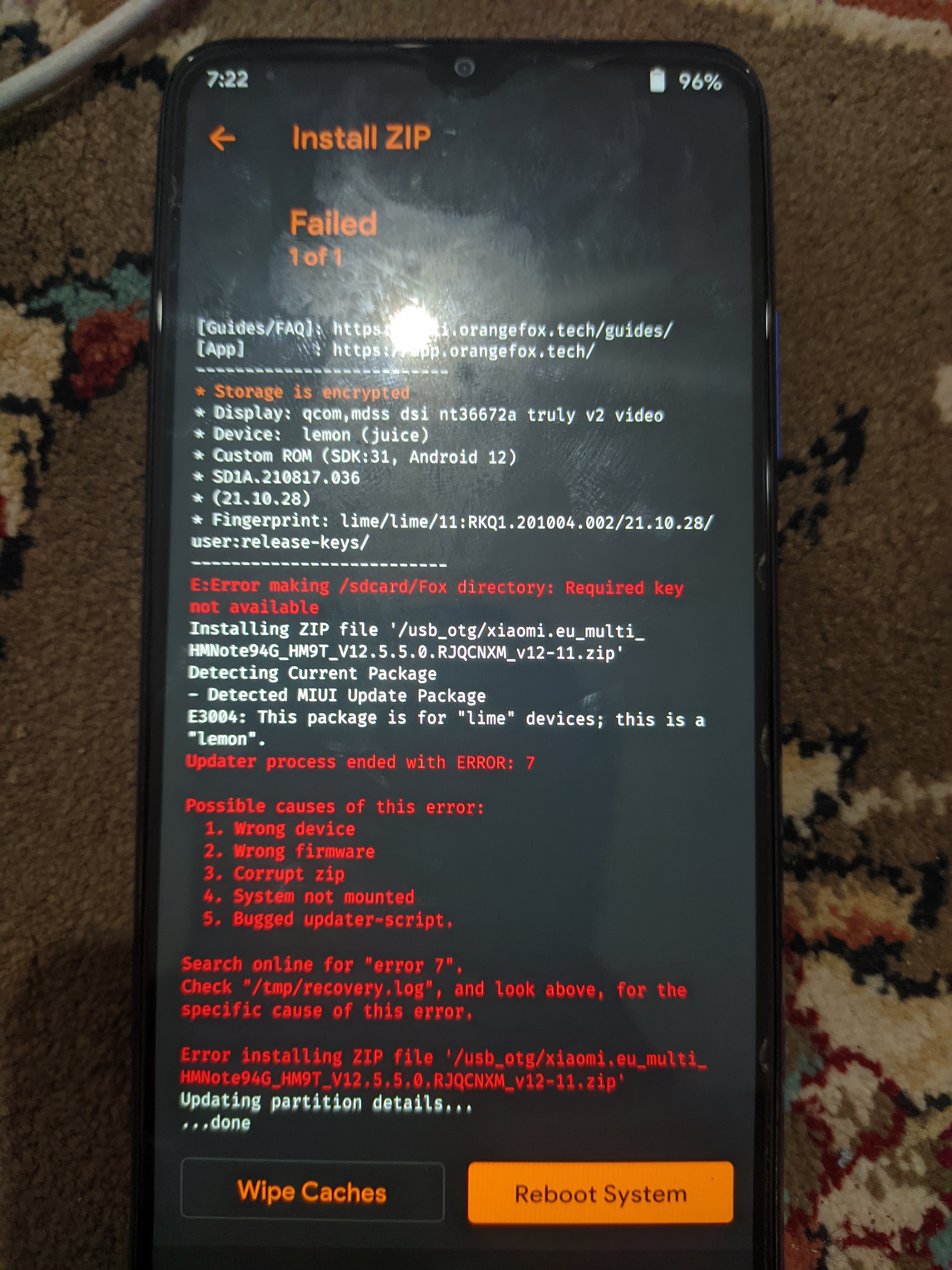

any way to fix this? before trying to install this i was using havoc os a11 and now no matter what i do i keep getting this error (redmi 9t nfc -Lemon)

View attachment 40125any way to fix this? before trying to install this i was using havoc os a11 and now no matter what i do i keep getting this error (redmi 9t nfc -Lemon)
Extract META-INF/com/google/android/updater-script from the ZIP.
Remove the first line that looks like this:
Code:
getprop("ro.product.device") == "lime" || abort("E3004: This package is for \"lime\" devices; this is a \"" + getprop("ro.product.device") + "\".");
Save and import the file back to the ZIP, replacing the original.
