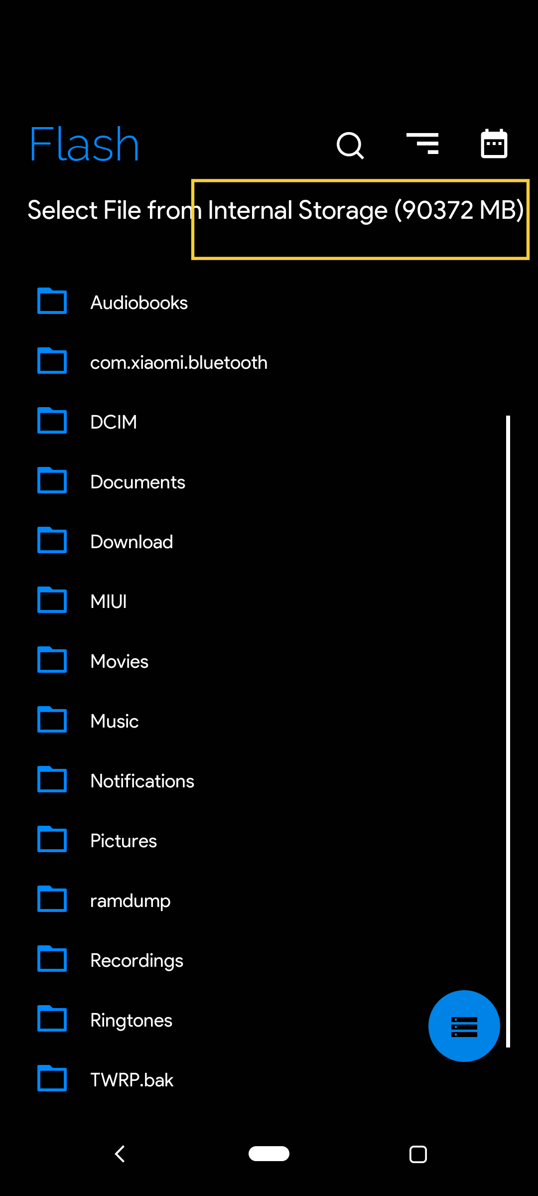

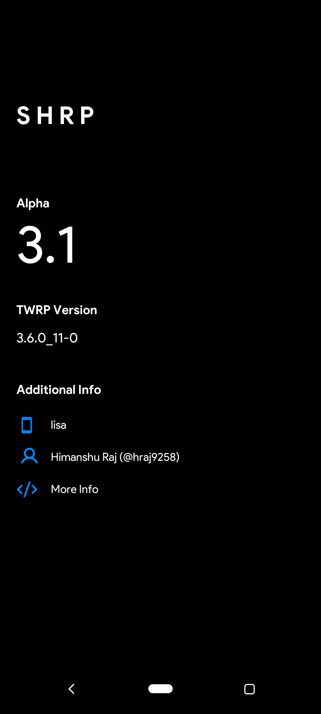

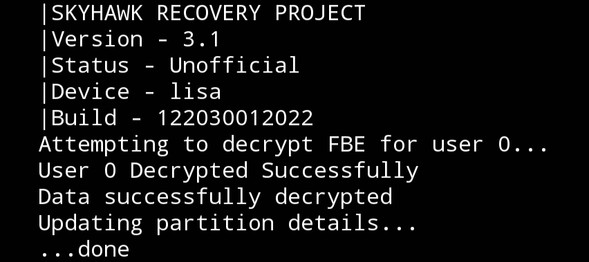

Sorry if OT - an unofficial SHRP 3.1, based on TWRP 3.6.0_11 for Xiaomi 11 Lite 5G NE (Lisa) that properly decrypts and works with Internal memory:
Hopefully, we could have Recovery release for Lisa soon - although there is really no problem to flash the fastboot ROM

Do you have set lockscreen password?
Yes, I do have Android unlock pin. SHRP asked me for and then it worked properly with Data and Internal storage (showing the folders and files, saving its screenshots to the right place, etc)
I tested now also with unlock pattern and it worked, too
Ah ok.. Lisa is on Android 11.. That's why it works for you...
