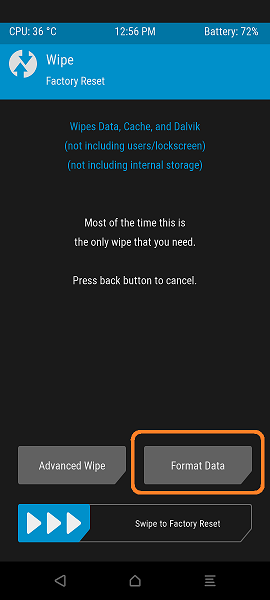

I think I've narrowed my issue down to me!
Its certainly my mistake that's led to my issue, I'm assuming that I messed up my device partitions somehow.
I have been trying to flash/recover the phone via the MiFlash tool and it is becoming a PITA.
I cannot get the drivers to install on Windows 11, even via direct install with Device Manager.
Is there any method to use Mi Recovery tools like MiFlash on Windows 11?
This has me stumped. I can access fastboot, I can flash new ROM and the flashtool confirms that the flash is successful.
However the phone then just enters a bootloop.
I can boot to recovery and flash alternative recovery but.
I cannot get the device to boot
Finally, did it in the wrong order. Format data first and then install ROM. Thanks mate!
Result is the same for:
a) TWRP: Install ROM, TWRP: Format Data, reboot to System
b) TWRP: Format Data, TWRP: Install ROM, reboot to System
But in case (b) you make your life harder because by Formatting Data you also wipe everything from Internal memory hence you must use USB OTG or sideloading or something to provide ROM zip file to TWRP for flashing
In case (a) you simply flash ROM zip file from Internal memory, eg Download folder and then you Format Data (before rebooting to System!)

Format data
Reboot to twrp, connect to your PC and xopy paste the rom on your phone storage.
Just install it and u r ready to go
Format data
You can do that way but no need to complicate:
- have the downloaded ROM on Internal memory (I always download from the mobile hence there is no need to copy the revovery/zip ROM to PC and later from PC to mobile)
- boot to TWRP
- flash the ROM
- stay in the TWRP and Format Data
- then reboot to System
Please understand that Xiaomi.eu ROM does not flash to /Data.
Hence there is nothing wrong if you Format Data AFTER flashing the ROM - but BEFORE rebooting to the System
Hence, no need for having the recovery/zip ROM on the PC and for copying it after formating and before flashing (as you do)
However, you are free to do any way you want
