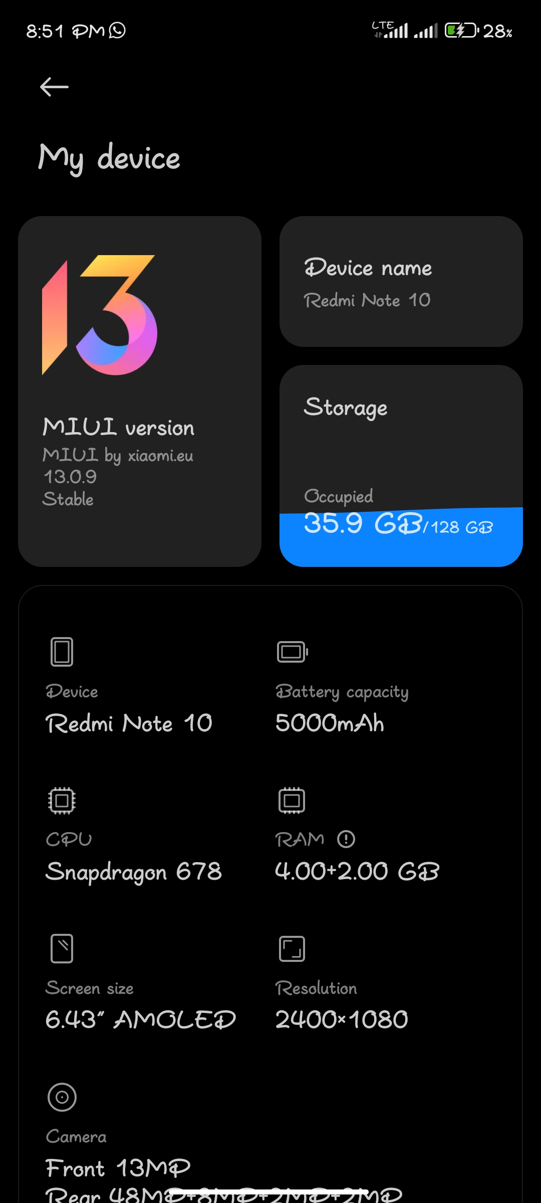

Oh! My bad, I just clicked on the link now. Thank you but I'm still on Android 11, will the TWRP for Android 12 work for me‽
look here…
