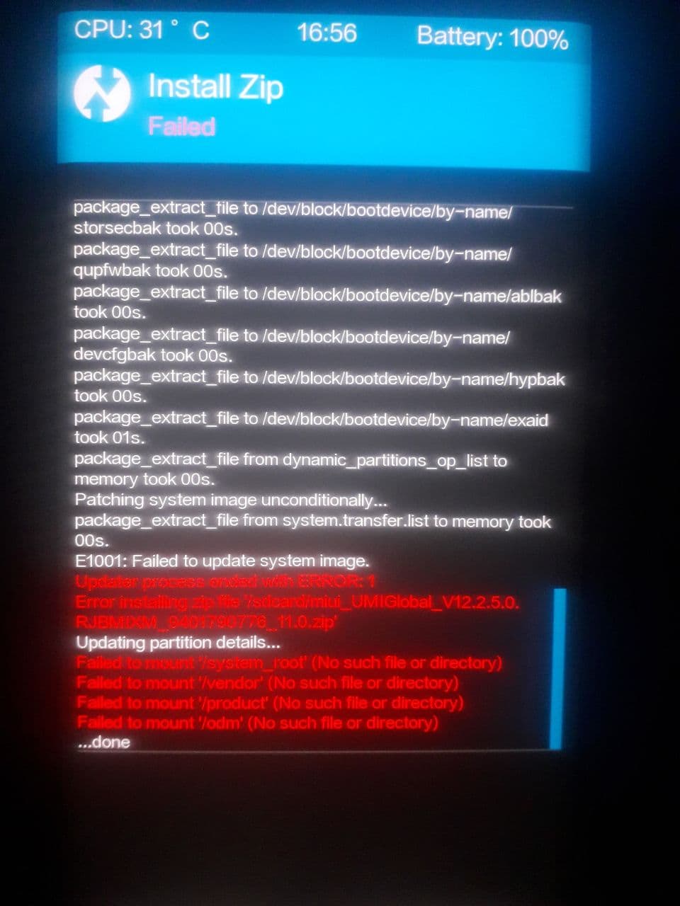

any way to install recovery rom 12.5.10 stable through fastboot for UMI (mi 10)
i am getting an error whenever i try to install any recovery rom (i f****ked up my EFS partition after that getting this error)
unable to mount vendor, product odm (invalid argument)
but i can install any fastboot rom without any problem
i don't want to install miui 13, i don't want to install weekly fastboot android 12 roms

you cant flash fastboot rom with recovery… i am out. no details, no answer…
what do you want? you mentioned fastboot rom install with recovery rom? tell us in detail what you want and what you did. we dont have a glass sphere…
i don't have second device to capture twrp error, but same error like in attached file
sometime it says, invalid "argument", sometime "no such file or directory" for all these 4 super img partitions
system_ext, vendor, product, odm
sometime
system_root, vendor, product, odm
that are no details… why are you so ignorant? you want help and it is up to you…
