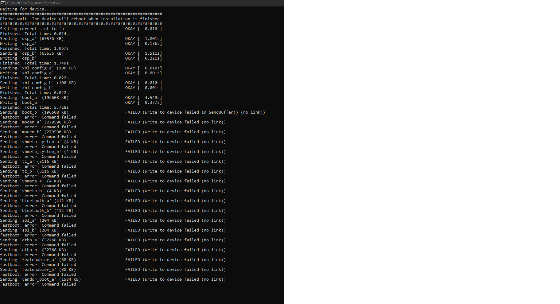

tried to update from the 12 to 13 but fails, i have a poco f3 and bootloader unlocked, im running miui 12 eu rom, installation failed and the cmd screen disappeared, now i cant turn back on the phone
looks like you bricked your phone.Can you boot in fastboot mode?

nothing, doesnt show charge, doesnt turn on at all. i took it to a repair shop and the tech told me he tried some things but is not doing anything i gave up with it
You can do 2 things:1-if you can see your device in device manager as qualcomm 9008 device you can try to pay a telegram guy to remotely flash rom via edl mode.
2-send your device to a authorized Xiaomi service.You will have to pay 20-30€.

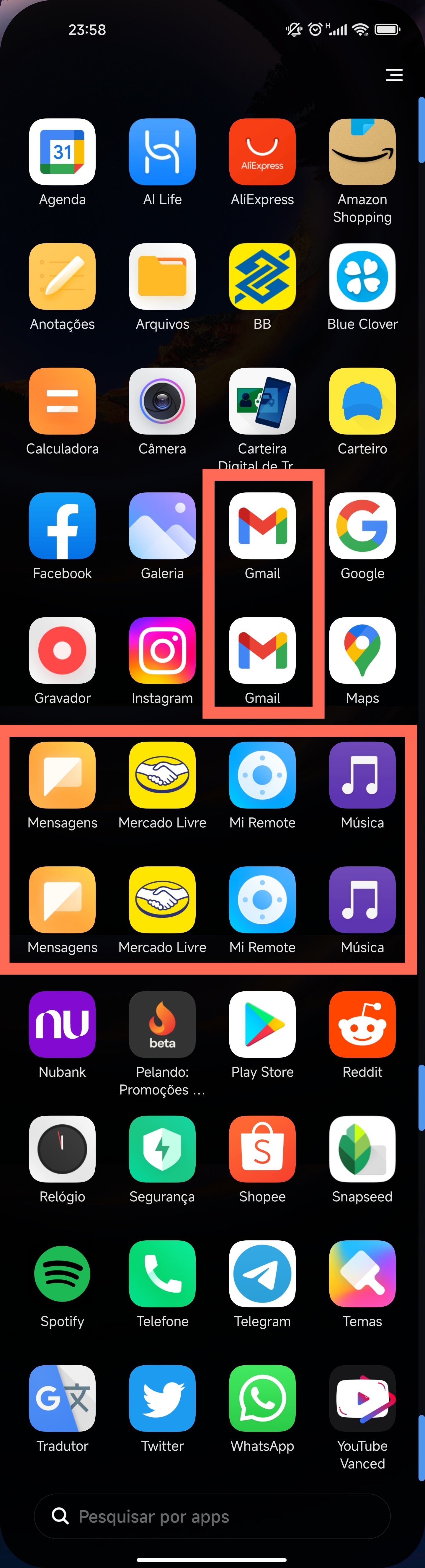

Alright so how do we prevent this annoying bug from happening? I get duplicated app icons on my mi 11 running the latest MIUI.eu 13.
Not only that but some icons will disappear (like the settings app is nowhere to be found)and my home screen gets messed up every time I reboot the phone.
Maybe you should reset the launcher app by deleting its data and stopping it.
