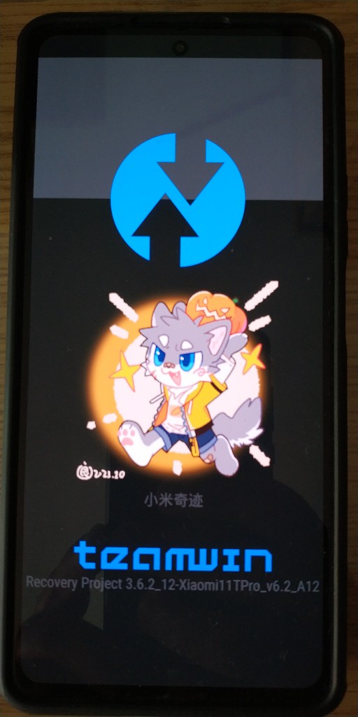

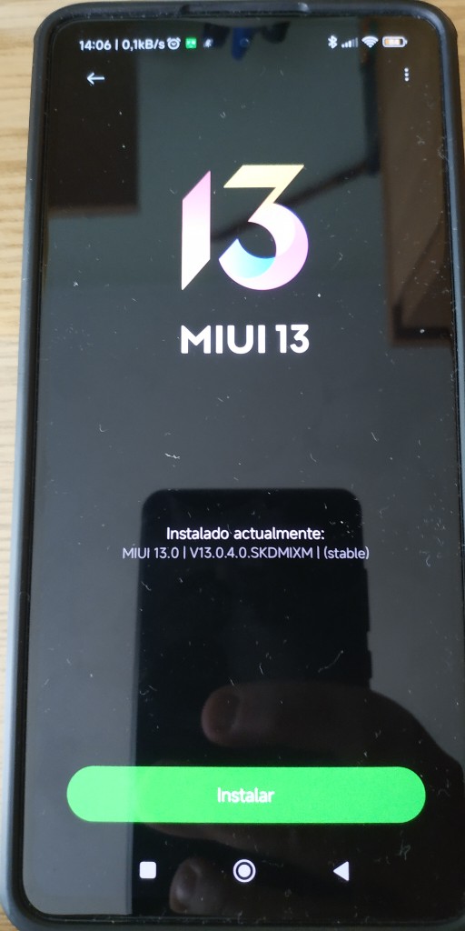

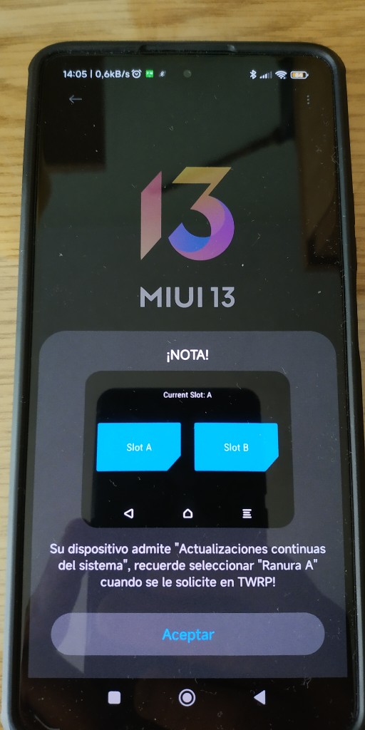

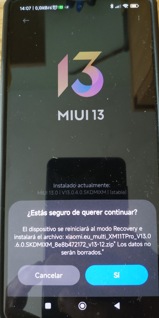

Hello good evening, I have a question and I don't want to damage the phone, I installed the TWRP 3.6.2_12 Xiaomi 11 T Pro_v6.2_A12 recovery and it went well, I also installed the EU 13.0.4.0 rom for the xiaomi 11T Pro by fastboot and all good, I have all the applications and the phone working and a few days later I got an OTA update, v13.0.6.0 SKDMIXM, only when I go to update it gives me a warning to select slot A, I don't know what that is. My question is, can I update without problems through recovery or can it give me errors? As it says in the first post that recovery does not update because it does not work for the xiaomi 11T Pro... Thank you.
you can… everything is described here…
