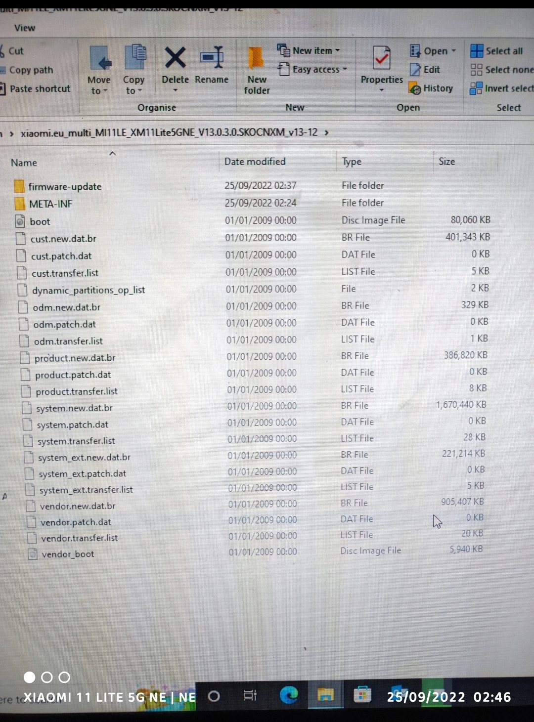

Iam using mi 11 lite 5g NE, successfully managed to flash eu rom v13.0.1.0 and received an OTA update of v13.0.3.0. l downloaded the zip file and extracted it hoping to find a update command but lam atuck now because l can't even understand or knw wat to do. I have attached the image with the extracted file. Please help me wat to do

There is no doubt about installing the ROM: If it's a fastboot.zip, then unzip and install by command, if it's a .zip then install by recovery (unofficial TWRP/OF). Answers are already given multiple times. This is not a chat but a forum. So please don't spam here and search for how-to's. Thank you.

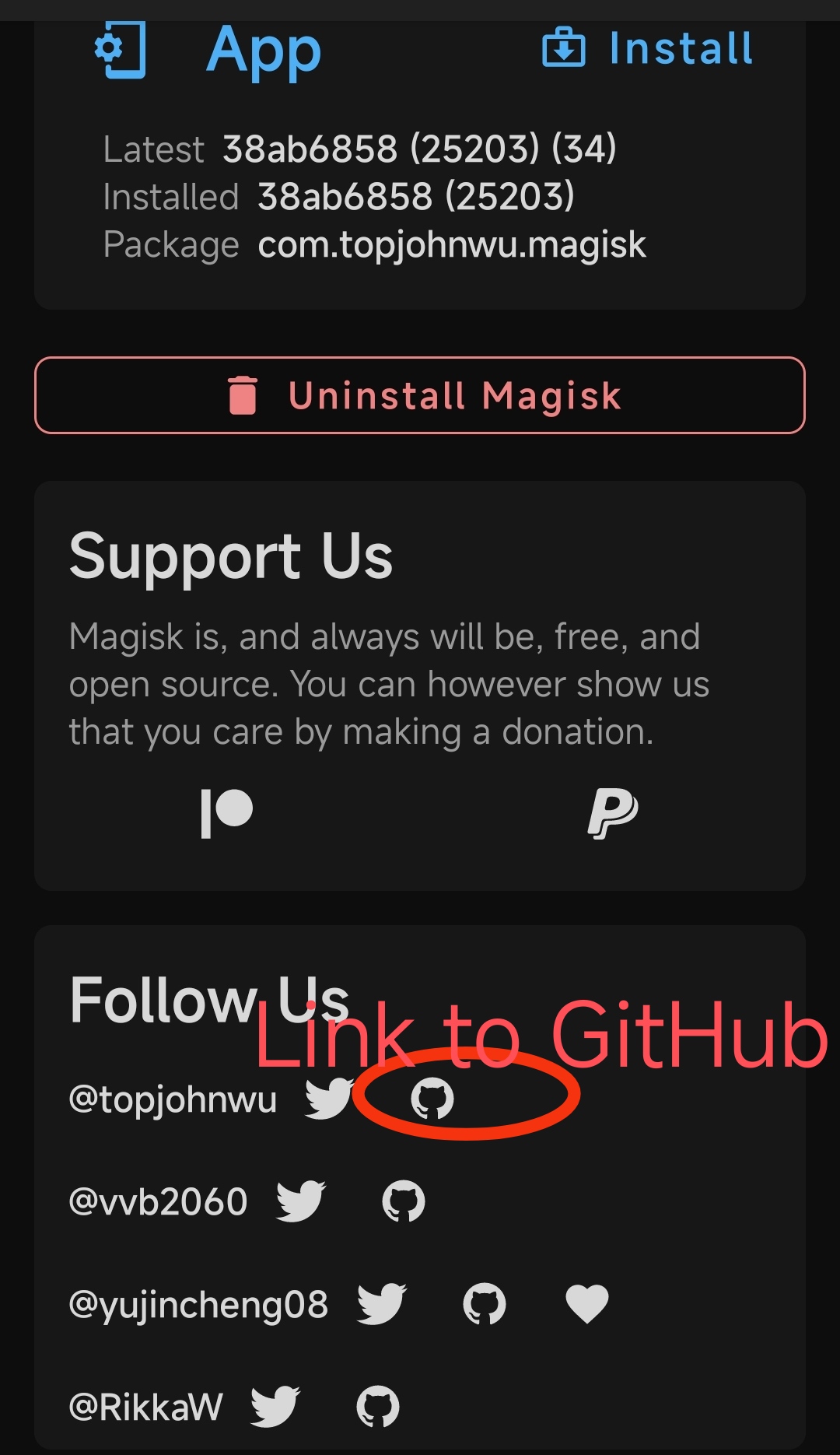

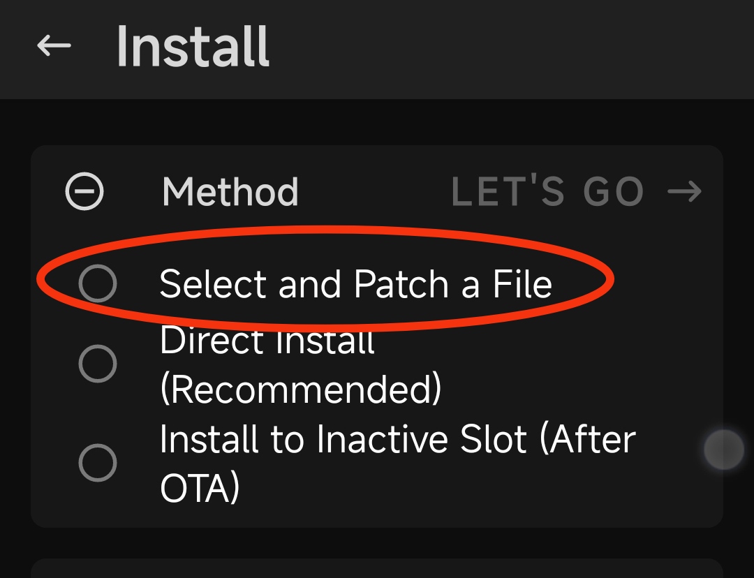

TWRP is NOT MANDATORY, not even needed to install Magisk
Although Magisk CAN be installed through TWRP (IF TWRP is available for the particular phone), by the Magisk Installation guide (available on Magisk Github- so many users use Magisk but do not date to ever open and read?!), the RECOMMENDED method (exactly because of the problem with custom recoveries for the new Android versions and new devices) to install Magisk is patching the boot.img and flashing
Hence:
- unzip Xiaomi.eu installation for your phone and extract boot.img file
- install Magisk APPLICATION, download from Magisk GitHub:
- by installing Magisk app, you are not rooted yet but you have the option to Install Magisk
- Take select and patch a file, navigate to and select your extracted boot.img, press Let's go
- Do not enable Recovery option (if it would be offered)
- Find the patched boot img file in Download folder, copy to PC, to your ADB/Fastboot folder
- Flash by:
fastboot flash boot <patched boot img>
Boot img must be from the actual Xiaomi.eu version you are running.
Upon updating Xiaomi.eu, you will need to repeat the patch and flash with the new boot.img
Btw, there is a guide and posts about here on XDA, about all this
