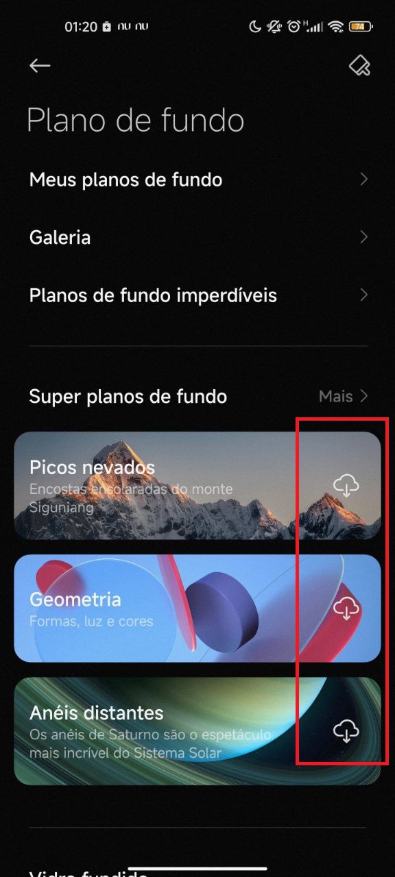

help, tapping these icons doesnt download the super wallpapers at all... mi 11 13.0.9.
You can't download them this way, they were supposed to be already installed, unless first boot was interrupted somehow.
You can install all of them manually:

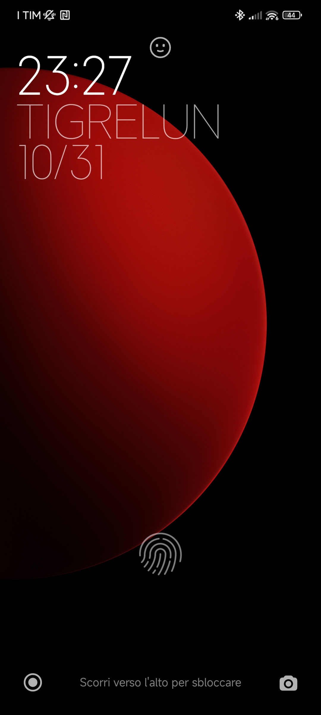

Mi 12S ultra After the last update, in the lock screen it shows me this writing instead of the day of the week ... I updated as always from recovery

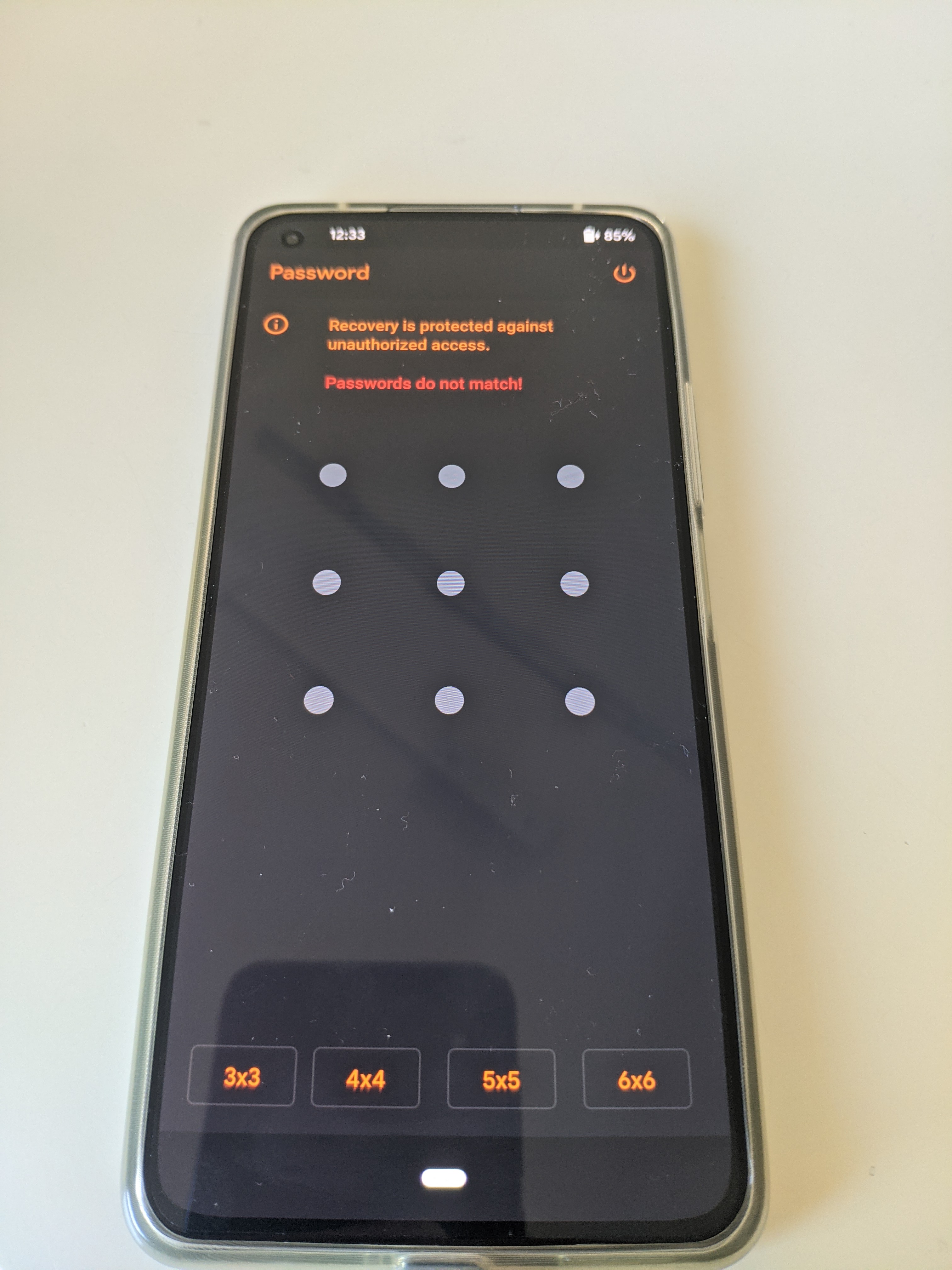

Hello, I did follow you're instructions but when I enter de pin it opens of recovery but asks for pattern also. And I only have pin. It says 'recovery is protected against unauthorized acces' I'm stuck again. What next?

I have tried to find in the forum someone with the same problem but could not find it. Do you have a solution for me?
Go to Android and play with screen unlock - change pin and/or switch to pattern or remove and try again in OrangeFox
I never had that problem, but try as above
PS: Factory reset may also help. Or copy Xiaomi.eu zip to an OTG stick and install from the OTG - OR would not need decryption, but Factory reset then to fix your problem for future

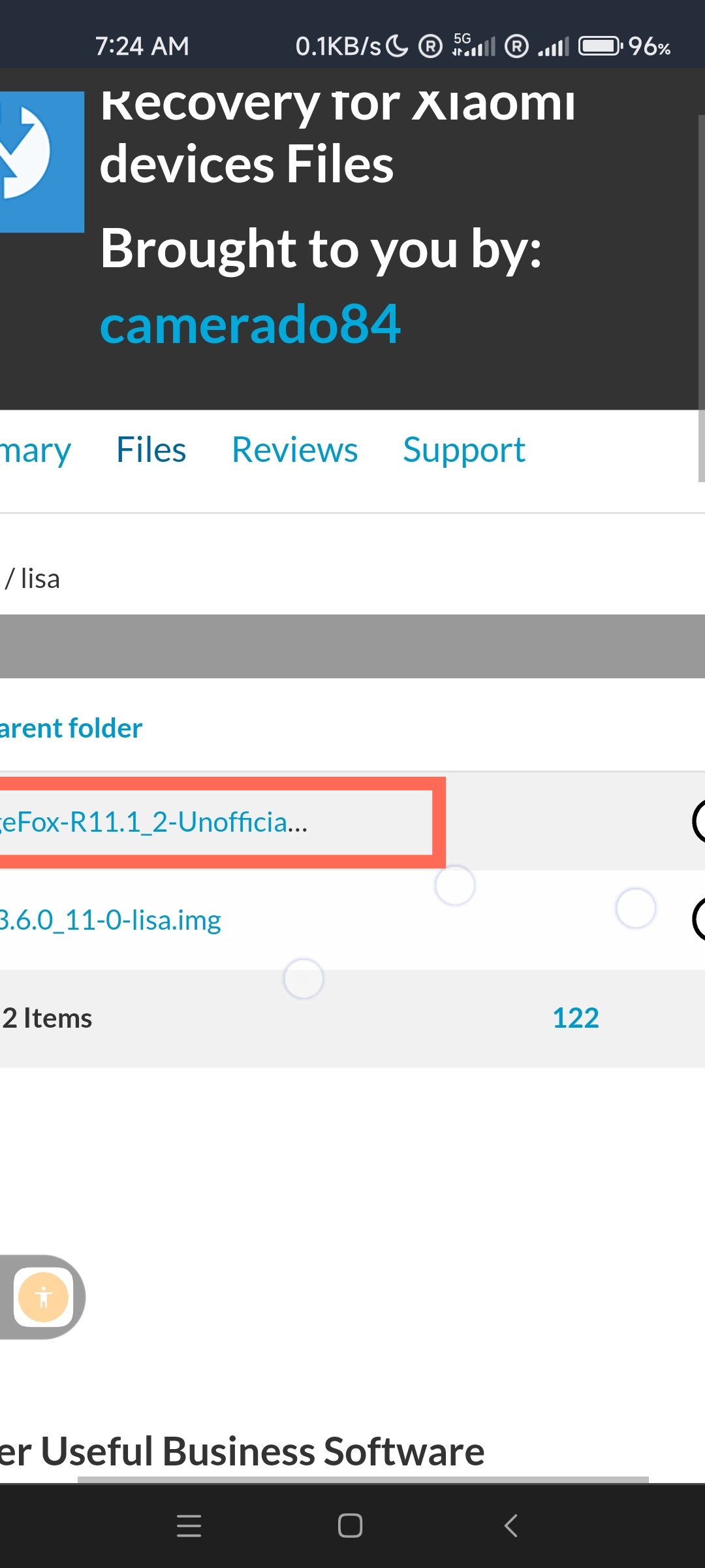

hi it seems that you are using orangefox please tell us the filename of it. in of its possible to set a password… so that you can use it only if you have the correct password. it is not the pw from your phone only if you have configured the same. did you set a password/pattern in orangefox?
it would be helpful if you decribe in detail what you did
hi, i am using OrangeFox-R11.1_2-Unofficial-lisa for the first time. i only set pincode for the phone. when i boot of it ask pincode but when it try to decrypt and enter recovery it asks for "recovery is protected against unauthorized acces. to use main recovery features you first need to draw your gesture key"

Hi, I tried removing screen lock, changing pattern, changing pincode, add fingerprint and even a factory reset in stock recovery. Nothing helpt. I don't know what else to do. I am using the Orangefox-R11.1_2-Unofficial-lisa like you discribed. Is this the right one? Can't I use a TWRP version.
One TWRP version gave me black screen when entered fastboot boot.img. This is really crazy

It's not crazy because TWRP does not support A12 yet (go to the officialTWRP.me and read there). And I don't know any TWRP for Lisa that works with EMUI 13/A12
Only this OrangeFox
The message you are quoting is not a about Sndroid screen protecton.
As you have stated in couple of your posts, you tried to install wrong custom recoveries (that do not properly support MIUI 13/A12), resulting with rebooting to fastboot, black screen, etc
Most likely, you messed something. Users who correctly used only this OF, installing the proper way, did not report anything similar

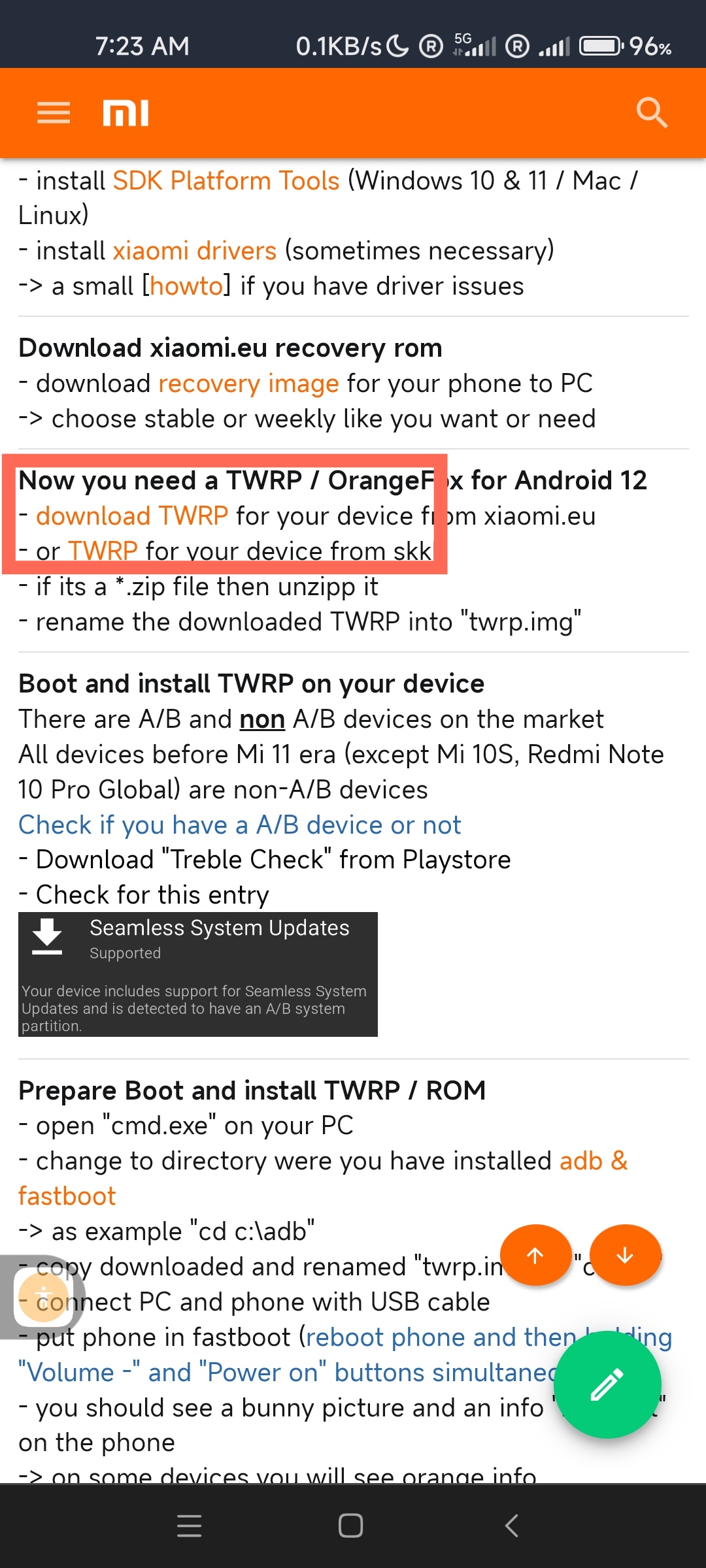

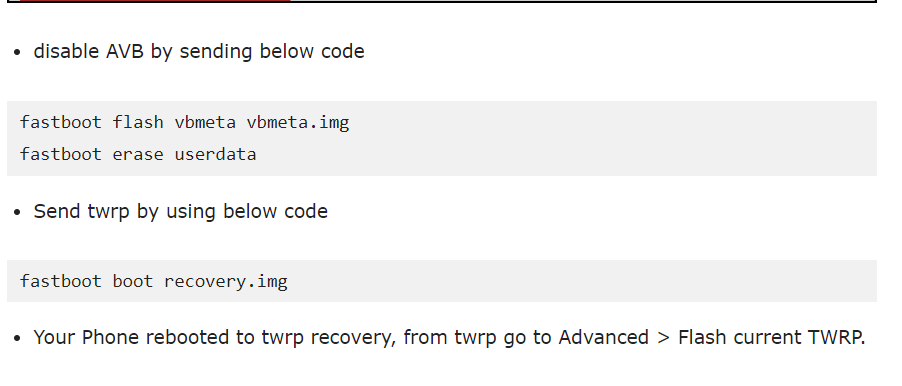

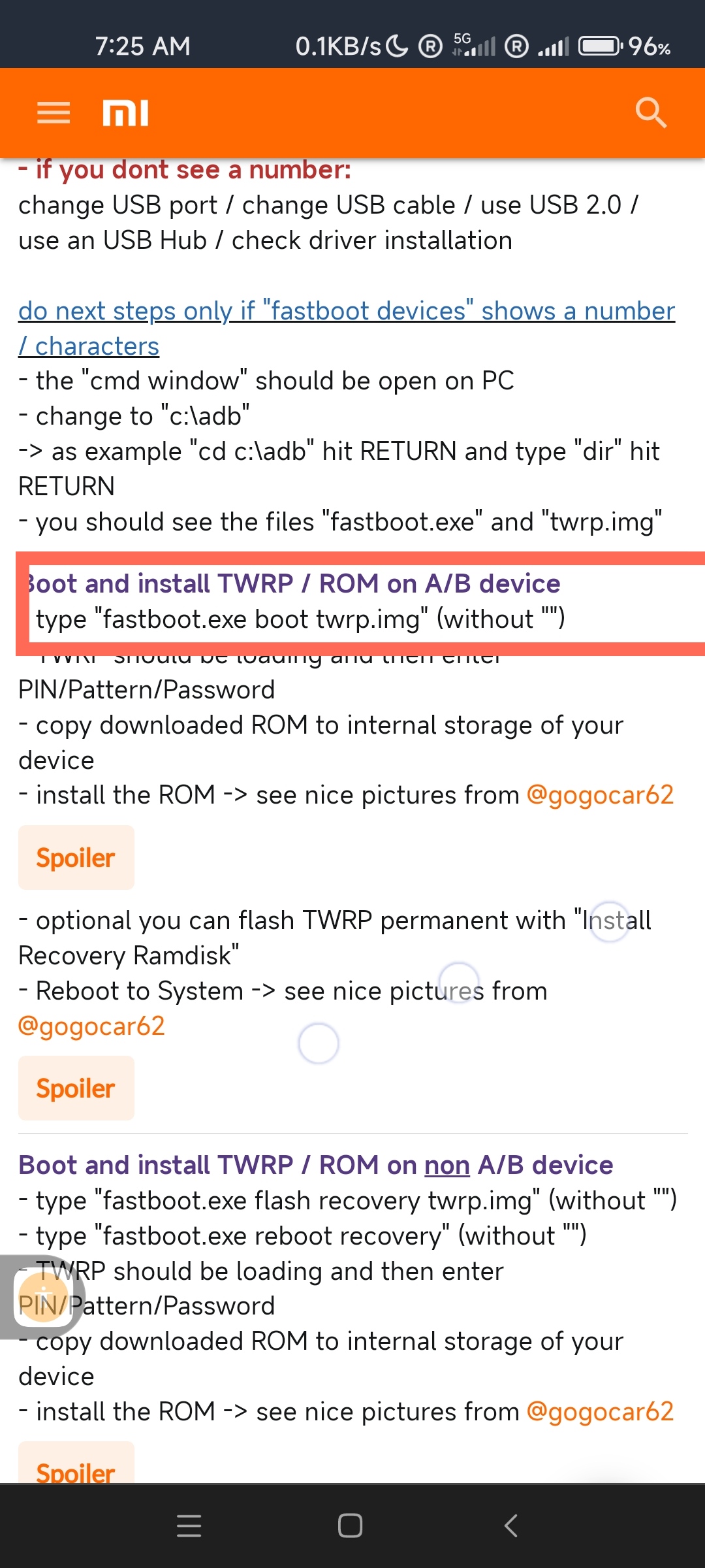

Hi, so I have a few questions about Xiaomi 12T Pro (ditting), after I unlock the bootloader, to install Xiaomi.eu rom I use ADB fastboot tool to push fastboot ROM without installing TWRP, but when the recovery rom will come out do I need to install TWRP.
There is a SKKK version of TWRP, and if I want to push it via fastboot do I have to install vmbeta.img before TWRP?
(I will not root my phone or install magisk, only twrp for installing xiaomi.eu roms in future)
That is the instruction for installing unofficial twrp.
